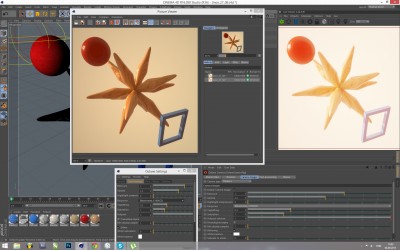

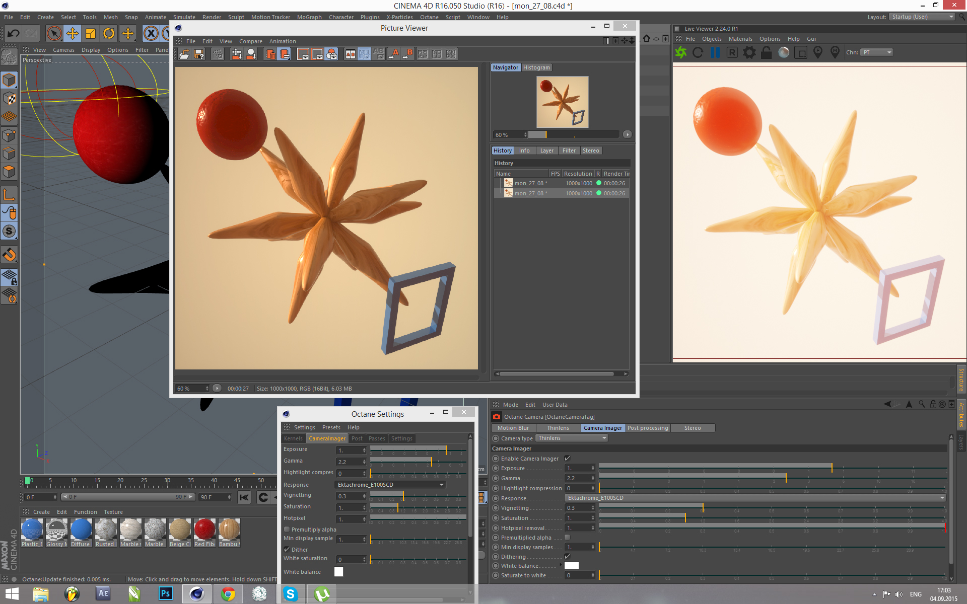

Problem is:
I got project - with octane camera on it - in tab Camera Imager - i've selected one of the presets - result is good. But when i am rendering it out - it still rendering like ordinary linear image response.
So what i want to see is the camera imager preset tweeks on the final render result.
I've got float buffer and linear output in render settings - got the same options in camera imager on octane camera response and same options in camera imager in octane settings (see pic. gamma 2.2, output - e100sCD)
But this two results are complitely different.
I can do the same picture in LV and final render - but it's only works when i am choosing LINEAR output on camera... and i want to use camera imager presets still =)
Posts: 16068
Location: Türkiye
Yes you have got the correct point. Because "floatbuffer" is linear(raw) output of rendered image. No any tonemapping. Gamma=1. Everything is as rendering without applying any color effect.
That's the why we put "floatbuffer" and "floatbuffer(tonemapped)" options. Tonemapping is a operation over linear colors to change. Clear enough?
