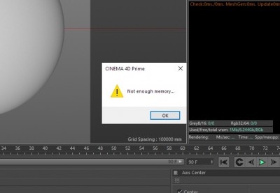

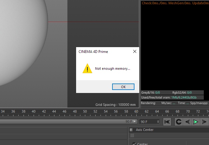

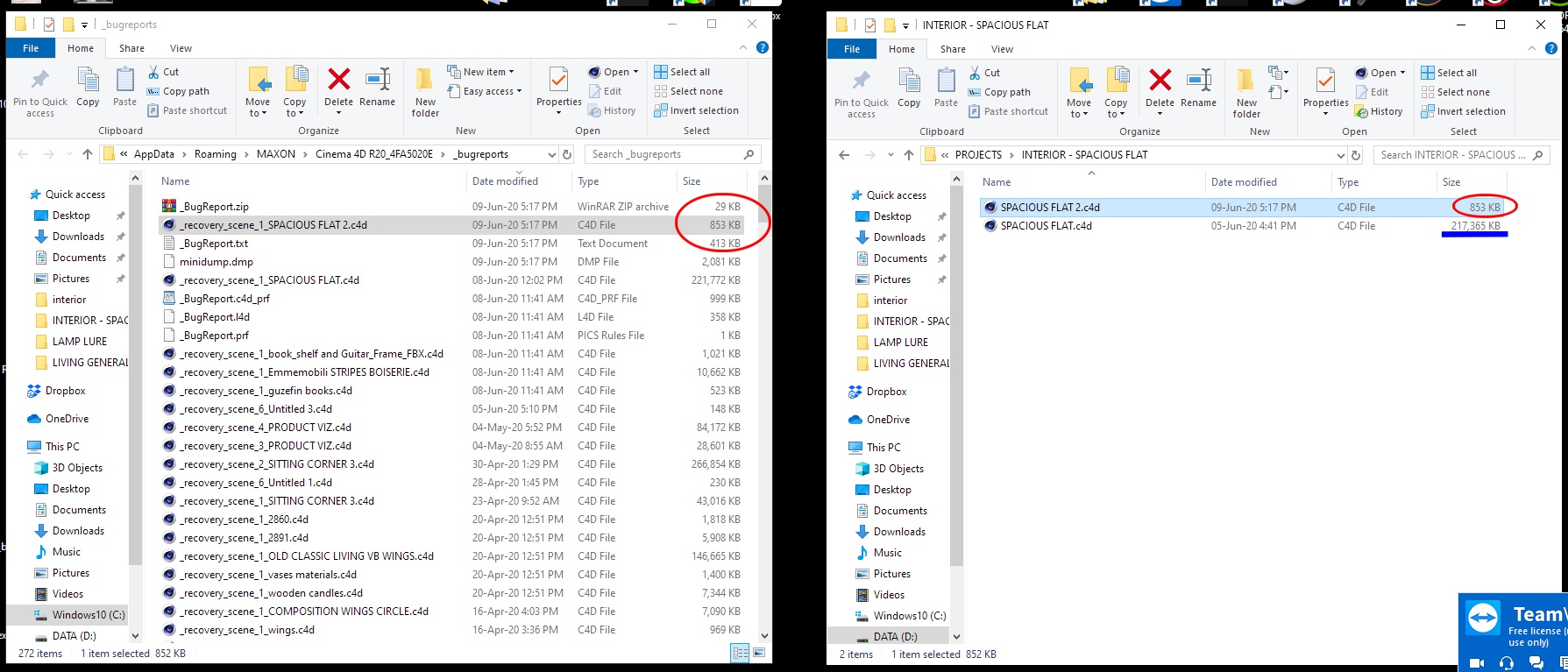

Hello, A file got literally destroyed after 1 day of work on it, just when launching the second render.
The file was the second version of an interior, this 2nd version has been developed in 1 day from the version 1. During the day I saved multiple times this 2nd version, always overwriting the same file.
At the end of the day, when launching the renders, the 1st one went pretty fine, and before saving it, I launched the 2nd render, which made crashing c4d, and automatically saving the file in bugreports folder.
The problem is that both files, the original and the one in bugreports got a size reduction from around 250 mb to less than 1 mb. Both files! If I try to open them, it says "Not enough memory..."
So now I have to remake all the job again.
Destroyed file when sending the render

Yes! Same thing happened to me, a couple of different times. Seemed like that during the saving process Octane somehow crashed C4D and the resulting file was partially saved - hence being 1mb instead of 100 mb.Gipya wrote:A - Windows 10 with latest updates in date before the 9th / 6 / 2020
