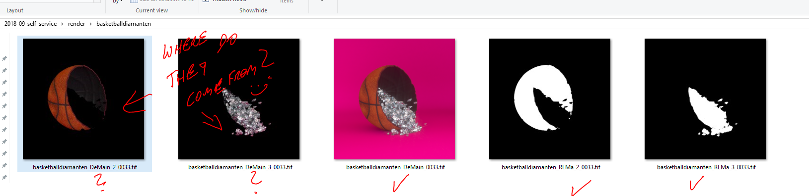

When using the A.I. Denoise and rendering passes to single TIFFs it saves unwanted extra Renderings where it applies the activated Layermasks. So I get the Denoise Beauty, the Layermask and everything as it should, but also an extra A.I. Denoise Pass with the mask applied to it.
Here is an example of the rendered files, where I used layermasks for 2 objects:

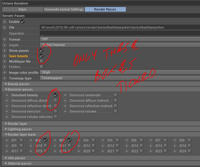

Here are the Rendersettings:
Its not a huge deal, but saving these unwanted extra images for every Frame seems unnecessary and also takes quite some time if you render out a few hundred frames.
Maybe I am missing something, but it only seems to do that for the the A.I Denoiser.
Just thought I let you know.

please, disable the old Render Layer mask passes, and try with the Object Layer Color pass:
viewtopic.php?f=9&t=62462&p=319218&hili ... or#p319218
In this way the mask passes are calucated during render, saving you a lot of time. The old Render Layer masks are calculated via c4d, and this takes more time.

Have the same problem. The Object Layer Color pass is not something i prefer (not so nice edges). Is there a solution to just skip the "bonus" passes and keep black and white layer masks and denoised beauty pass? Thanks!
Posts: 16068
Location: Türkiye
It's known problem since some time. I'm looking to solve it!

Posts: 16068
Location: Türkiye
roaldvdmeer wrote:Ah nice! Thanks for the quick reply Ahmet!
I found the reason why It's here! And fixed for 4.01.
