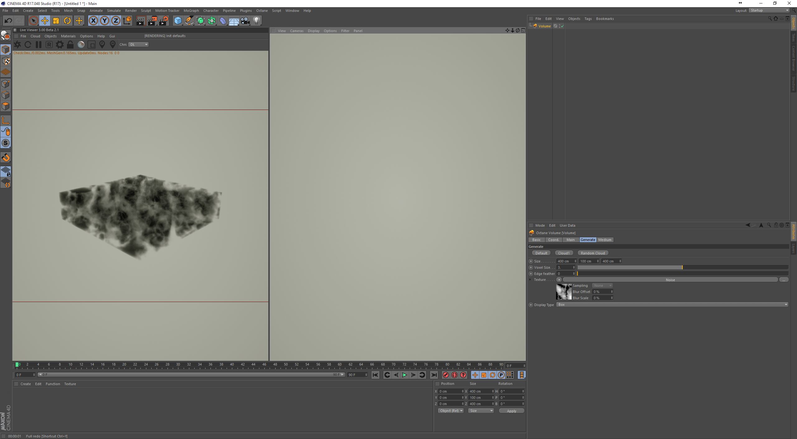

The volumes in octane3 won't render in the picture viewer as well as the view.
Using windows 10 but also tried it on my macbook pro with the same bug.
NVIDIA GeForce GTX TITAN X
NVIDIA GeForce GTX 670
32GB RAM
Nvidia driver version 353.90
OctaneRender 3.00_alpha_1
C4Doctane 3.00 Beta 2.1
Both c4d r16 and c4d r17
Volume not rendering in the picture viewer

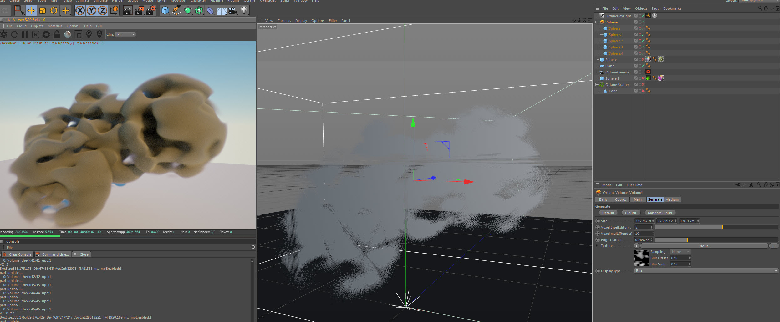

Ahmet will be able to give proper support but it works for me without blanking out the viewport panels:
My drivers are a bit newer, so might want to update yours to test. You also may want to watch out that you're not running out of VRAM since volumes can be quite heavy.

Thanks for the reply. It's not the live viewer I am referring to but the picture viewer and rendering the viewport. The liveviewer is the one that does work and shows the volume but I can't render volumes using c4d's output.
I see, interestingly, the scene I had open rendered in the PV and Viewport Renders fine but then I started again and got the issue you reported where it doesn't load up at all in the viewport - it did however load up in the Picture viewer:mayonnaise wrote:Thanks for the reply. It's not the live viewer I am referring to but the picture viewer and rendering the viewport. The liveviewer is the one that does work and shows the volume but I can't render volumes using c4d's output.
and after I'd sent it to the PV it rendered in the viewport - really weird and I'd say confirmed

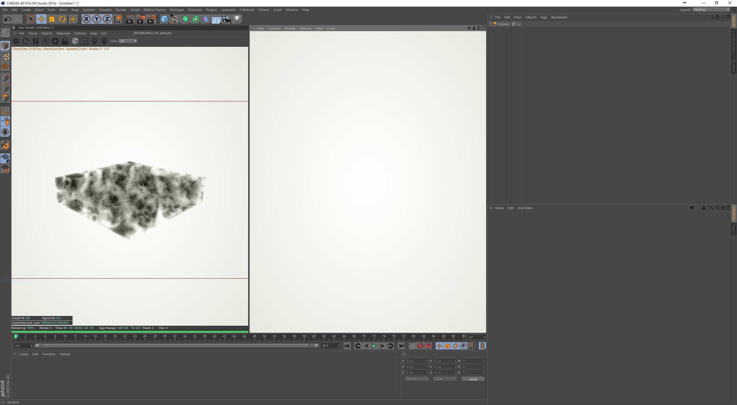

I have tested it. I think it's happening just in rendering to viewport. It's not very very big problem. I'll try to fix it.

I have the same error now. Octane Fog Volume renders in Live Viewer, but not in Render View nor Picture Viewer.
I tried the newest beta and also rolling back to 3.0 stable. Updated the Nvidia drivers too. TurbulenceFD with object tag works ok. Are there any workarounds?
