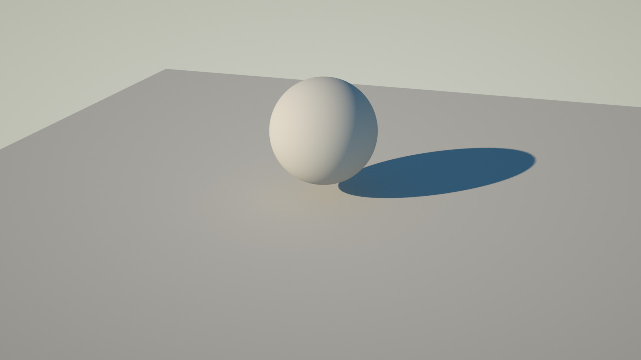

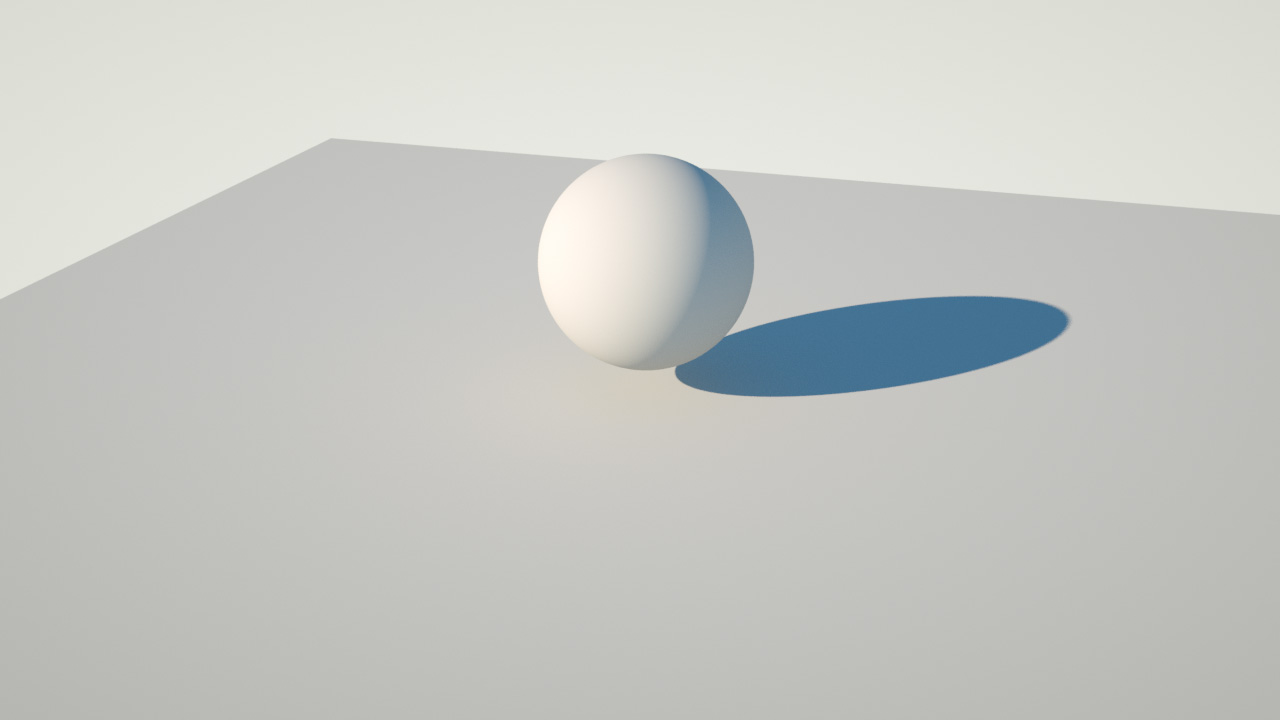

C4D version: 16.050
octane version: 2.24.1 (R3)
OS: win7
hardware: testet on several PCs with different cards (gtx 780ti and gtx980ti)
also testet with c4d R17.032
i made a simple testscene: 2 objects and a sun.
when i render this with commandline (-nogui) the image is darker than the image when i render it with normal c4d gui version.
this happens only when i use the camera imager option in the OctaneCameraTag. when i dont use the camera imager, there is no difference if i render with c4d or start the render with c4d -nogui.
this is how i startet the testrender:
"C:\Program Files\MAXON\CINEMA 4D R16_clean\CINEMA 4D.exe" -nogui -render "C:\test\commandline_test18.c4d" -frame 0 0 1 -oimage "C:\test\commandline_test18_nogui.tif"
2.24.1 (R3) commandline renders darker [FIXED]

It's related with a bug in version checking. Somewhat it reads wrong version numbers when you launch from command line and It modifies camera imager gamma value to adopt for old system.
Please test it with this:
https://render.otoy.com/customerdownloa ... T5-win.zip
Please use this. Arealights was corrupt on other version.

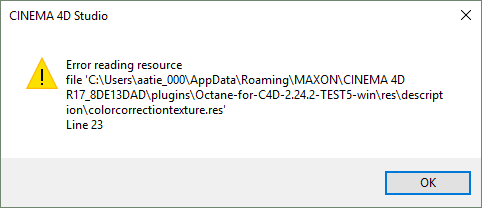

There's a problem with the color correction node:
- Attachments
- CC error.PNG (6.84 KiB) Viewed 6266 times
Have a nice day!
Achim
Aixsponza
Achim
Aixsponza
Please replace with this. I'll make a release after some work.Augustronic wrote:There's a problem with the color correction node:
- Attachments
- ColorCorrectionTexture.zip
- (475 Bytes) Downloaded 298 times
