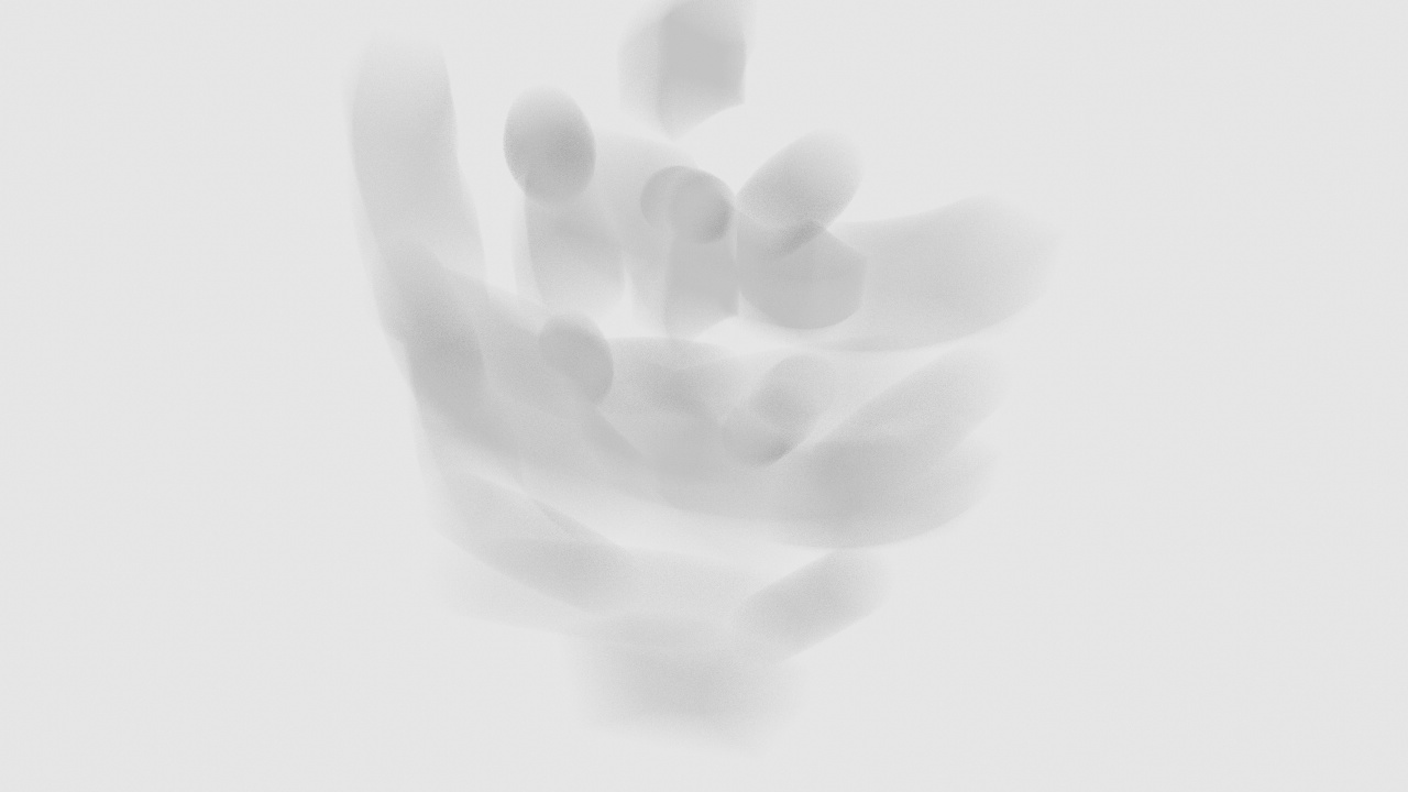

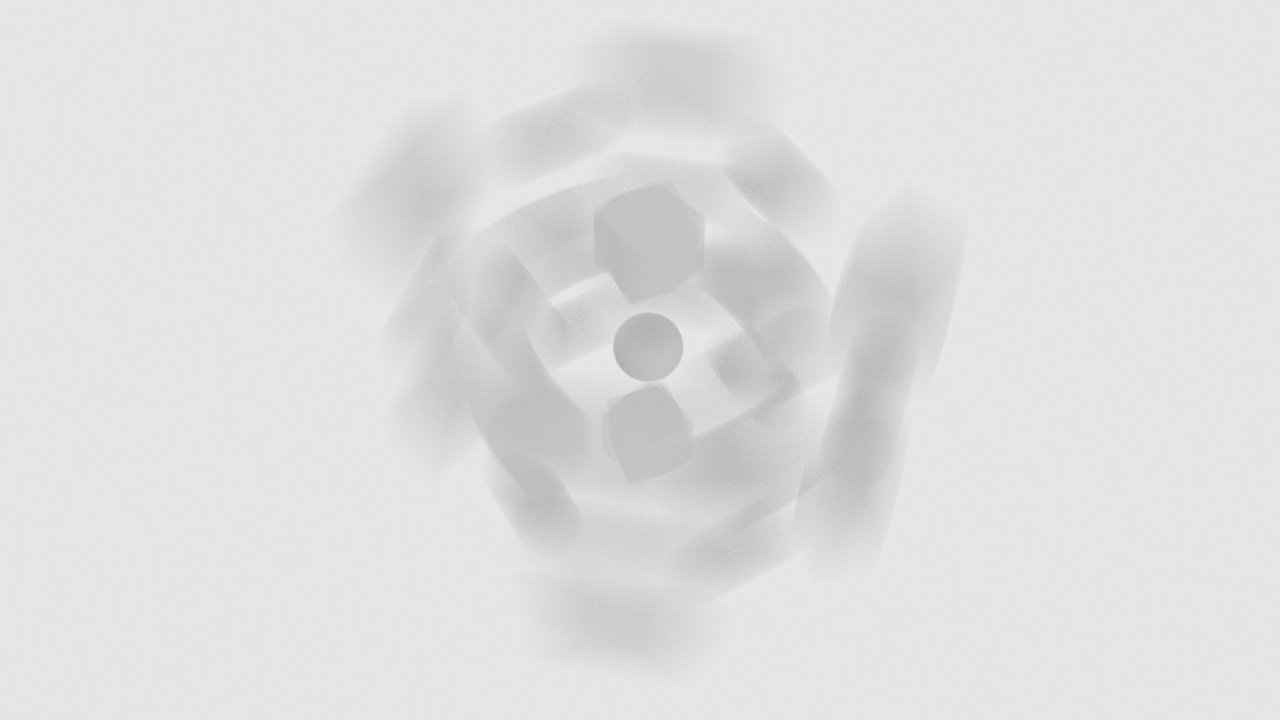

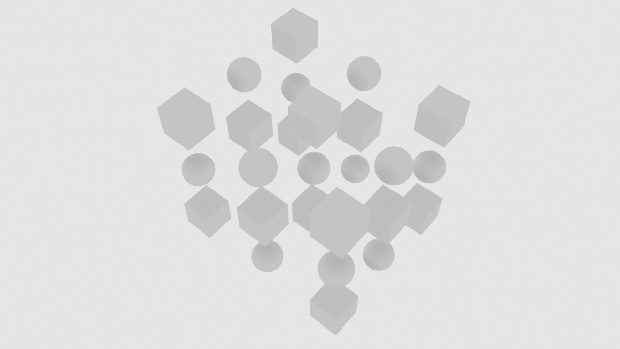

I'm having issues with motion blur on clones with 4.00 stable build in r19 and r20.
To illustrate the issue, I made a simple grid cloner (3x3x3) and rotated it on one axis to make it spin from the center. I created an octane camera with motion blur turned on. The following images are the results of this:
This is the result after setting the scene up as i said before - just simply turning on octane. No motion blur at all.
This is the result when I simply apply an octane object tag to the cloner - motion blur looks correct all working fine here.
This is the result when I turn on render instances (octane object tag still applied) - the motion blur looks incorrect - almost as if the rotation pivot was offset somewhere else. Very strange.

docphibs wrote:I'm having issues with motion blur on clones with 4.00 stable build in r19 and r20.
The attachment NO OCTANE OBJECT TAG.jpg is no longer available
The attachment render instances OFF.jpg is no longer available
The attachment render instances ON.jpg is no longer available
In r20, when you use multi instances there's again a result of no motion blur whatsoever.
I should also say - that after each test - I was reloading the whole scene into octane again. Not just letting the live viewer update on its own without a full refresh / re-upload to the viewer.
There something Im missing here? Pretty big issue to not be able to check on render instances and motion blur not work. Keeps our scenes nice and light. Hopefully it's something simple I'm unaware of. From what I can tell everything has been installed correctly according to the forum posts. I should also say this definitely works in 3.08.
Thanks in advance for any help!
It's same on non-stable. It's a very complicated problem to solve with renderinstances.

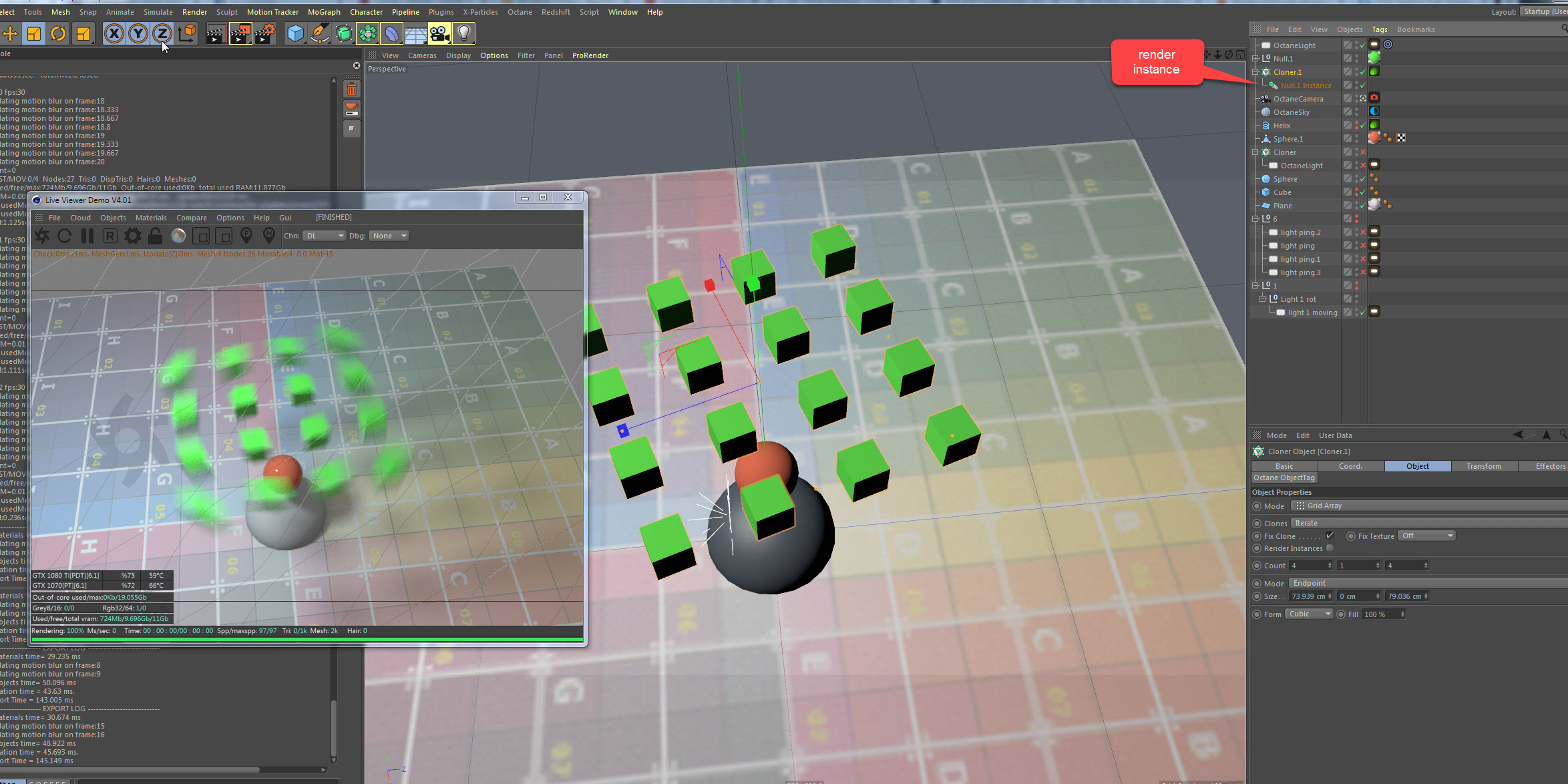

Let me offer you a trick for these cases:
Do a copy of object with renderinstance and put under cloner. See image for better illustration.

AH - this is a good solution for now. Thanks so much Ahmet for getting back to me so quickly. Best of luck on solving this one!
