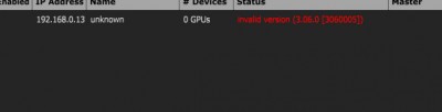

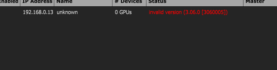

I have the same problem.
Both computers have standalone 3.06, on the master my plugin is 3.06- TEST4, the invalid version info is in the attachement
Posts: 16068
Location: Türkiye
PiotrAdamczyk wrote: I have the same problem.
3.06 and 3.06-test4 is not equal. You have to use matching versions to master for every node of network. 3060005 is core number. Plugin should have same core version. Check the console output to see numbers

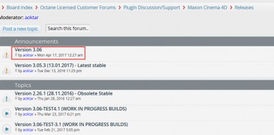

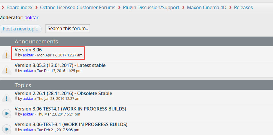

Thanks, i guess i will have to wait for 3.06 plugin version, 3.06 test 4 is the only plugin version i can dwonload now.
Posts: 16068
Location: Türkiye
PiotrAdamczyk wrote: Thanks, i guess i will have to wait for 3.06 plugin version, 3.06 test 4 is the only plugin version i can dwonload now.
Here it's
