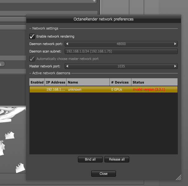

Hi aoktar,
I have a problem with network rendering with the latest version of the plugin(3.03.1). From octane standalone(3.03.1 as well) the slaves are ok, from the plugin they look like in the image. Any idea what to do?
Posts: 16068
Location: Türkiye
Badger wrote:Hi aoktar,
nice. New naming caused confusion. You need 3.03 standalone not 3.03.1. Maybe better to go with old naming for plugin.
Ok got it, thanks. I looked in the commercial release section of the forum for the 3.03 download link of the standalone and I can't seem to find it, all I see is 3.03.1 . Do you have it at hand?
