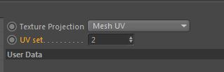

is multiple UV sets already supported?
because when i switch the uv sets in projection node i only get a white material

fuchsundvogel wrote:is multiple UV sets already supported?
No. Do we have any interface for multi uvs in C4D?
fuchsundvogel
Posts: 102
Joined: Tue Jan 06, 2015 3:21 pm
at the moment u can use several uv tags on an object just for whole materials. c4d uses always the uvtag next to it. like this: Mat1 | UV Tag1 | Mat2 | UV Tag2 ........
i just thought that you made something new that makes it possible to use mutiple uvtags within one material. because i found this uv set selector number in the projection node.
maybe you can read the number of uvtags on an object and then use the position. so if i choose uv set 2 it uses the second uvtag on the object. or maybe you can read out the name of the uvtags so if a user renames the uvtags to 1, 2, 3 for example you can choose then the right tag.

fuchsundvogel wrote:at the moment u can use several uv tags on an object just for whole materials. c4d uses always the uvtag next to it. like this: Mat1 | UV Tag1 | Mat2 | UV Tag2 ........
I think it's not a perfect idea. Can cause some confusion and critism. Anyway it's a logic which can work. But there is some other issues. For example It's useless without support of material stacking. Because currently we use just last uvtag to overwrite previous tags. Also material stacking is very hard to implement. Because we can't generate any materials on render time.
