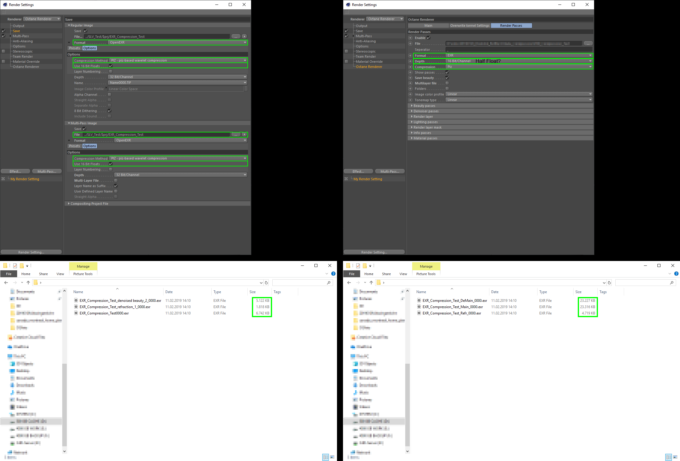

Hi Ahmat. Thank you for this release.
I have a question:
Can there something be done about the rather large compression when saving OpenEXR from the octane save menue.
I usually save through C4D because of that. But with for example Render Layers Black Shadow, this is not possible (needs to go through Octane save dialog)
When I do that, I usually get much larger EXR files.
This is not completely release depended as I noticed that behavior in versions before.
I hope you see what I mean.
I would really appreciate if you can take a look an eventually come up with a solution.
Thank you for your great work.
I attached a simple scene file. Make sure the output paths are matching your machine.
As you probably understand it´s not about the scene, its about the EXR File size compared between C4D and Octane.
