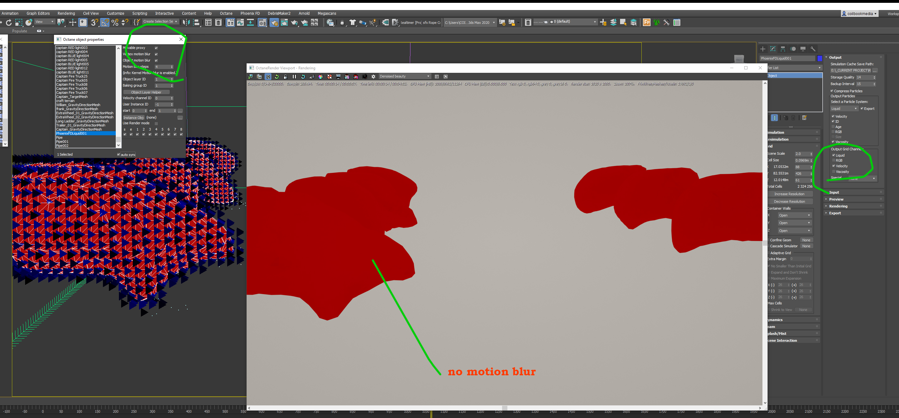

Hi Paride,
we use 2020.2 max and 2019.1 it looks like motion blur is not working for liquids in phoenix
update
in 2018.1 when motion blur is on liquid mesh wont even render
i attached the scene
UPDATE:
octane 4 has motion blur when notify objects on render is set to all objects 2019 and 2018 have no motion blur
phoenix fd liquid motion blur doesn't work

Hi coilbook,
Developers already know about this issue and are working on it.
I added your info to my previous report.
