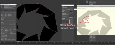

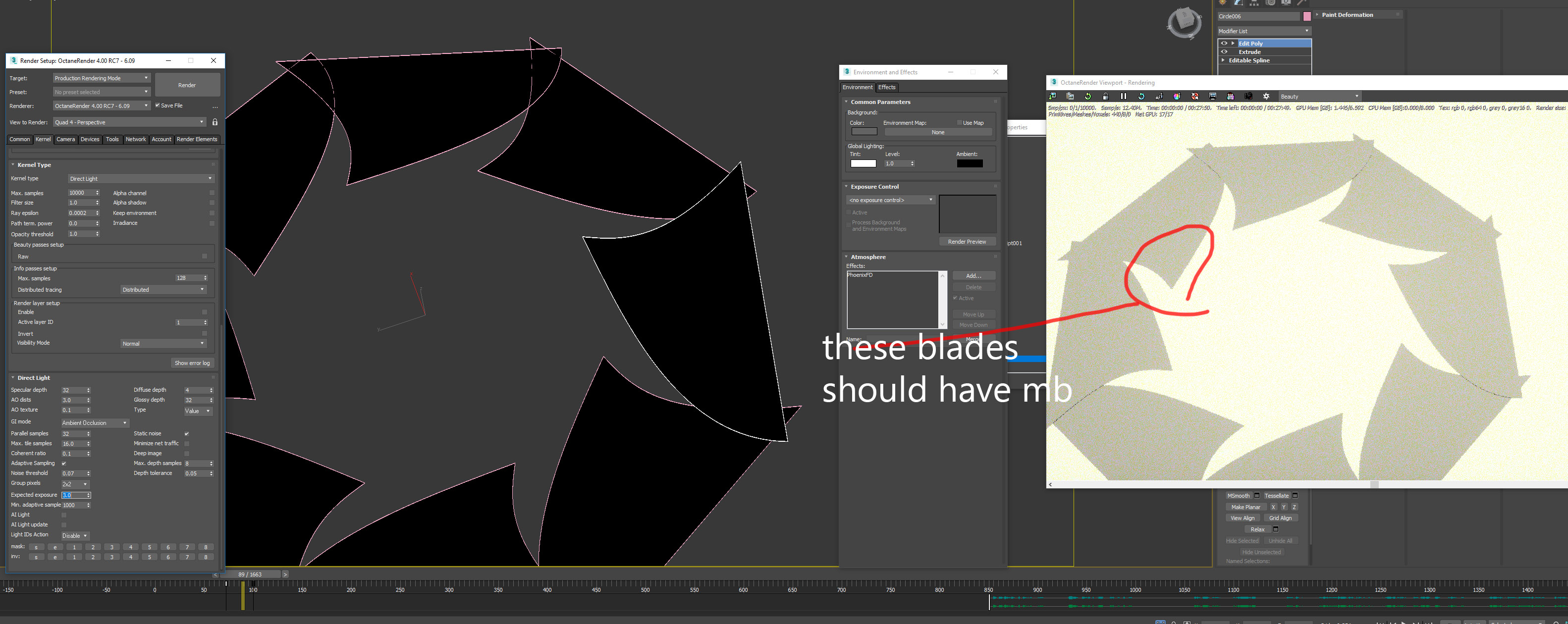

We animated mesh on sub mesh level and there is no motion blur even with vertex mb on. The blades should have mb when they are closing. The scene is attached. Thank you
no mb on mesh sub level

Hi coilbook,coilbook wrote:Hi Paride,
Topology of mesh changed, so motion blur cannot work.

Thanks Paride.
But I would think it should work on vertex level like liquid mb for phoenix.
