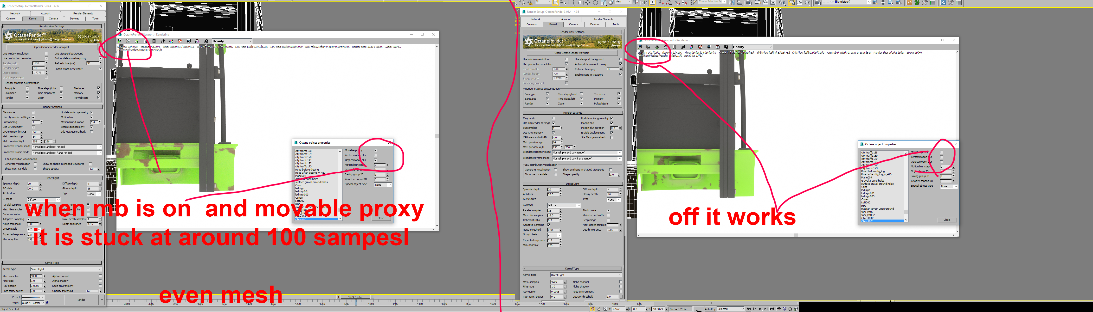

Seems like when mb and movable proxy is on octane viewport gets stuck between 1 and 100 samples and does not render. It does not happen to dummies and helpers it happens to actual mesh. Also slaves fail because of this.
This problem did not exist in earlier versions
Bug with octane preview and motion blur

it seems that if adaptive sampling is on and expected exposure is set to 2.5 instead of 1,2,3,4 or something like this Octane viewport is stuck at 1

Hi coilbook,
did you try with other scenes? Does it always happen?
I can not reproduce your issue, could you kindly share a scene where it happens by activating and deactivating movable proxy?

Hi Paride,paride4331 wrote:Hi coilbook,
Regards
Paride
I will try some part of it. The scene is like 2 Gigs in size
It seems like bigger the scene more little problems happen with octane that do not happens in small test scenes

Hi Coilbook,
Several issues related to viewport / motion blur with Phoenix and adaptive sample have been fixed in 4.37.
Could you check if your problem still happens with 4.37 ?
