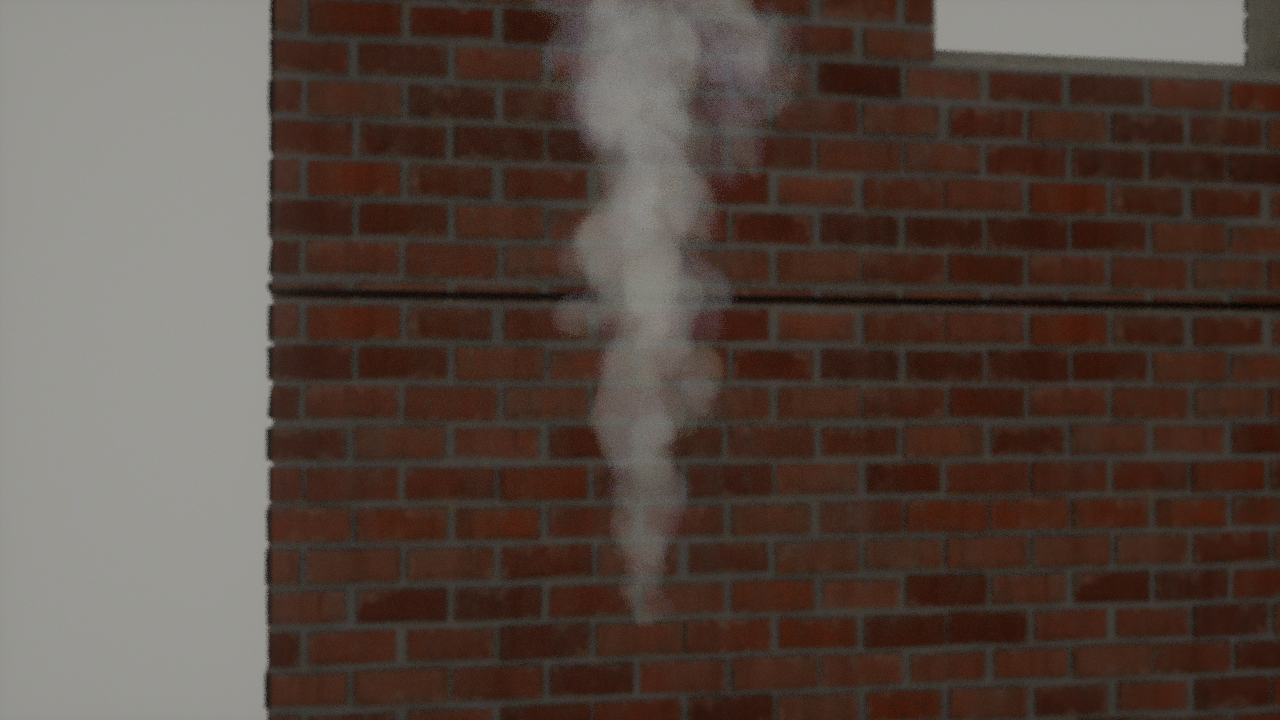

If i slide a time slider it updates in octane viewport When i render it renders only frame one and stays stationary.
Here are two frames attached

UPDATE:: UPDATE: Looks like it happens when you use PhoenixFD 2.20 liquid box for simulations inside Phoenix 2.25. When will 2.25 will be supported. It has FLIP solver for liquids which is way better than 2.20. Chaos told us in forum that they are working with Otoy to get Phoenix 2.25 working.
azen
Posts: 812
Joined: Mon Jun 01, 2015 11:06 pm
coilbook wrote:UPDATE:: UPDATE: Looks like it happens when you use PhoenixFD 2.20 liquid box for simulations inside Phoenix 2.25. When will 2.25 will be supported. It has FLIP solver for liquids which is way better than 2.20. Chaos told us in forum that they are working with Otoy to get Phoenix 2.25 working.
Efforts to get Phoenix and Octane are still on-going. The aim is to have proper support for 2.25 by the next stable release version.
