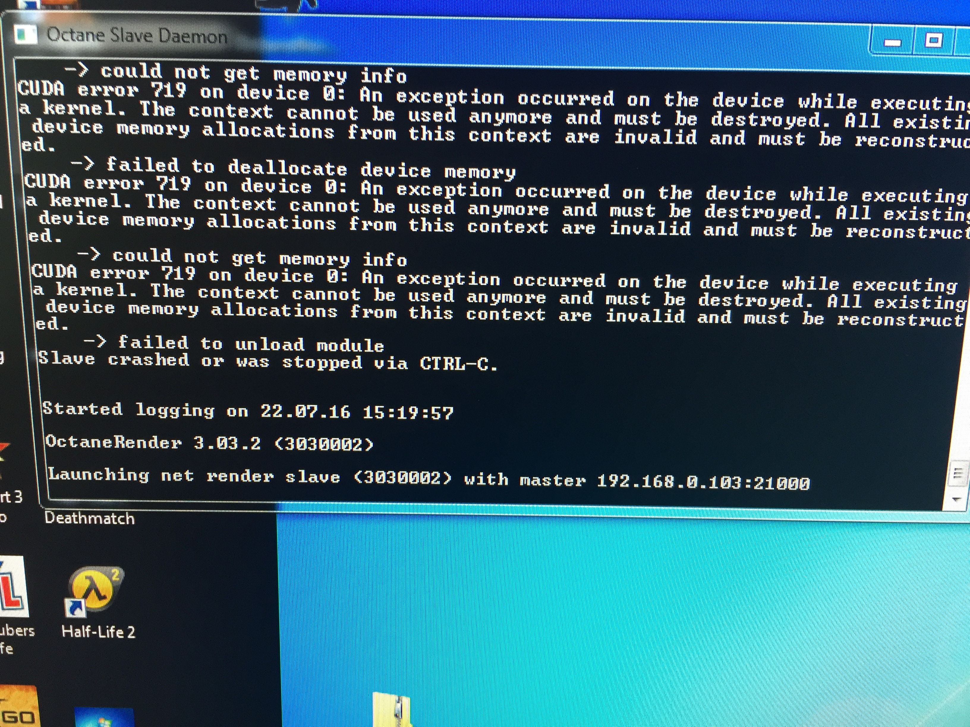

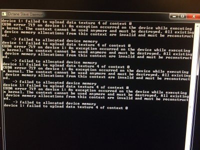

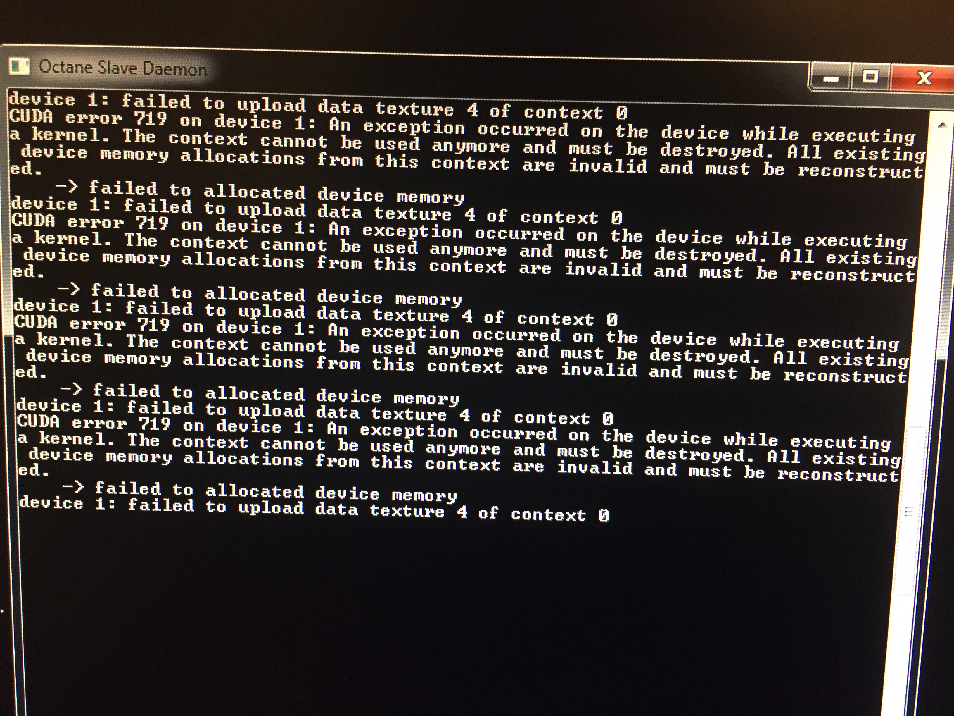

After rendering for 12 hours animation sequence with 5 video cards only 2 continued rendering other ones stopped (netstor Turbo box we use 2 cards quit rendering and 2 continued )_. Then when I clicked cancel rendering 3ds max just closed with crash error . Version 2 never had this problem
ok. While rendering if one of the slaves dies and rendering stop where it is almost finished with the frame if you hit cancel max just crashes and closes. In version 2 we could just cancel frozen render and restart
Still lots of Cuda 719 errors that we never had in version 2

Hi We got main PC with two old titans and netstor box with gtx 780tis. Then we got slave with two 780 tis. We only use 3ds max 2015 and octane for 3ds max. We have 362 drivers since newer ones give us BSOD. We use windows 7 ultimate.
Our rendering is for animation AO 1080P. I think most problems are related to scattering medium in our scenes (we use it for light fog effect). Seems like it slows down system a lot and crashes more often with it.
I attached a video where you can see it stopped rendering and I hit cancel and max just crashes so I cannot look up log to see what the problem is. (Sorry video is upside down )
