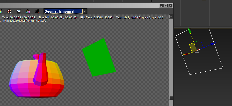

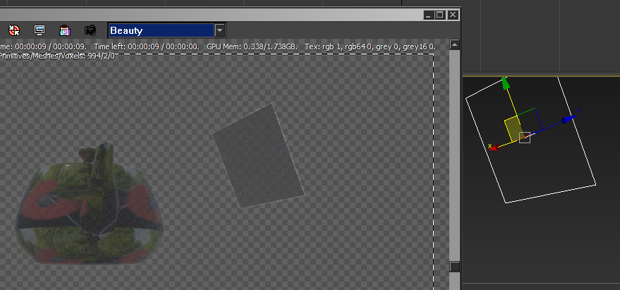

when i use 3d max place highlight, when using octane square lights , it shows up inverted.
start 3d max
on top view create a sphere
on top view create an octane square light
turn on move on movable proxy in light properties
open octanes viewport preview
start max place highlight feature
(the light shows up inverted)
Thanks.

rodrigotrovao wrote:when i use 3d max place highlight, when using octane square lights , it shows up inverted.
Good one, thanks for that.
I've just checked - looks like it's 3ds Max itself is screwing this up... Just an example. The normal of this light plane (in 3ds Max system) is (0, 0, 1) - that is positive along Z (in 3ds Max viewport it is marked by normal pointer line of the light planes). So during translation of the plane geometry its normal is properly translated to Octane coordinate system (as (0, 1, 0), that it positive along Y). And you can see that as green on a screenshot.
So, the normals of this light plane are correct both in 3ds Max geometry object and in Octane object and correspond to each other. But for some reason this 3ds Max' "place highlight" functionality does not respect the normal of this plane geometry and during "placing highlight" rotates it so that its normal looks into opposite direction... After using this function you can clearly see in 3ds Max viewport that the light plane geometry is moved such a way that its normal is looking opposite direction.
I could make a hack, reversing the Octane light plane's normal into opposite direction when generating its geometry, and it worked in a few tests I made... But I won't do this for two reasons:
- All existing scenes will become existing Octane plane lights inverted into opposite direction.
- Even after that there is no guarantee that in some circumstances 3ds Max will not screw up this anyway. Because plane actually is symmetrical, I suppose it may depend from the weather on the moon how 3ds Max' "place highlight" will rotate it in different circumstances...

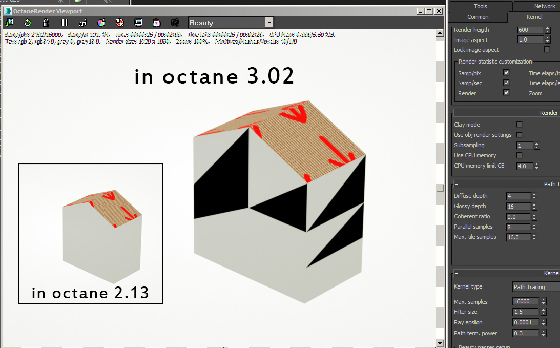

I have a strange rendering bug in 3.2. If I remake the faces it works for a time then problem is back.
EDIT : ooookey, I have very bad UVs on the walls. But render fine in 2.13 not in 3.2, and no maps on the walls... just color.
works now in 3.2 with new uv map, but still very strange....

HHbomb wrote:Hi,
Could you give me this scene, the first variant with "very bad UVs"?.. I can check why it is different in 2.13 and 3.2...
