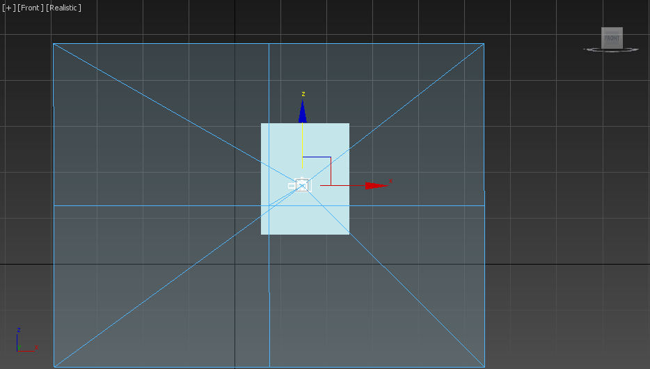

Goldisart
Posts: 780
Joined: Sat Oct 26, 2013 8:47 am
maybe I misunderstood the translation Jim, but the camera is set strictly
https://www.youtube.com/watch?v=xGGrKZJ ... e=youtu.be

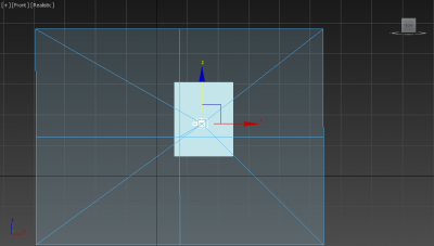

JimStar
Posts: 3837
My explanation is exactly about not strictly vertical placement of any camera that 3ds Max creates - no matter is it Max standard camera or Octane camera.
To make the Octane's "Perspective correction" work Octane rendering core needs a camera placed strictly vertically (UP-vector facing vertical direction). Just create a new camera and use the script line from my screenshot to see its transformation matrix. You will see that the UP-vector is very close to be vertical ([0.0, 0.0, 1.0] vector), but it is still not vertical. Octane rendering core will not do perspective correction for you if your camera is not strictly vertical.
