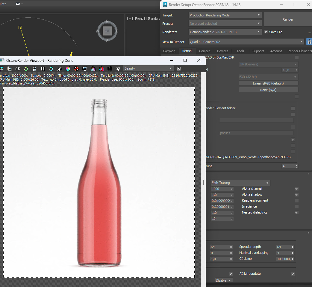

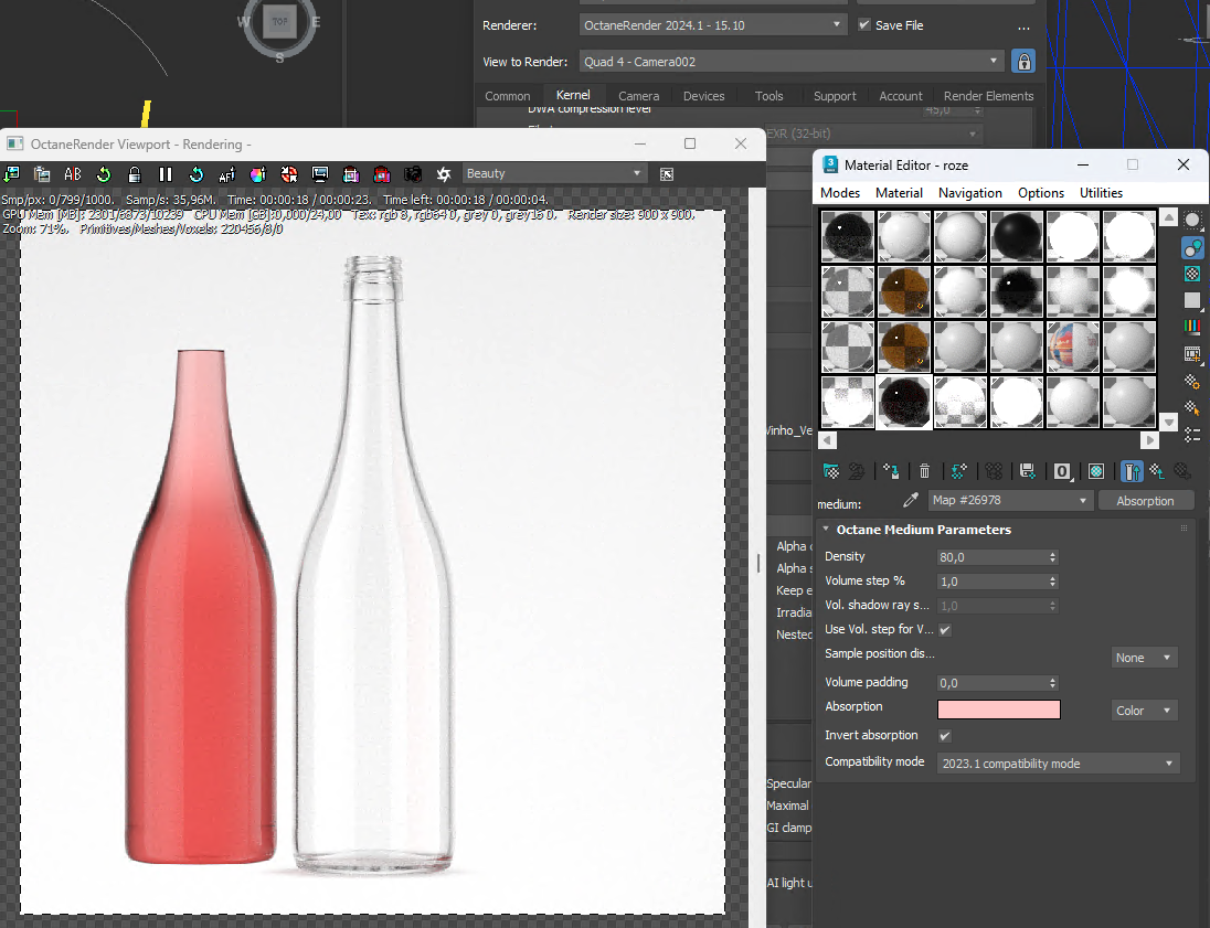

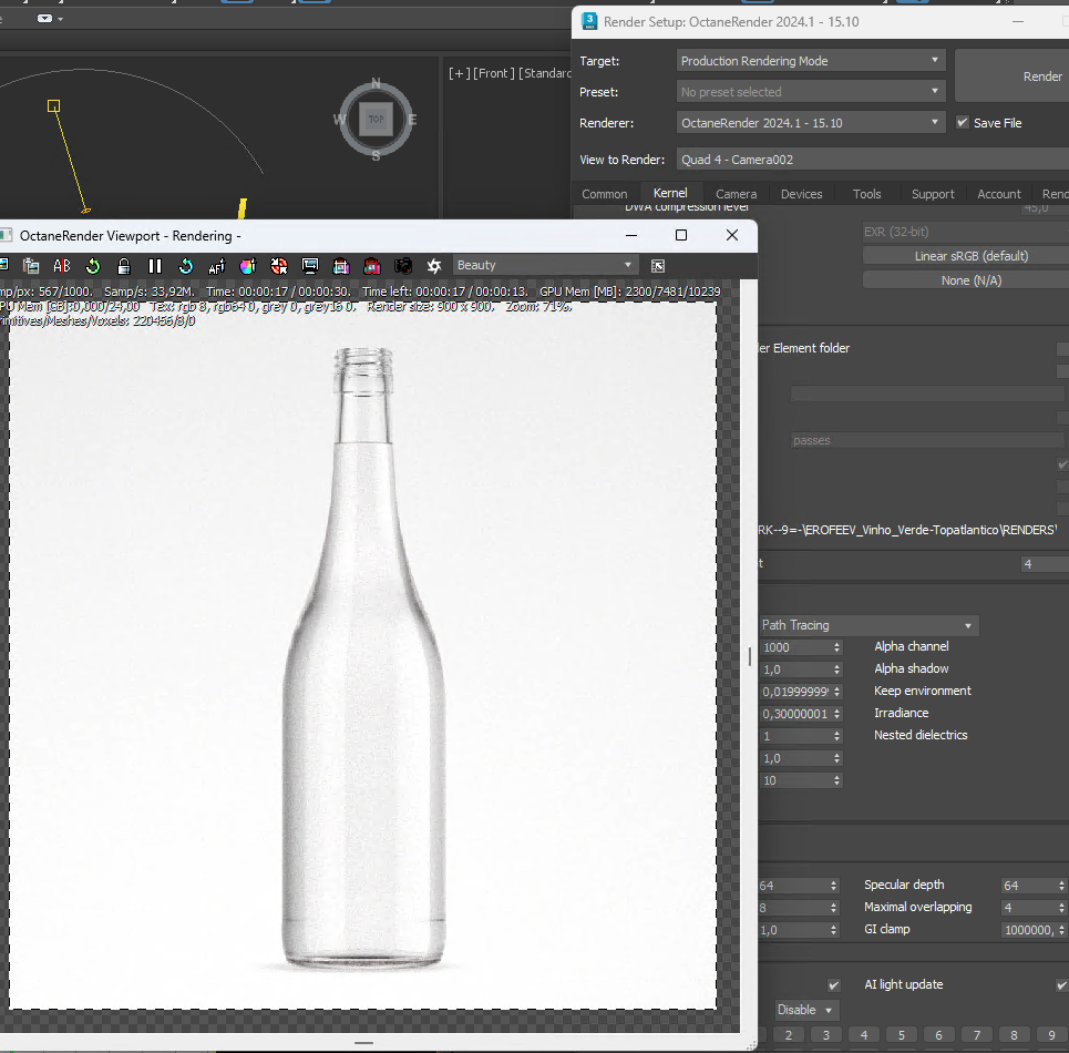

Bug with the medium absorption inside the glass:
Octane 2023.1.3:
Octane 2024.1.0: Octane 2024.1.0 - same object outside glass:
Ray epsilon 0.02 but lower not work - the same result

Hi truerender,
Could you kindly share the scene where you are encountering the issue you're reporting?
3ds MAx > File > archive
Regards
Paride
Regards
Paride

Here it is
