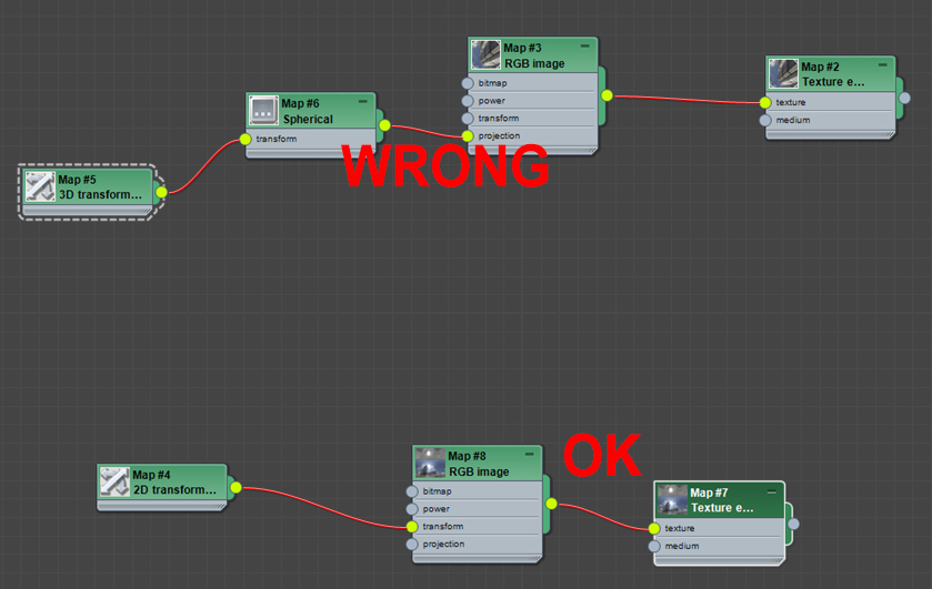

Hi mikinik,
You are using the environment node incorrectly.
That way, you're bypassing the importance_sample parameter.
So hdri generates noise in your render.
Attached the correct environment node.
Regards
Paride

- damn - the HDRI I was using it wrongly all of this time, I read it once to use the spherical thing and kept on usingi it - I guess I'll get faster renders now .. so thanks

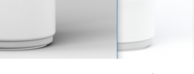

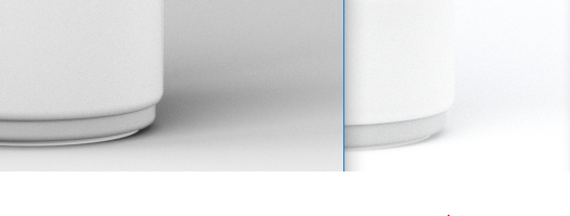

BTW Is shadow catcher supposed to be used like this, the left one was catcher, and I want to have the shadows as on the right
- I wanna keep the shadows I get on the lighter render and keep the alpha - shadow catcher doesn't seem to affect the render with the lighting - or it does?
- is there a workaround so I don't have to do another render
- also if there is another plane behind this with Visible to cam turned on so it's invisible - the alpha in the specular then doesn't work as it shows the thing behind it.. - I'm guessing that's the limit?

thanks for the answerparide4331 wrote:Hi acc24ex,
I think you could fix it in post production, using your alpha shadow and a render object using layer render.
Regards
Paride
I did manage to get something with it, but couldn't work out how to get the shadows on the ground with alpha transparency - through the shadow catcher
- shadows were different when shadow catcher was activated - is it suppose to behave like that ..
- it was like there wasn't any background - shadow catcher material behaves as transparent alpha?

Hi acc24ex,
Materials with shadow catcher capture shadows cast, is not a real material.
It allows to have shadows with alpha for compositing.
https://docs.otoy.com/manuals/products/ ... w-catcher/
Alternatively you could use shadow pass
Regards
Paride
Regards
Paride

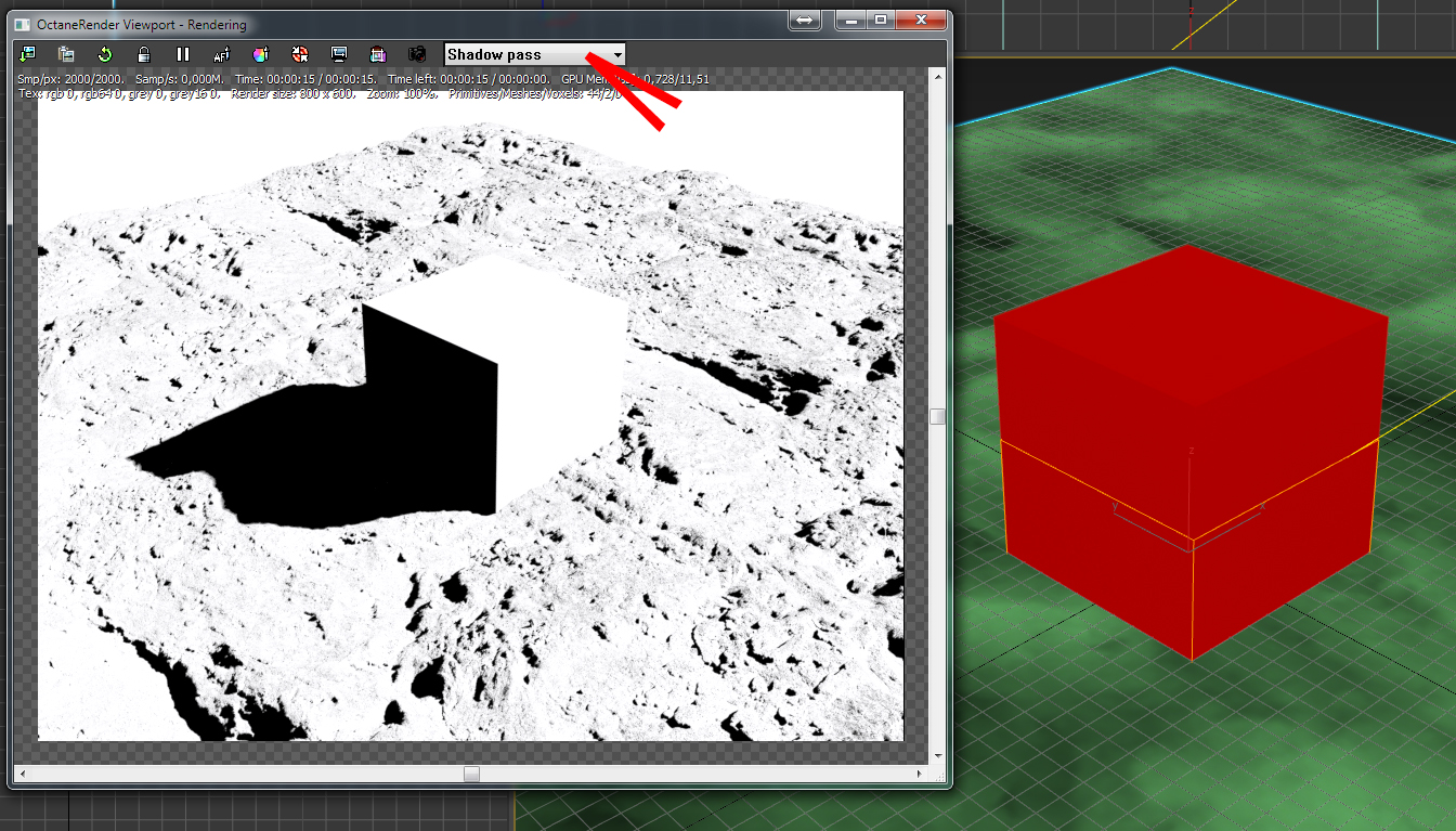

..how do you "work" the shadow pass - I'm not getting anything
