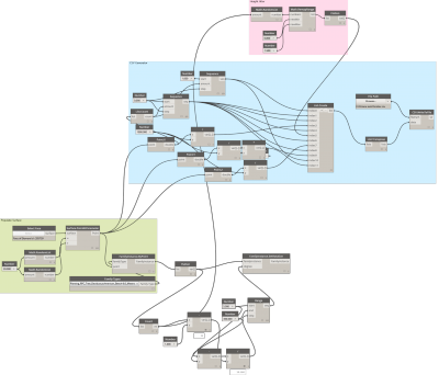

Hi its a little late but if anyone needs it here's the dynamo definition that generates a CSV file based on the location of populated family instances in Revit. Once generated the file can be put into Octane plugin and the famile instances are no longer required in the Revit model.
(can't figure out how to attach the .dyn file so here's a link to download it)
https://www.sendspace.com/file/zow37j
hope this helps
