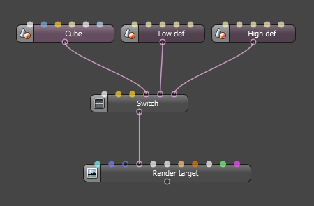

This node lets you create a selector between multiple variants. You can have several cameras or several geometries or several materials, etc. and change the one that is actually used in the scene by setting the "Selected option" variable. This avoids constantly disconnecting and reconnecting nodes when you need to go back and forth between various options.
Usage: set the type and number of options and plug your variants in the option list. If you need more than 32 options you can also daisy chain them indefinitely.

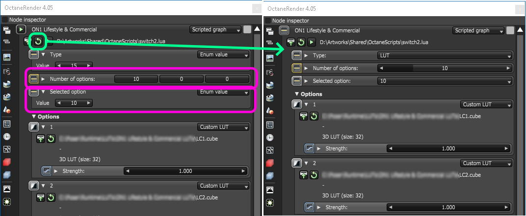

There is also one more issue: when scene file, containing these switch nodes is opened, their UI (in Node inspector) doesn't initialized properly, need to click "Reload script file" button:
May be some issues because of 4.05 version.
