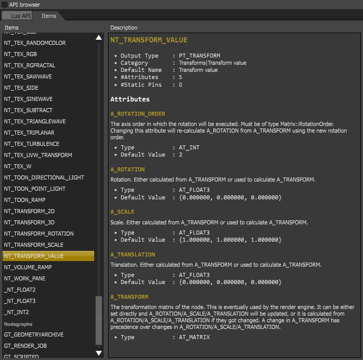

How can I update UV Transfrom (NT_TRANSFORM_VALUE) from code?

Hi bmustata,
There are several nodes types that make use of NT_TRANSFORM_VALUEso you'll need to find the actual pin within that node using the Lua API browser.
In either case, once you find the right pin to read or write, these are the attributes you can access to:
I hope that helps.

Currently I'm trying something like this but it's not working right.
Code: Select all
node:setPinValue(octane.P_TRANSFORM, octane.matrix.make3dTransformation({0,0,rotate}, {repeatX,repeatY,0}, {0,0,0}, 2))

Any more help on how to update the rotateZ and scaleX & Y for a texture (NT_TEXT_IMAGE)?
mojave
Posts: 1433
Joined: Sun Feb 08, 2015 10:35 pm
Nodes of the type NT_TEXT_IMAGE have a pin P_TRANSFORM of NT_TRANSFORM_VALUE type.
You need to set the attributes I showed you in my previous post to their individual values.
