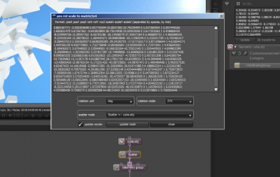

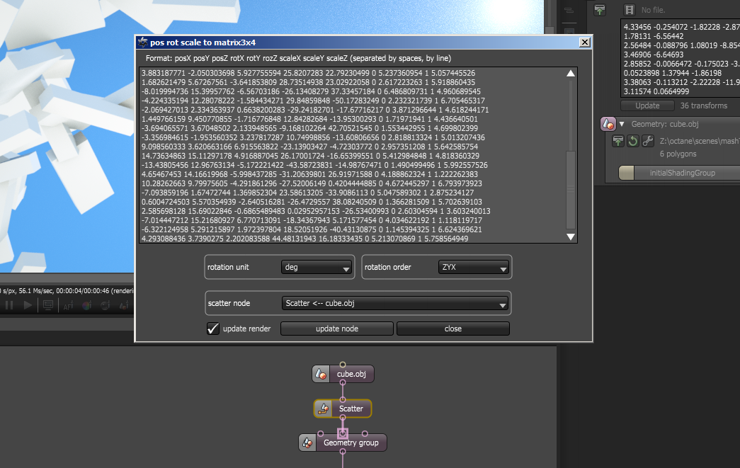

Paste a list of positions, rotations and scales and assemble your matrices in octane.
This is my first lua script, so shut up/criticize to death?
Usage:
  1. select a scatter node or don't
  2. start the script
  3. paste a space separated list of positions, rotations and scales (per line)
  4. fiddle with the rotation order and deg/rad option until it fits
  5. update your scatter data
Feel free to report bugs
posRotScale2scatter.lua
(7.56 KiB) Downloaded 958 times
v.0.1
