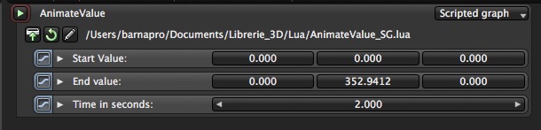

Here is a solution for fastly animate a value via Lua scripted graph:
AnimateValue_SG.lua
(1.99 KiB) Downloaded 2888 times
Animated Y rotation in 2 seconds
Define a Start value, an End value and the duration expressed in seconds.
The total number of frames depends on the FPS value of the scene.
You can animate any kind of value, just connect the output of this scripted graph node to a blue (value) pin of a desire node.
For single value like Power value, use the first of the three fields in the Start value and End value node.
Happy rendering :)
ciao beppe

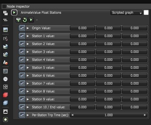

Hi Notius, here is a Lua Script based of Beppe's that has 10 'Stations'. Think of it like a train ride, with an origin followed by 10 stops, with the 10th stop being the end stop.
The time value you enter will be the per-station trip time. So at the default, of 1 second, the animation runs at a total of 10 seconds. If you set at 6, it will run for 60 seconds.
So, with this you could manually plot out a float value's oscillation (ie rise and fall with 0, 1, 0...... a plateau with 1, 1, 2, 2, 2, 2, 2, 2, 2, 2, 2.... a stairway with 1, 2, 2, 3, 3, 4, 4, 5, 5, 6, 6....etc) amidst the total trip time, which is the per-trip time you specify *10. Each individual station will be exactly the same, but you could plot the same values repeatedly to get a different effect.
Or, instead of inputting #'s in to each station, you could just set the per-trip time to a longer time (ie 5) and then have just 1 or two stations > 0, for a 10 second animation let's say. Just keep in mind if you do this, the entire frame / time displayed in the Octane viewport will look large, but you can always batch render to any frame/time point you want, prior to the displayed last time or frame, thus capping where you want it to end.
Confused?
Great!
Here is the script and a pic:
AnimateValue_FloatStations.lua
(5.15 KiB) Downloaded 2433 times
Remember, in principal it works the same as the one Beppe gave us, his had 1 stop from the point of origin, which was called 'End'. The time was still a per-trip time, but as there was one it represented the entirety of the trip.
But this is neither here, nor there. I saw you had asked for a script with stations, and despite that I have no idea what I am doing with Lua, I edited the script for you.
Now, go and get to rendering...come on...Go...Go....

Hi Notius, thank you very much. I want to learn more about Lua now, seeing what you can do with it.
Most importantly, I want to recognize your generosity, and your wisdom as well...And your humility.
I wish many Octane coins to you.
PS - Thanks Beppe!
