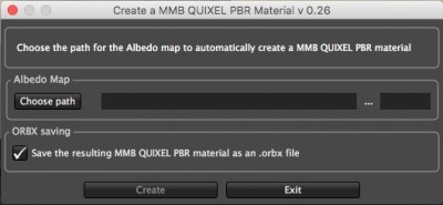

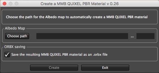

The script searches and downloads the MBB_QUIXEL_PBR.orbx material provided by miko3d, asks for the albedo texture path, automatically imports all the needed maps in the proper pins, and then, the resulting material will be saved as an .orbx file if needed.
Note: you need to be connected to the internet, otherwise the script can't have access to the LiveDB

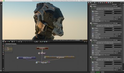

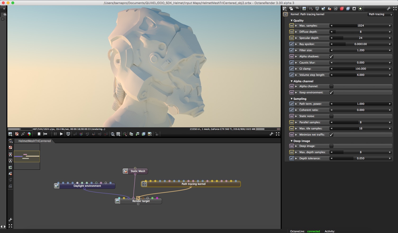

before
before
after
after

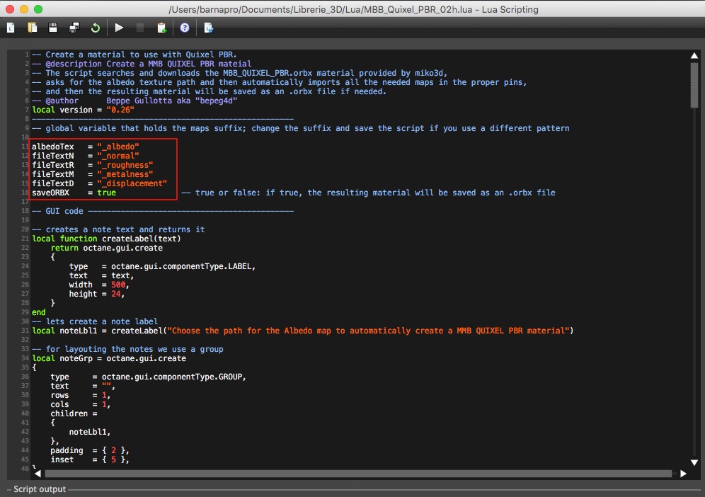

If the script is opened in the Script Editor window, almost on top, it is possible to change some default values like the maps suffix that could be changed if you use a different pattern, or enabling/disabling the automatic saving of the ORBX material in the same folder of the Albedo texture. Then, if the script is saved, it can be execute directly from the script menu with the desired default values.

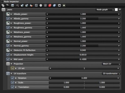

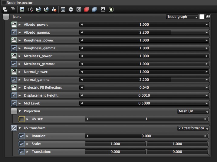

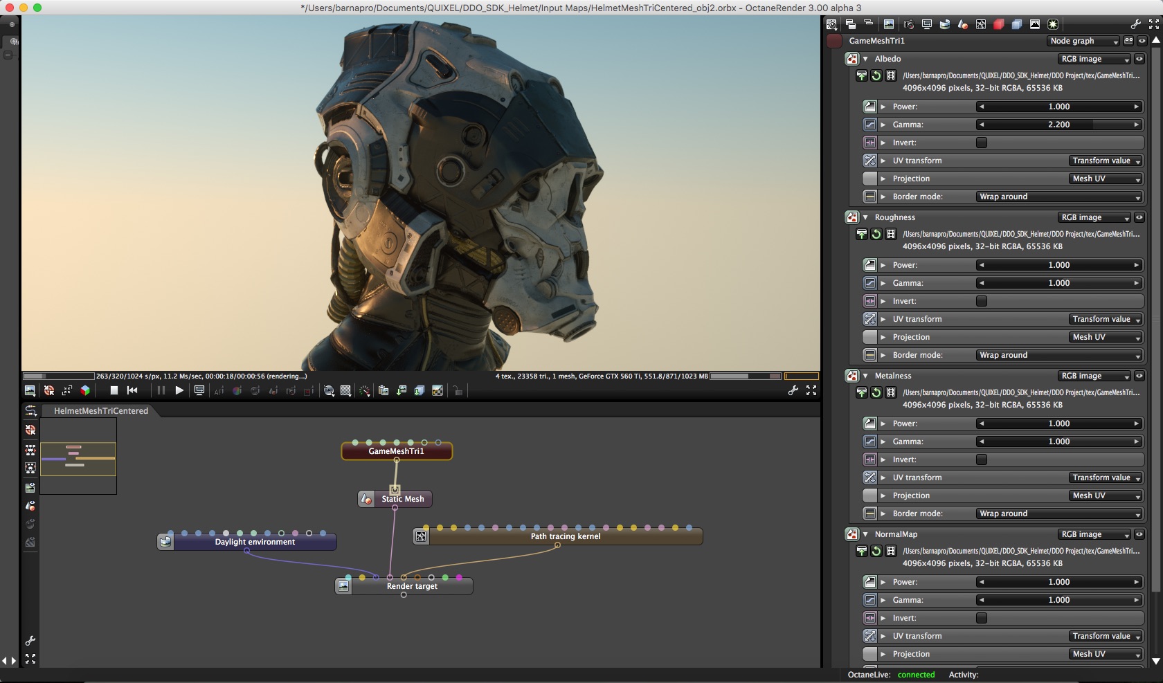

The interface is the same, but the result is a bit different in the node inspector:
Now there is an error message, if the "albedo" map choosen does not have the correct suffix. All the maps are connected to the same Projection and UV Transform node, to easily change the mapping.
I have noted that in the LiveDB material the Gamma of Normal map is set to 1. In this script the Gamma is set to 2.2.
Please let me know your comments and critics.

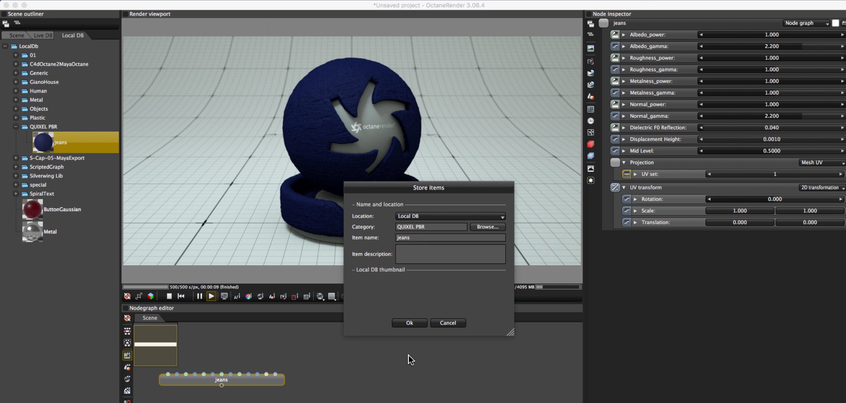

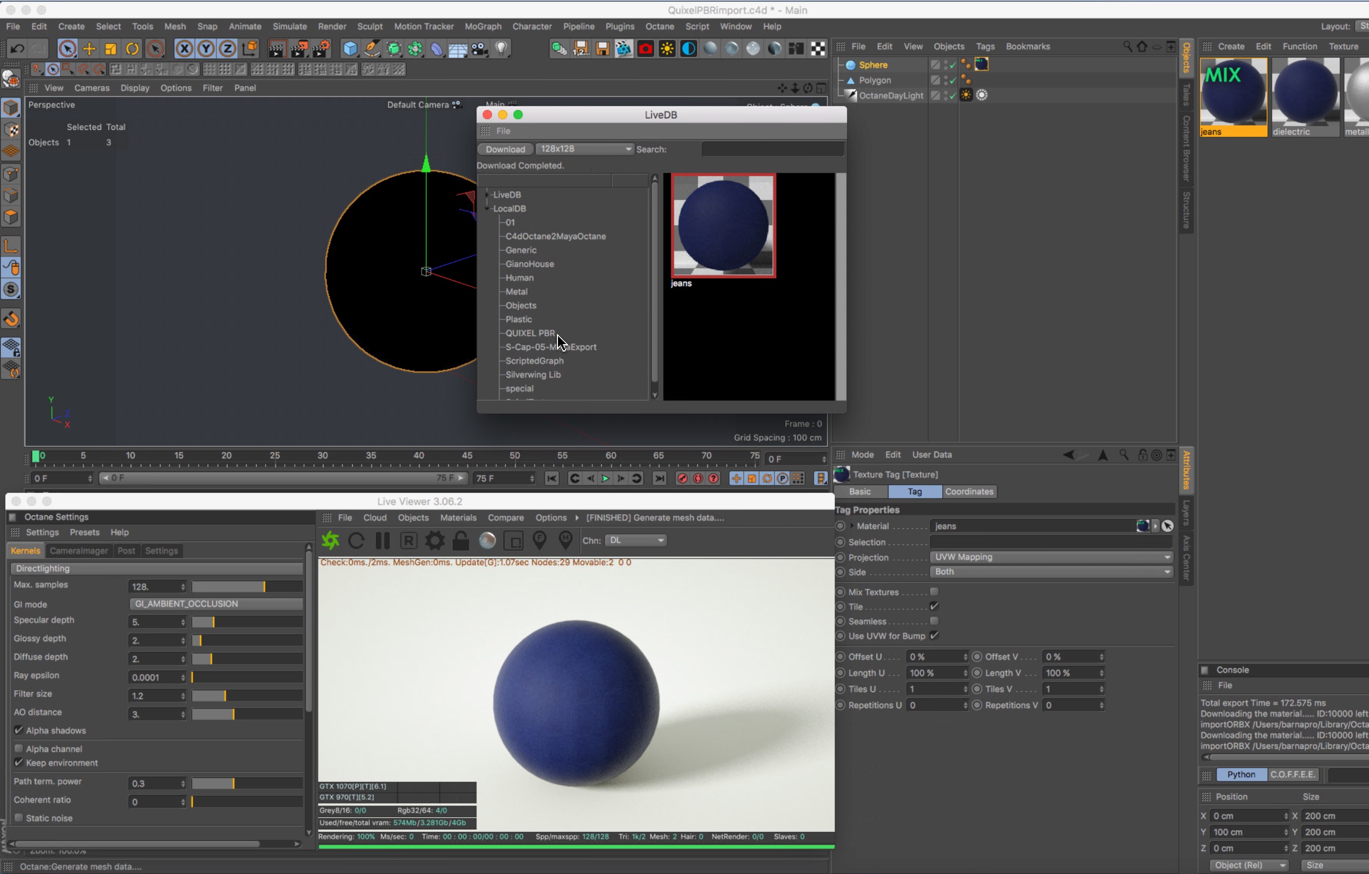

Can you use this to set up materials in standalone and export a orbx file and import say into c4d to get just the shaders and re assign to geo ? This looks awesome thanks for the goodies!
Posts: 10654
Hi 3dhermit,
yes sure, you can even save the material in LocalDB from Standalone, and reuse it in plugins, here is an example imported in c4doctane:
in Standalone
in Standalone
in c4doctane
in c4doctane
Happy rendering,
