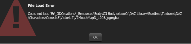

I have written code that connects the mesh pins but when I try to change A_FILENAME on a texture I get an error.
Path seems ok.
Is there something specific with an imported asset that includes texture that prevents me from changing them by code?
I tried the following as well.
I manually changed the texture to the image i wanted.
Then in code i printed out the path with mytexture.getAttribute(octane.A_FILENAME) and i could see it pointing to the image in question.
in the following code row i did mytexture.setAttribute(octane.A_FILENAME, (with the path to the same image as I got above), true) but then I got the error.
Attached error message in case that can help to figure out whats wrong.

maybe a stupid question, but why you have :rgba at the end of the path name?

Octane appends the :rgba in the error message. It indicates that the texture it couldn't load was meant to be used as an image with texture (in case of a float image texture it would output :mono).
A_PACKAGE and A_FILENAME are coupled. When you want to load the image directly from file, you need to clear the package attribute via node:clearAttribute(octane.A_PACKAGE).
