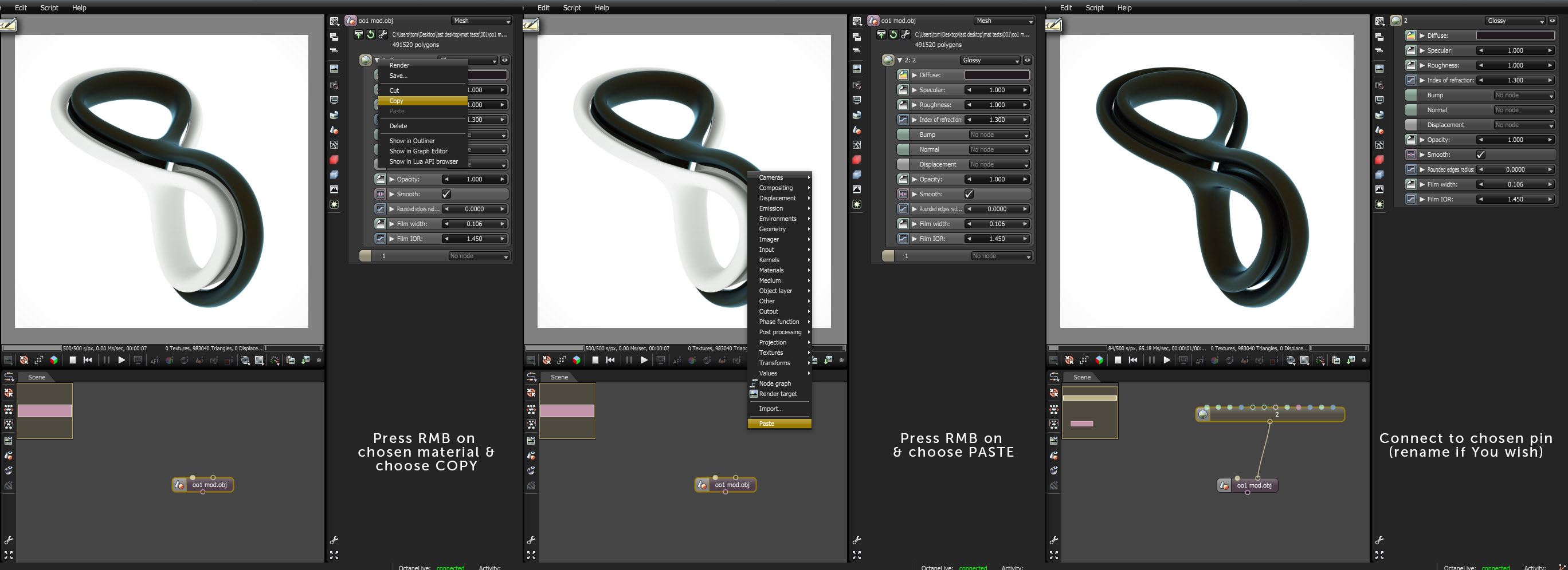

You don't need any script for that =) look, I'll do some printscrreens =)..

Sorry, I dont have english as main language so I might have expressed myself bad.
The manual process you did in those images, is the same process as I described in words when trying to explain what I want to accomplish in code.
I know that I can do it manually. ;)
So...
What I'm trying to do in code is an automation of that process as it has to be made on a lot of materials.

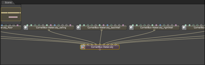

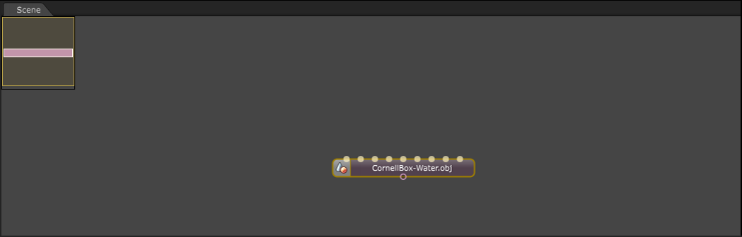

Here's the before and after:
before running the script
after running the script
