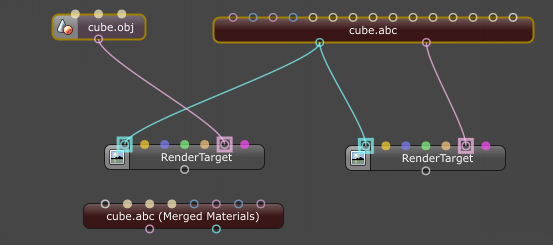

Hey guys,
Here's a script I hacked together. It tries to group the materials of an abc archive that match the material names of a "guidance" obj mesh (e.g. RED_1, RED_2 & RED_3 would match RED and are grouped together "RED"). If the "guidance" obj mesh is bogus then you would get an abc mesh that's the same as the original.
All you have to do is select the mesh and alembic scene and run the script (currently it's bound to ctrl + m). The net result should look like this:
Here's the script for the copy/pasters:
And here it is for the downloaders:
cheers,
Thomas

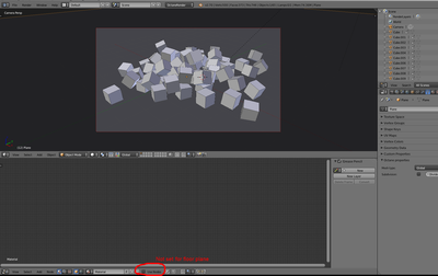

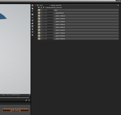

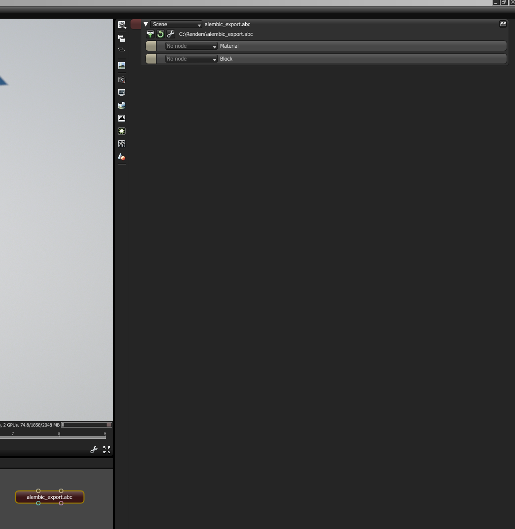

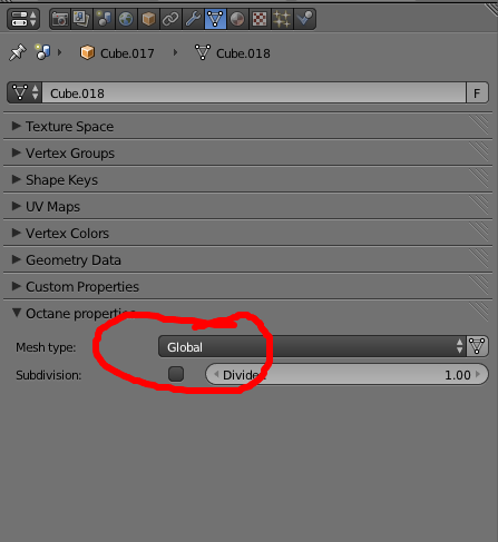

I can't speak for other people, but I am using the OR4B plugin and exporting. I noticed I get less material pins when I export my animation with moveable geometry over ride.
Intel quad core i5 @ 4.0 ghz | 8 gigs of Ram | Geforce GTX 470 - 1.25 gigs of Ram

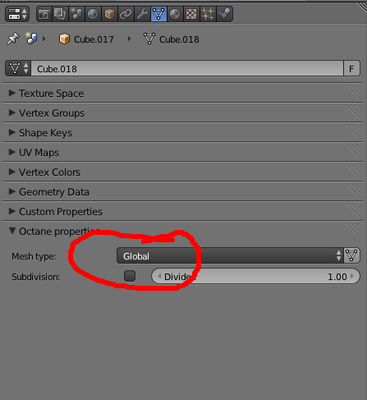

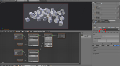

What exactly thing you have in Blender, can you please explain in detail with screenshots? As so far - I can't see here some issues, all works OK for me if I carefully set up the animated scene in Blender...kavorka wrote:I get the same thing from Blender.
I will try to explain, as perhaps there is some misunderstanding...kavorka wrote:I can't speak for other people, but I am using the OR4B plugin and exporting. I noticed I get less material pins when I export my animation with moveable geometry over ride.
Blender plugin (and Maya plugin too) have complicated animation geometry settings which purpose is to be able to "maximally minimize" the geometry export time in animations. I've already explained it somewhere in Blender threads - if you animate in "Full" animation mode - for every "Global" scene geometry you get the new different geometry object in every frame, with all its pins. So finally you get overall amount of pins of all geometry in all frames for "Full" mode. Materials are "collapsed" by their names, so even in this case, if you have carefully set all node-materials to the geometry, you will get some like this for 10 frames animation: As all this big amount of pins will be connected to the the same materials in different frames.
But if you have some material not properly set as named node-material - Octane will give it the automatic name which contains the mesh name in it to be unique. The doubled in every frame global meshes have different names, so these materials will get different names too. So finally - you will get different materials for different frames. Anyway - using the "Full" animation mode together wit "Global" meshes - is bad idea from the point of view of performance. "Global" meshes are very good for some static complicated images renderings, as interiors - as in this case the geometry export time does not matter in comparison to the render time, but the render time will be faster in the case of entire scene as "Global" mesh...
But for animation - you can dramatically improve the geometry export time for the entire animation if you will carefully tune all the scene geometry. So, in this case, some rules:
- Set the animation mode to "Movable proxy"
- Set all the geometry objects which are static between frames as "Scatter". In this case this geometry will be exported and evaluated only once, in the first frame of animation.
- Set all the geometry objects which move between frames (but not deform) to "Movable proxy" type. In this case this geometry will be exported and evaluated only once, in the first frame, but the transform will be reloaded every frame. This is fast operation.
- Set all the geometry objects which deform between frames to "Reshapable proxy" type. In this case only this geometry will be reloaded and reevaluated every frame.
- Check that all the geometry have properly set material nodes which are properly named.
Something like this...
