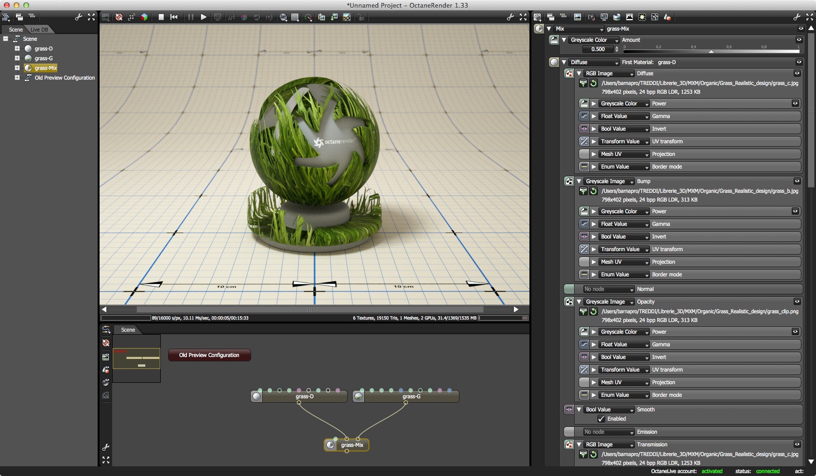

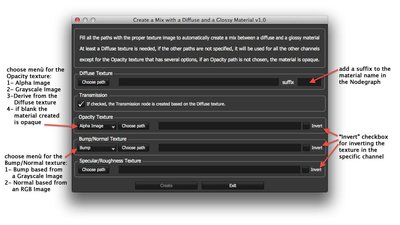

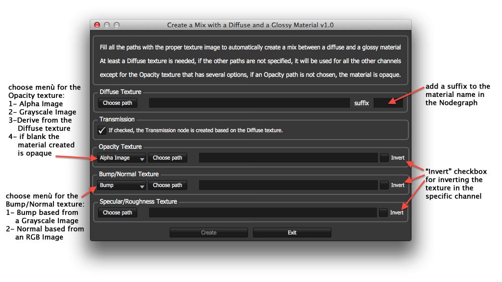

finally i have updated the script with the interface and refined the options,
i hope you could find it useful in some way:
bg4dCreateMixMat-1_00.lua
(23.99 KiB) Downloaded 498 times

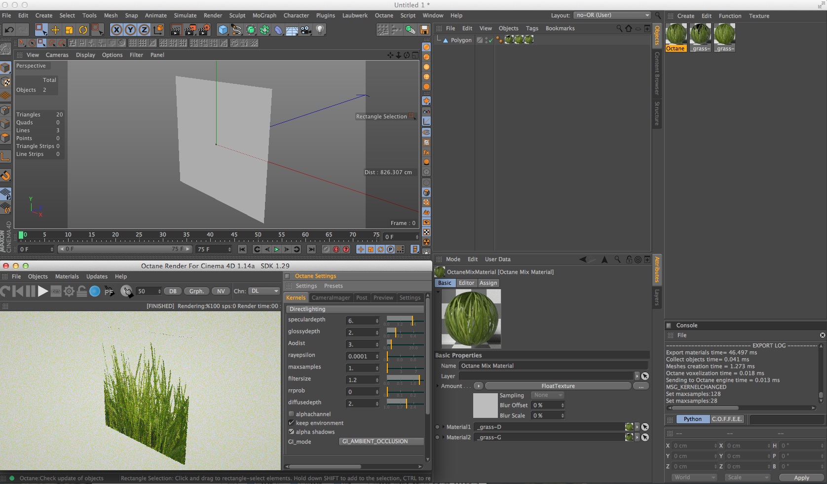

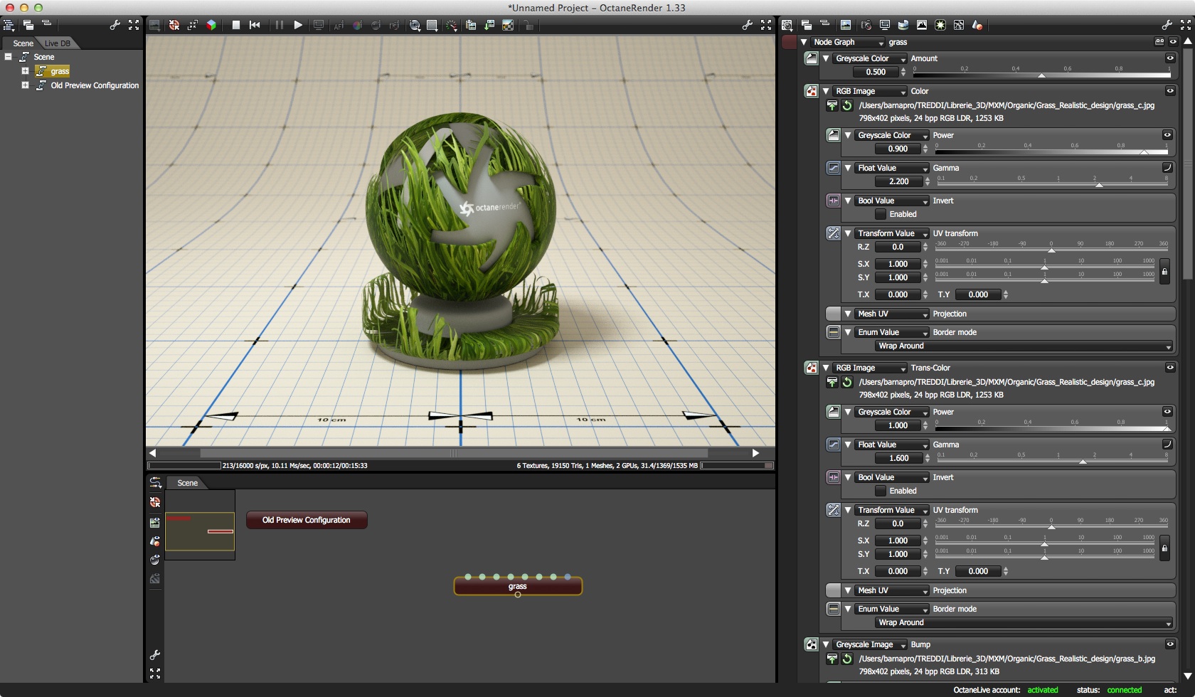

note for c4d users: in order to import the material from standalone to the integrated plugin, it's necessary to "ungroup" the material, from this:
to this:
then, if saved as .ocs, the material can be imported into c4d.
ciao beppe

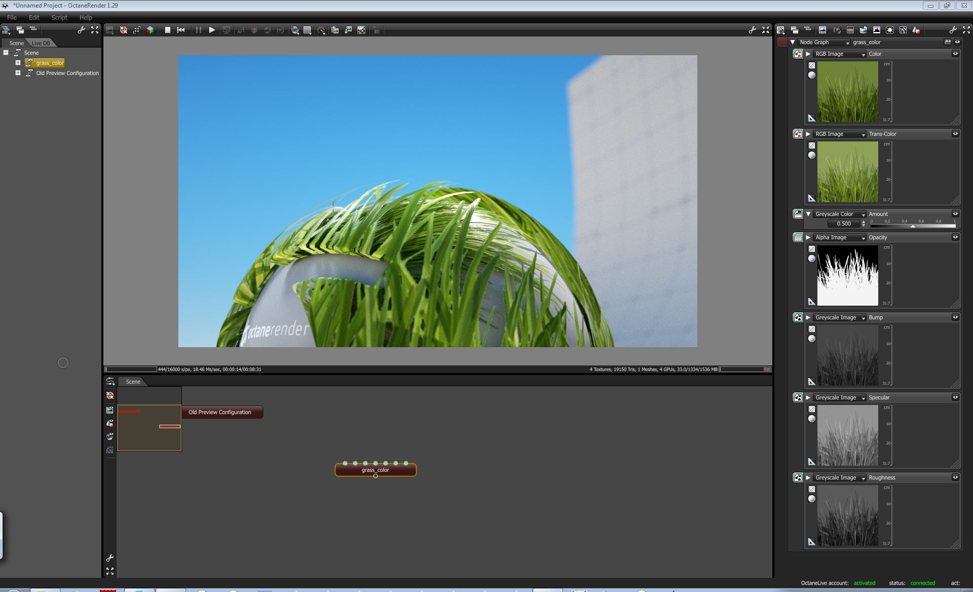

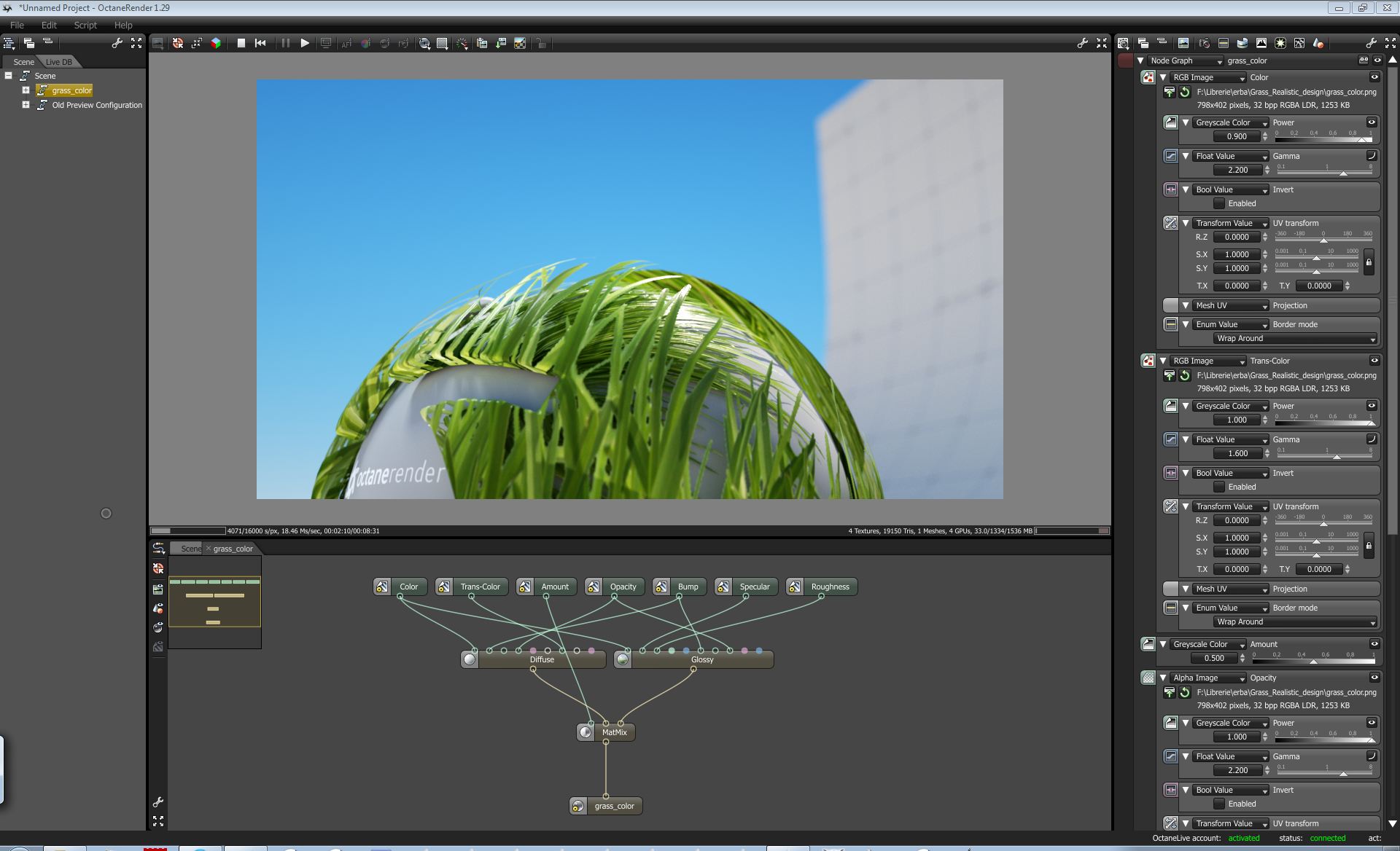

here is my first lua script (with the help of jedi master thomas stratified kenobi )
it's a simple script that asks for an RGBA image and creates all the nodes and inputs for the classic mix material between a glossy and a diffuse, suitable for one-poly leaves or grass, using only one texture.
i hope you can find it useful.
bg4d-organic-alpha-mat.lua
(5.12 KiB) Downloaded 492 times

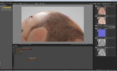

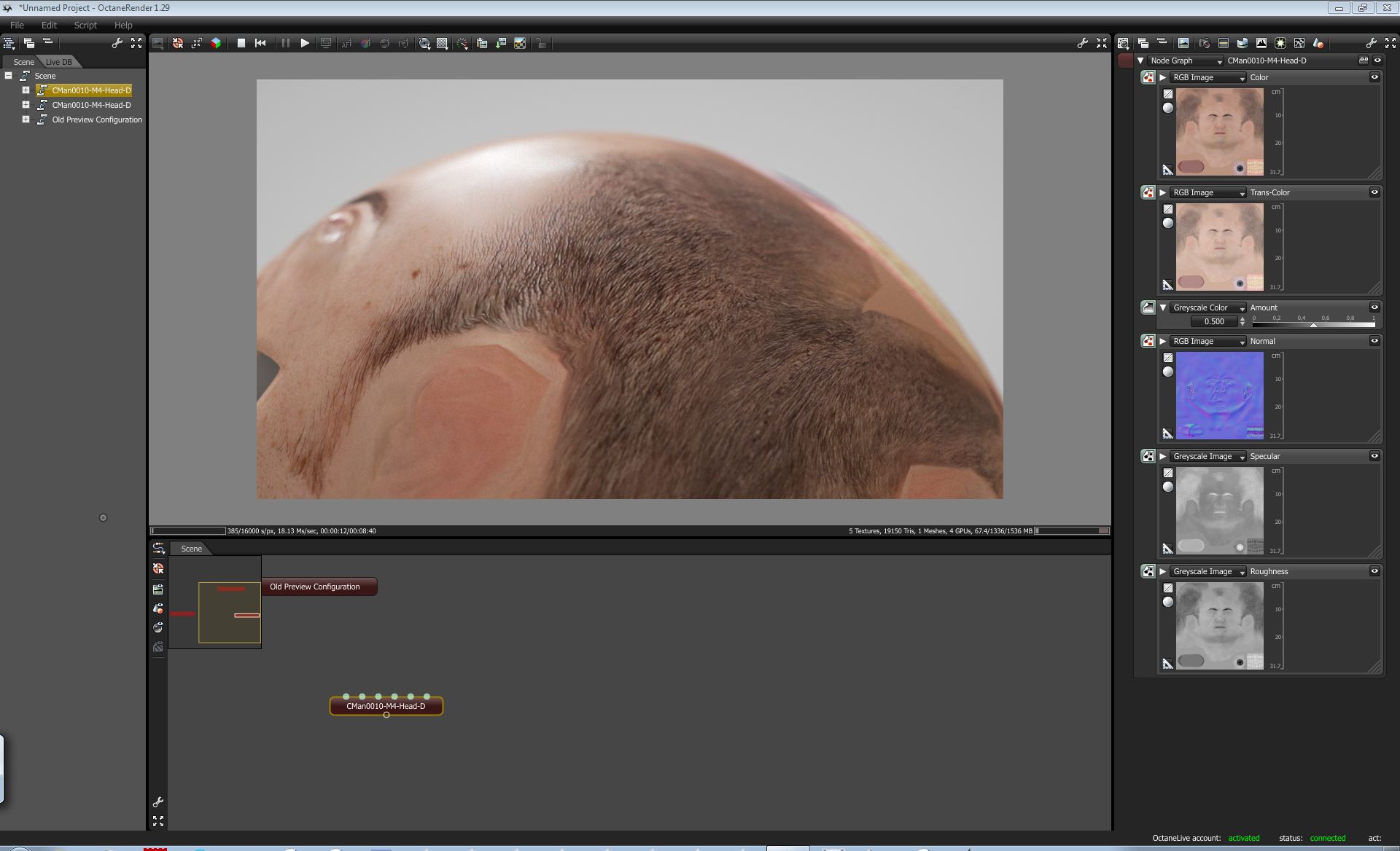

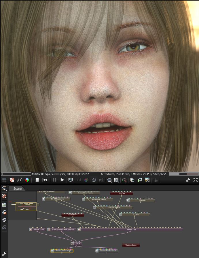

Thanks for sharing, I modified mine to include jpg images. BTW you may have accidentally created a great skin shader without realizing it. Just tested it on Daz character.
Script test maps
Script test maps

@tugpsx: i have create a variation more suitable for skin, basically i have removed the opacity nodes and added a second texture load for normal map, plus a different approach for specular and roughness.
i hope you can find it useful ;)
bg4d-simple-skin-normal-mat.lua
(5.09 KiB) Downloaded 484 times
ciao beppe
