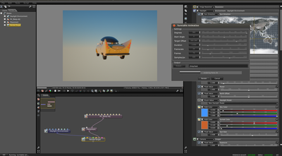

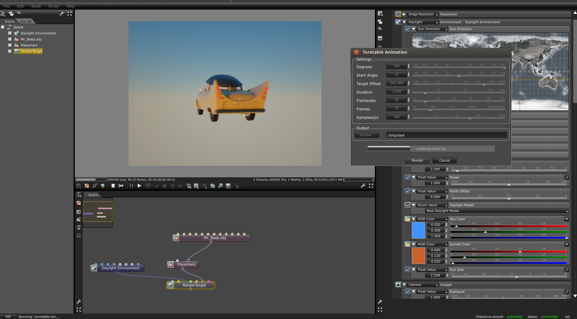

We need to modify the GUI callback to make everything work. The "logic" is here. The duration, framerate and frames sliders are coupled, when we update one we want to update the others accordingly. When the user clicks the button to choose a file, well we want to show a file chooser. When a file is chosen we can enable the render button. If the user clicks the render button, we simply start rendering. And if he clicks the cancel button we cancel the rendering:
Code: Select all
-- callback handling the GUI elements
local function guiCallback(component, event)
    if component == durationSlider then
        -- if the duration of the animation changes, update the #frames
        local frames = math.ceil(durationSlider:getProperties().value * frameRateSlider:getProperties().value)
        frameSlider:updateProperties{ value = frames }
    elseif component == frameRateSlider then
        -- if the frame rate changes, update the #frames
    elseif component == frameSlider then
        -- if the #frames changes, update the duration of the animation
        local duration = frameSlider:getProperties().value / frameRateSlider:getProperties().value
        durationSlider:updateProperties{ value = duration }
    elseif component == fileChooseButton then
        -- choose an output file
        local ret = octane.gui.showDialog
            type      = octane.gui.dialogType.FILE_DIALOG,
            title     = "Choose the output file",
            wildcards = "*.png",
            save      = true,
        -- if a file is chosen
        if ret.result ~= "" then
            renderButton:updateProperties{ enable = true }
            fileEditor:updateProperties{ text = ret.result }
            OUT_PATH = ret.result
        else
            renderButton:updateProperties{ enable = false }
            fileEditor:updateProperties{ text = "" }
            OUT_PATH = nil
        end
    elseif component == renderButton then
        startRender(SCENE_GRAPH, RT_NODE, CAM_NODE, OUT_PATH)
    elseif component == cancelButton then
        cancelRender()
    elseif component == turntableWindow  then
        -- when the window closes, cancel rendering
        if event == octane.gui.eventType.WINDOW_CLOSE then
            cancelRender()
        end
    end
end
In the end, the script looks like this:

local targetLbl    = createLabel("Target Offset")
local durationLbl  = createLabel("Duration")
local frameRateLbl = createLabel("Framerate")
local frameLbl     = createLabel("Frames")
local samplesLbl = createLabel("Samples/px")
local degSlider       = createSlider(360, -360 , 360, 1, false)
local offsetSlider    = createSlider(0  , -180 , 180, 1, false)
local targetSlider    = createSlider(10 , 0.001, 10000, 0.001, true)
local samplesSlider   = createSlider(400, 1 , 16000, 1, true)
-- these sliders are couples (25 frames @ 25 fps is 1 second of animation)
local durationSlider  = createSlider(1 , 1 , 3600  , 0.001, true)
local frameRateSlider = createSlider(25, 10, 120   , 1    , false)
local frameSlider     = createSlider(25, 10, 432000, 1    , true)
-- manual layouting is tedious so let's add all our stuff in a group.
local settingsGrp = octane.gui.create
    type     = octane.gui.componentType.GROUP,  -- type of component
    text     = "Settings",                      -- title for the group
    rows     = 7,                               -- number of rows in the grid
    cols     = 2,                               -- number of colums in the grid
    -- the children is a list of child component that go in each cell. The cells
    -- are filled left to right, top to bottom. I just formatted the list to show
    -- where each component goes in the grid.
    children =
        degLbl           , degSlider       ,
        offsetLbl        , offsetSlider    ,
        targetLbl        , targetSlider    ,
        durationLbl      , durationSlider  ,
        frameRateLbl     , frameRateSlider ,
        frameLbl         , frameSlider     ,
        samplesLbl       , samplesSlider   ,
    padding  = { 2 },   -- internal padding in each cell
    inset    = { 5 },   -- inset of the group component itself
-- file output
-- create a button to show a file chooser
local fileChooseButton = octane.gui.create
    type     = octane.gui.componentType.BUTTON,
    text     = "Output...",
    width    = 80,
    height   = 20,
-- create an editor that will show the chosen file path
local fileEditor = octane.gui.create
    type    = octane.gui.componentType.TEXT_EDITOR,
    text    = "",
    x       = 20,
    width   = 400,
    height  = 20,
    enable  = false,
-- for layouting the button and the editor we use a group
local fileGrp = octane.gui.create
    text     = "Output",
    rows     = 1,
    cols     = 2,
    children =
        fileChooseButton, fileEditor,
    padding  = { 2 },
    inset    = { 5 },
-- progress bar
-- eye candy, a progress bar
local progressBar = octane.gui.create
    type   = octane.gui.componentType.PROGRESS_BAR,
    text   = "render progress",
    width  = fileGrp:getProperties().width * 0.8, -- as wide as the group above
    height = 20,
-- for layouting the progress bar
local progressGrp = octane.gui.create
    text     = "",
    rows     = 1,
    cols     = 1,
    children = { progressBar },
    padding  = { 10 },
    centre   = true,    -- centre the progress bar in it's cell
    border   = false,
-- render & cancel buttons
local renderButton = octane.gui.create
    text   = "Render",
    width  = 80,
    height = 20,
local cancelButton = octane.gui.create
    text   = "Cancel",
    width  = 80,
    height = 20,
local buttonGrp = octane.gui.create
    text     = "",
    rows     = 1,
    cols     = 2,
    children = { renderButton, cancelButton },
    padding  = { 5 },
    border   = false,
-- group that layouts the other groups
local layoutGrp = octane.gui.create
    text     = "",
    rows     = 4,
    cols     = 1,
    children =
        settingsGrp,
        fileGrp,
        progressGrp,
        buttonGrp
    centre   = true,
    padding  = { 2 },
    border   = false,
    debug    = false, -- true to show the outlines of the group, handy
-- window that holds all components
local turntableWindow = octane.gui.create
    type     = octane.gui.componentType.WINDOW,
    text     = "Turntable Animation",
    children = { layoutGrp },

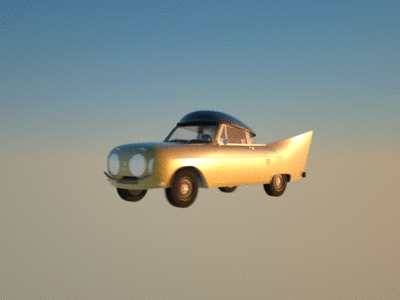

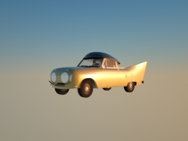

Here's a turntable animation of "Mr Beep" rendered with the script so it works (at least on my machine ;).
Mr Beep rotating
Mr Beep rotating
turntable action
turntable action

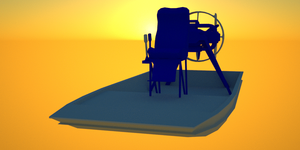

Here's a script to capture the previews. Select a render target node and run it (of course you need to modify the path). It will output all the intermediate results on disk. I created an animated gif from them with ImageMagick. ImageMagick has Lua bindings so I'm sure you could do this directly from the script.
Code: Select all
-- get the selected render target
rtNode = octane.project.getSelection()[1]
function renderCallback(result)
    -- create the filename (MODIFY THIS)
    local fileName = string.format("/tmp/airboat/result_%d.png", result.samples)
    print("saving image: ", fileName)
    -- save the intermediate result
    octane.render.saveImage(fileName, octane.render.imageType.PNG8)
end
-- start rendering
octane.render.restart()
octane.render.start{ renderTargetNode = rtNode, maxSamples = 500, callback = renderCallback }
created from the previews, not much to see because it converges almost immediately on this simple scene
