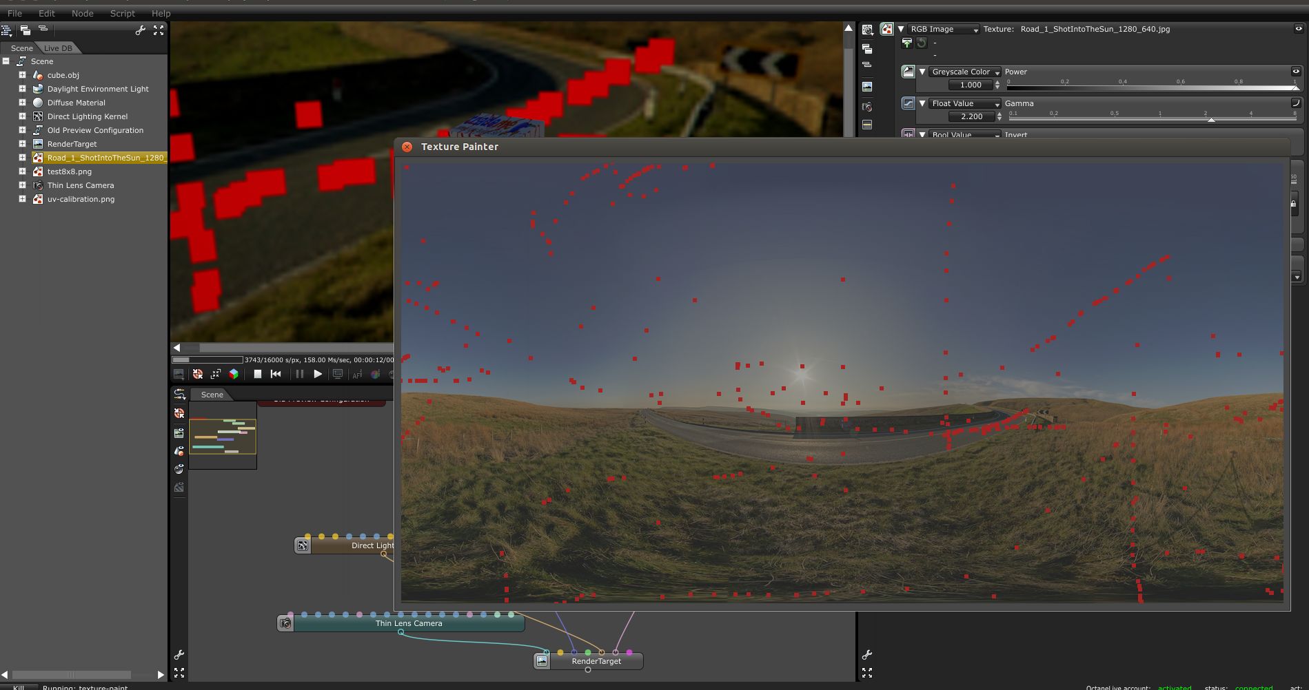

In release candidate 1.25, we replaced the IMAGE_LABEL by the BITMAP component. The BITMAP component is like a paint canvas that can react to mouse events so you can write some pretty cool scripts with it. The bitmap is low-level (pixel level) so it may be a bit cumbersome. But because it's so low level it would allow you to do some pretty powerful stuff (e.g. creating your own components, draw paths, display the scene, ...).
In this example we do live texture painting. Just start rendering something, select a texture node and start the script. Now you should by able to paint some stuff on your selected texture. You can also use it to paint a texture environment. This is a proof-of-concept, not a production stable script!
First, the selected texture's buffer is loaded in the bitmap. Then we show the bitmap in a window and start listening for mouse events. When the mouse is dragged on the bitmap, we draw a red square in the bitmap and update the texture's buffer with the red square. Important here is the call to octane.changemanager.update(), each time you want to see your changes reflected in the current render, you should call this function. (The idea is that you make all your changes and then call this function once to optimize things).

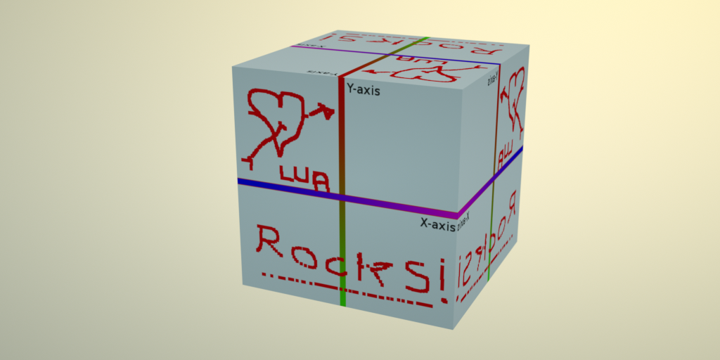

Here's a result of my artistic skills:
texture painting
texture painting
my skills
my skills
