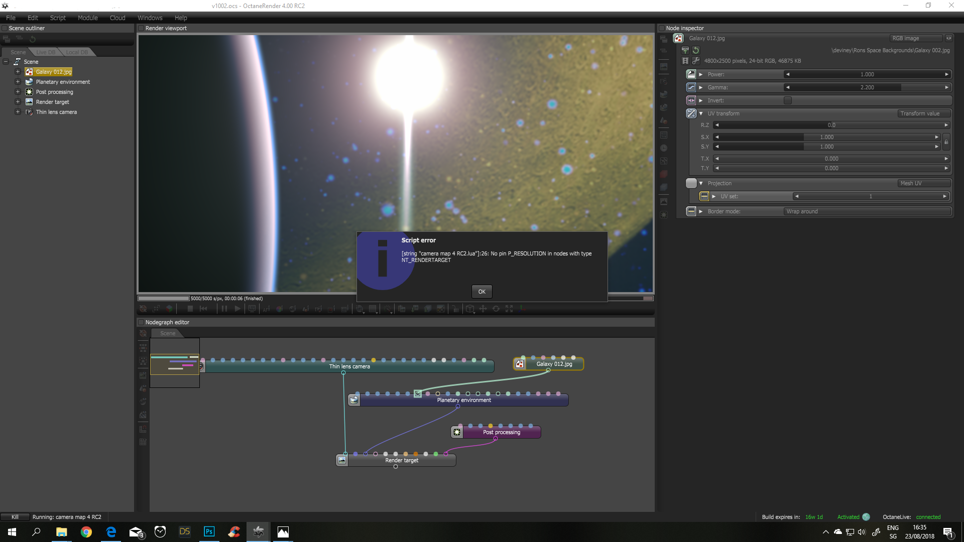

Reading a comment in another thread reminded me of this script.
Redowloaded the script posted in the first post and tried to apply it to an RGB image texture connected to the Starfield in OR 4 RC2.
My idea was to have the starfield texture to just match the viewport.
This triggered the script error message:
:26: No Pin P_RESOLUTION in nodes with type NT_RENDERTARGET

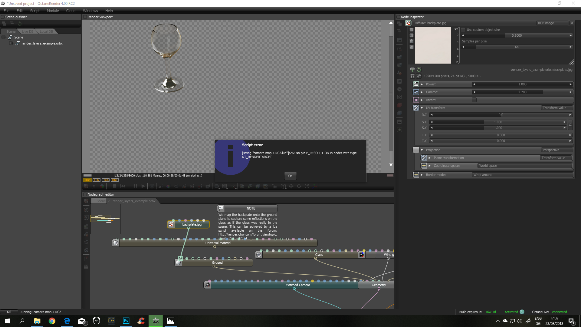

I get the same error message when trying it with the provided orbx of the Render Layer example:
viewtopic.php?f=51&t=44267

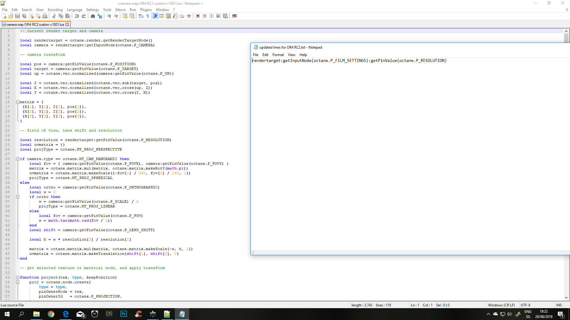

roeland
Posts: 1826
Yes those parameters changed a while ago, you get the resolution as follows: rendertarget:getInputNode(octane.P_FILM_SETTINGS):getPinValue(octane.P_RESOLUTION).

roeland wrote:Yes those parameters changed a while ago, you get the resolution as follows: rendertarget:getInputNode(octane.P_FILM_SETTINGS):getPinValue(octane.P_RESOLUTION).
Thank you for helping out even though you may have more urgent matters at the moment.
It seems it is line 24 that needed updating:
before:
Code: Select all
local resolution = rendertarget:getPinValue(octane.P_RESOLUTION)
after:
Code: Select all
local resolution = rendertarget:getInputNode(octane.P_FILM_SETTINGS):getPinValue(octane.P_RESOLUTION)
My experience with scripting is very basic...

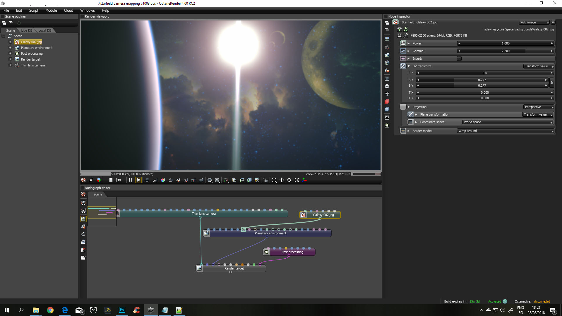

It seems to have worked. No more error messages and I can use the UV transform to scale the starfield image.
scene after applying script and UV scale transform
Attached unofficial updated script for OR 4 RC2 based on the 1.30 script from roeland.
