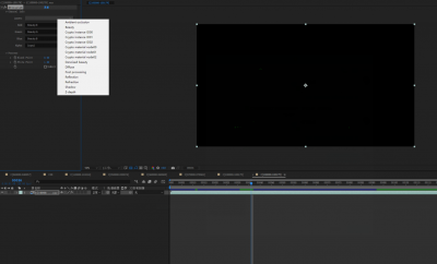

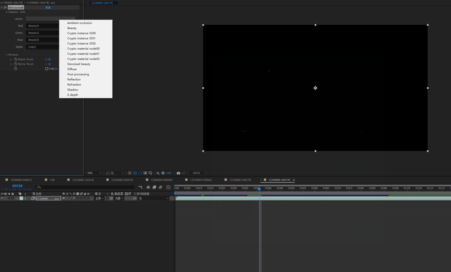

Hello everyone, I am using Octane Render version 2022.1-R8 in C4D. In the same scene in C4D, there are four cameras connected to the stage with identical materials, render settings, and render parameters. AOVs are rendered as EXR files using Octane and imported into After Effects using EXtractoR. However, the second camera does not display the Beauty, Denoised Beauty, and Reflection channels, which appear as black. When rendering as a single channel in PNG format, they can be displayed normally. When using Cryptomatte, different colors can be displayed normally. However, when I split the four cameras into four separate C4D projects and render them separately, the channels can be displayed normally. Is this a bug? If it is, which version of Octane Render has a more stable Cryptomatte channel?
Posts: 10619
sorry, I'm not an AE user, but please, remove the installed c4doctane version and upgrade to 2022.1.1-R5:
https://render.otoy.com/customerdownloa ... ed_win.rar
If not enough, and since it seems a setting issue, please write to help at otoy dot com, so we can better investigate what is going on with your scene.
