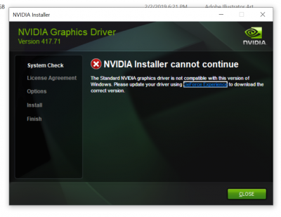

I followed all the instructions but Windows won't allow me to install 417.71. Any hope of getting this fixed soon? Losing a lot of time

Any update on getting this fixed? I am going on day 3 with no renders. Windows will not allow me to install 417.71 and I followed all the instructions. Don't want to do a complete reinstall of everything.

msc4058 wrote:Hello,
Matt
Hi Matt,
if you are running under Windows 10, you could disable automatic windows 10 update, then install 417.71 Nvidia drivers.
To get an effective Nvidia drivers installed, please use DDU Nvidia unistaller drivers, the best way to get a clean installation.
http://www.guru3d.com/files-details/dis ... nload.html
Regards
Paride
msc4058
Posts: 6
Joined: Thu Feb 09, 2017 5:11 pm
Thank you so much for your reply. Nothing is working.

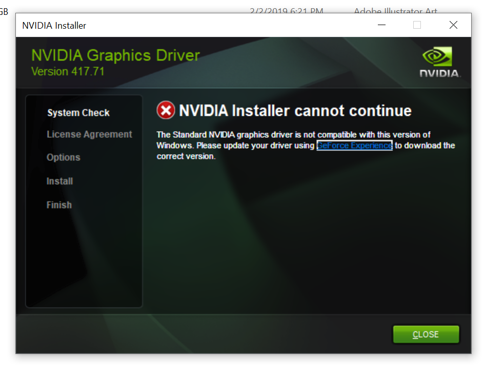

1. Started in SafeMode
2. Ran DDU Nvidia Unistaller
3. Downloaded Nvidia 417.71 installer
4. Error on install (See photo)
Windows 10, version 1809
msc4058
Posts: 6
Also turned off Auto update
paride4331
Posts: 3975
msc4058 wrote:Also turned off Auto update
Hi msc4058,
do you own a Nvidia Quadro series? model?
Regards
Paride
