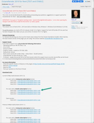

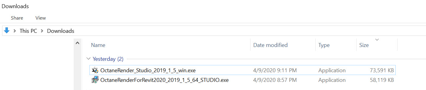

Hi Faceoff,
Thanks for getting back to me. I have the studio license with 2 gpu limit. Please see attached screen captures. First shows the page I downloaded it from (green arrow). Second shows the downloaded files on my computer. I can download a earlier release if you want. My only requirement is it should install on Revit 2020 without admin rights and export to standalone.
Thanks again for all you help,
Azims

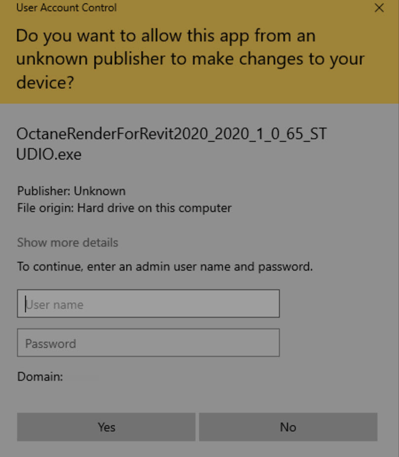

Hi - I think I have found a solution. Are you able to try the following installers please?
https://render.otoy.com/customerdownloa ... STUDIO.exe
Paul
Paul
Hi Paul,
This works. Thank you very much. I have one follow up question. Is it also possible to get the rhino plugin without admin rights? Finally, (I promise this is the last request) is it possible to get octane standalone installation without admin rights? Many time I need to combine pieces of the model from both platforms and standalone serves that purpose.
Thanks you once again. This makes my life so much easier.
Azims
