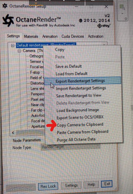

I am trying to save camera positions for different views with in the pluging.
At the moment I save render target and then export render target.
This method doesn't work when I try to import back my camera positions
Is there a way to save camera locations?
If yes then am I doing something wrong?

I am not clear on the exact process you are using. Can you provide some more detail and screenshots pls?

I export render target from the plugin using render target export option.

come to think of it..
you have an option under the render target in the plugin which is called "copy camera to clipboard"
Can we get another option which would be 'export Camera location from clipboard"
cheers

If you can provide screenshots of the problem you are having, I can try to help you.

Here you go
to clarify
What I was hoping for was to walk around in octane plugin and snap views, export the camera locations and when needed import those positions for say a re render

The "Export Rendertarget Settings" saves in a format that is not recognised by Octane Standalone, and does not normally save the camera position (although I /may/ if you have viewport navigation enabled) - so try that. But I think the easiest solution is to add views in Revit for each camera position you want to render.

another workaround is
from clipboard paste to txt document
when needed
copy from txt doc to clipboard
paste from clip to camera
works for me
I find walking around plug in lot easier
