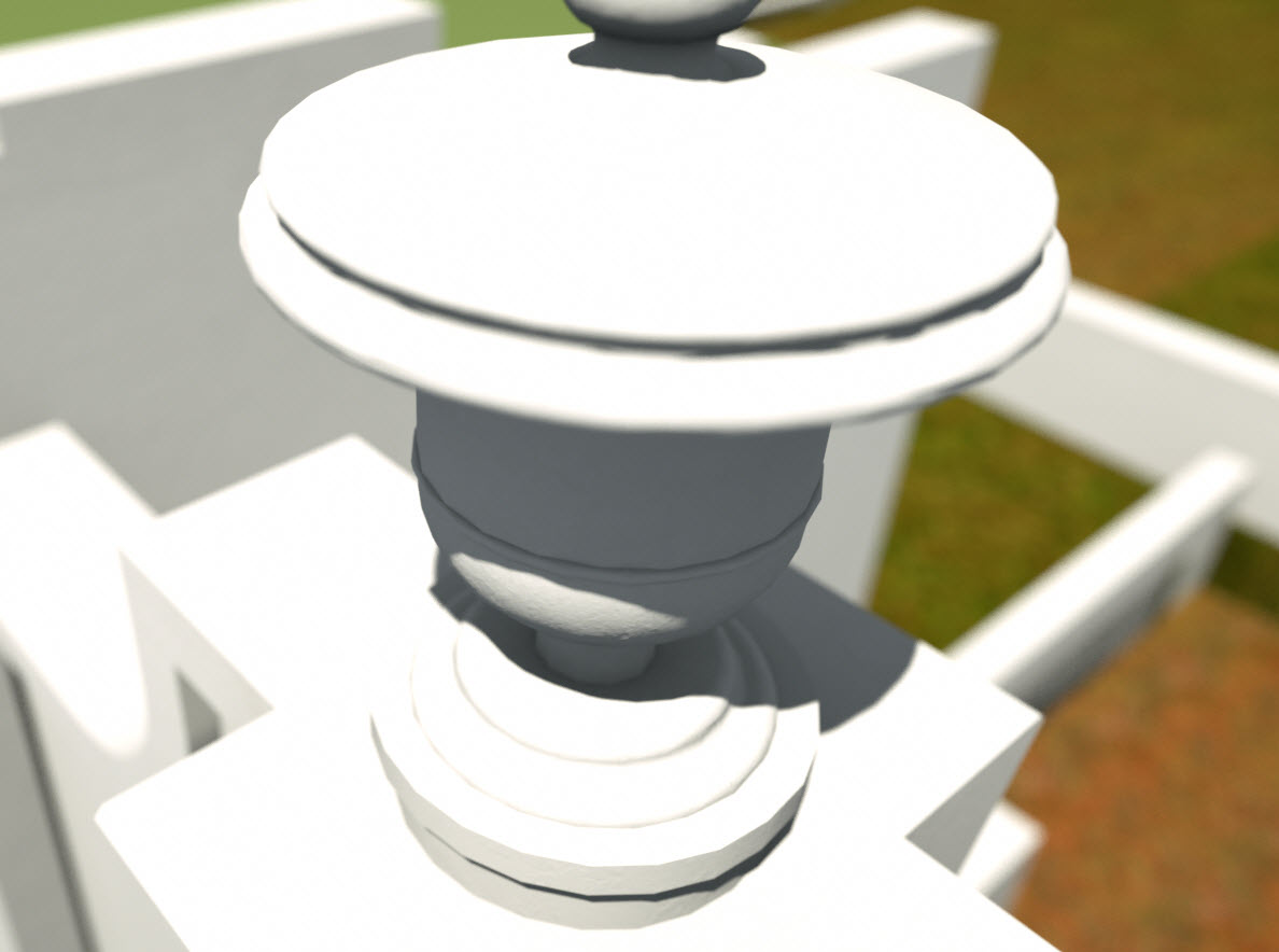

Hi Paul,
Turns out Revit has a terrible faceting problem... And I can find no way to increase facets (if someone knows, by all means enlighten me!). The strange thing though is that 'smoothed' for the material is ON in Octane and while it improves it a lot, I still see the facets. I tried setting Triangulation Level to 1 and reloaded the model to no avail.
Any idea why material smoothing does not solve this?

Hi Paul,
face_off wrote:Seeker, there are two option here. 1) The vertices of each polygon are not joined (is in effect, each polygon is a separate mesh object and therefore smoothing is broken). I doubt it is this one....or 2) More likely it is a rayepsilon issue. Try reducing the rayepsilon - since the default is set for larger render areas.
I don't think the vertices are broken. It's created with Revit' Revolve tool, which i think is pretty solid & simple. It's not a rayepsilon issue either since that was the first thing I checked. It turns out that Revit does not allow any control over the vertices count - possibly to save memory? I found a number of others online identifying this issue.

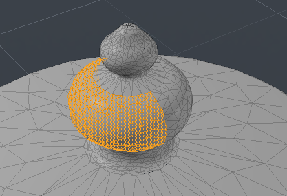

Seeker - I had a look at that model. In summary, it's material is "Default", and has smoothing OFF. So turning smoothing ON, Set a very low ray epsilon (0.00001), and it renders OK, although because of the way the geometry is constructed - there are a number of different non-connected pieces to that geometry, which create problems. The lid is not connected to the body. And each of the tiers in the base are not connected. Because of these disconnected surfaces, you cannot subd to improve this. As an experiment, export to OCS, then load the exported OBJ into a modelling app - then you can see all the different pieces.

face_off wrote:Seeker - I had a look at that model. In summary, it's material is "Default", and has smoothing OFF.
That's because I copied and copied that element out of the model and pasted into a separate file. As you will see, the image I posted is not the default material and smoothing was ON.[/quote]
face_off wrote:So turning smoothing ON, Set a very low ray epsilon (0.00001), and it renders OK,
I played with ray epsilon but the best result I got was what I posted. I would appreciate if you could post an image of the smoothest render you get on that.
face_off wrote:although because of the way the geometry is constructed - there are a number of different non-connected pieces to that geometry, which create problems. The lid is not connected to the body. And each of the tiers in the base are not connected. Because of these disconnected surfaces, you cannot subd to improve this. As an experiment, export to OCS, then load the exported OBJ into a modelling app - then you can see all the different pieces
That frustrates me. I used the native revolve tool out of Revit. It's a mature modelling application. Why they create poor meshes is beyond me!
