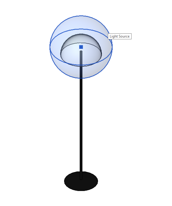

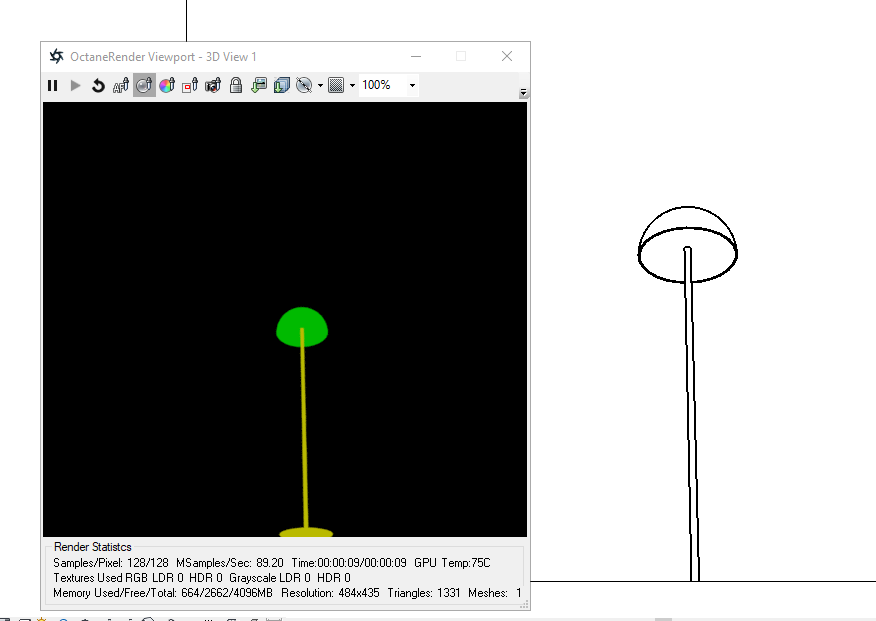

What do you mean by a "rectangular light" please? I don't see these as options in Revit. My understanding is that light sources come from the Family->Lighting->Architectural->Internal->Floor Lamp, etc. These objects do not provide geometry when accessing via the Autodesk recommended geometry access method (the IExportContext). You can see the Family display of the light here...
Yet the geometry provide by Revit is clearly missing the light emitting geometry.
It seems people are trying to export the light, without the Light Source Geometry. Would it not be easy to export just the light geometry and use that?
They are using a completely different method to access the light geometry to what the plugin uses. The plugin uses the method recommended by Autodesk at https://thebuildingcoder.typepad.com/bl ... orter.html which for me is not returning any emitter geometry.
