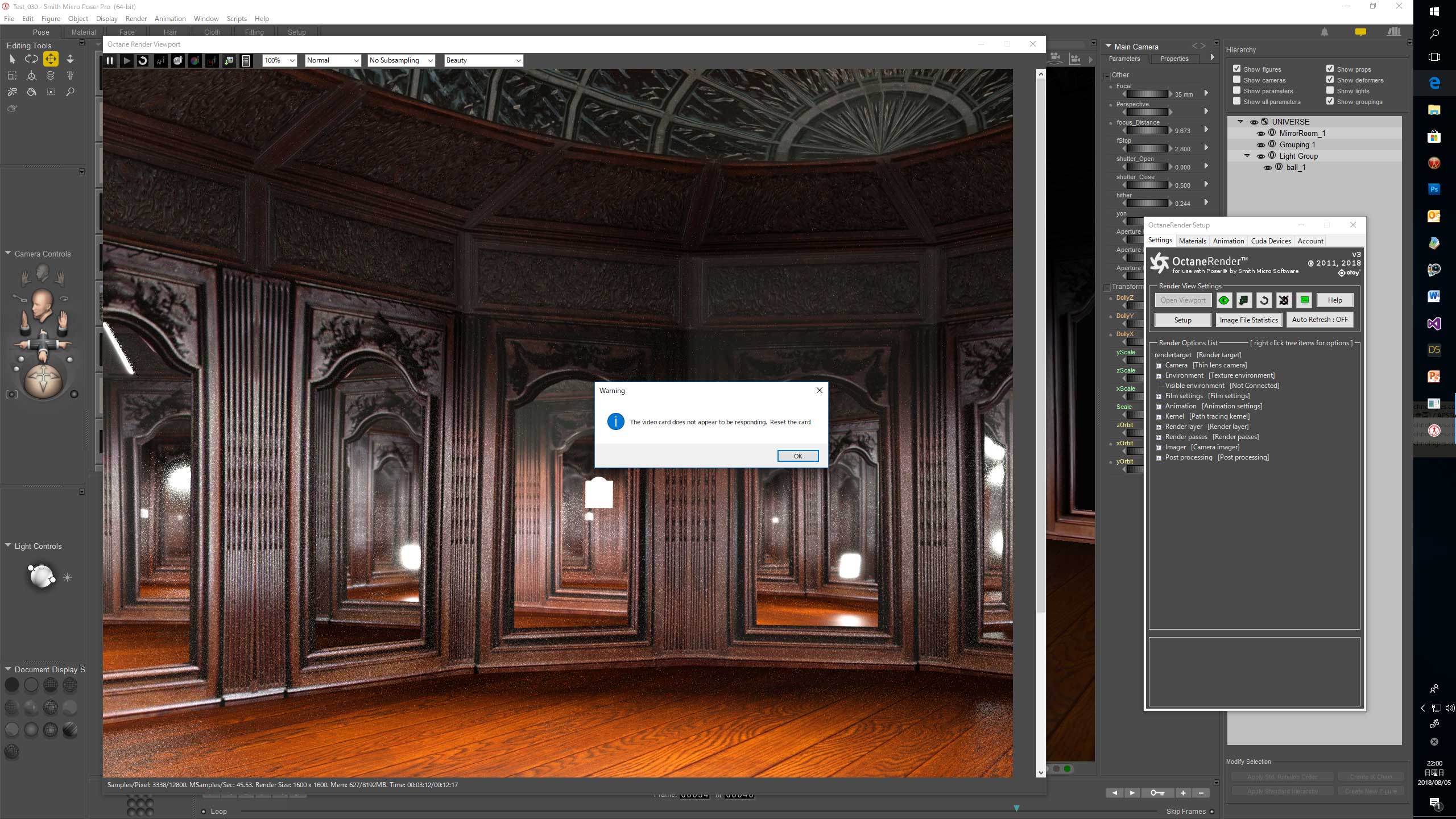

From V3.07, I meet offen trouble that "The video card dose not responds."
But it is not always, it is some time.
Case of animation rendering, first frame can render complete, but second frame get this trouble very offen.
From V3.08.2, this trouble is always, dose not rendering complete, because always meet this trouble.
This trouble same as PMC and Path Tracing.
At the first, I feel this is trouble of hardware, but I found that this trouble has linkage of parameter that Kernel - Parallel Samples, case of 1, it is less trouble than case of 8 or 16.
I feel this trouble is not hardware, may be GDP software.
If you need this sample of scene, I can submit this, please inform me.

This trouble occurs during rendering.
The timing of occurrence is irregular and may occur immediately or in some cases after rendering approaches max sample.
Once in this state, I can save the rendering result so far, but the image will not be saved.
Also, even if it is reset by Cuda Device Tab, it can not be restarted and it can not be processed unless it is rebooted.

Case of Version 398.82, I meet following error on Octane V3.8.2.
I feel Octane V3.7 is more working.
Octane stop same error.
by View Log
Started logging on 10.08.18 02:11:36
OctaneRender 3.08.2 (3080200)
CUDA error 715 on device 1: an illegal instruction was encountered
-> kernel execution failed(kernel25)
CUDA error 715 on device 0: an illegal instruction was encountered
-> failed to launch kernel(kernel34)
device 1: PMC kernel failed
device 0: PMC kernel failed
CUDA error 715 on device 2: an illegal instruction was encountered
device 2: PMC kernel failed

I meet this trouble, it is Just same timing of new lighting set up of sense.
It is small portion of environment light with 3 Spot light as Main, sub and Back.
This 3 light has link with one Group object, it is always change by camera direction.
This sense has rot of trouble in animation, it has change camera position each flame and change change light group direction.
I use Octane Render Animation rendering with reload all of information on each frame, and I meet this trouble , may be 2-5 frame later. Some time it is make system clash or Poser abnormal end. Specially, change camera X rotate, this trouble must be occur.
Some time, Octane View port is just white or noise on first frame, this mean Octane Render missing rendering all.
Case of this trouble, Windows is quite unstable, if I will try again it, Octane has no response or Windows Clash(50%).
And, if I dose not use animation rendering, it mean that I make situation on Poser, I bring up Octane for Poser, and I push Button of ViewPort, this case is more stable but I meet same trouble some time. This case, I will stop rendering it by manually, and I increase frame no on Poser, I push reload button on Octane for Poser, this is manually control animation rendering.
The Previous version of Octane is more good result than newest version, because newest version can't rendering until complete that is 6400 samples. May be 30% proceeded, I meet this trouble.
I test older lighting setup, it is stable, it is fixed lights.
I feel that octane has some trouble with Lighting setup or under animation control.
This situation of sense is a little of " sexually explicit scenes of characters", therefore I can't upload here directory, I must test minimum configuration with out characters, may be it need 1-2 days. Therefore I will try it by request, if support stuff need this troubled sense, please inform it.
