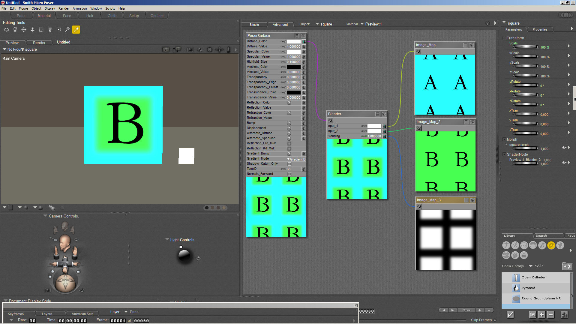

So .. i have 2 texture (A + B + picture mask) in poser node and linked to morph dial. When morph is "0" i see only texture A, when the morph is "1" i see texture B.
When render it with poser render not have problem, but i want see the same effect with Octane, is it possible ?

Hi Paul, so this is a example ...

i have found the solution.., i need remake the node in octane with "Mix tool" because poser octane plugin not converter the "blender node" ...
