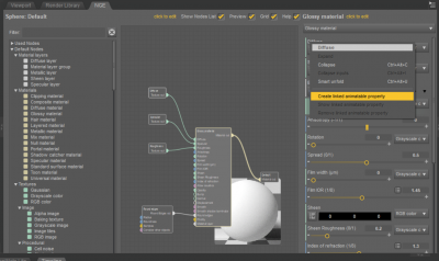

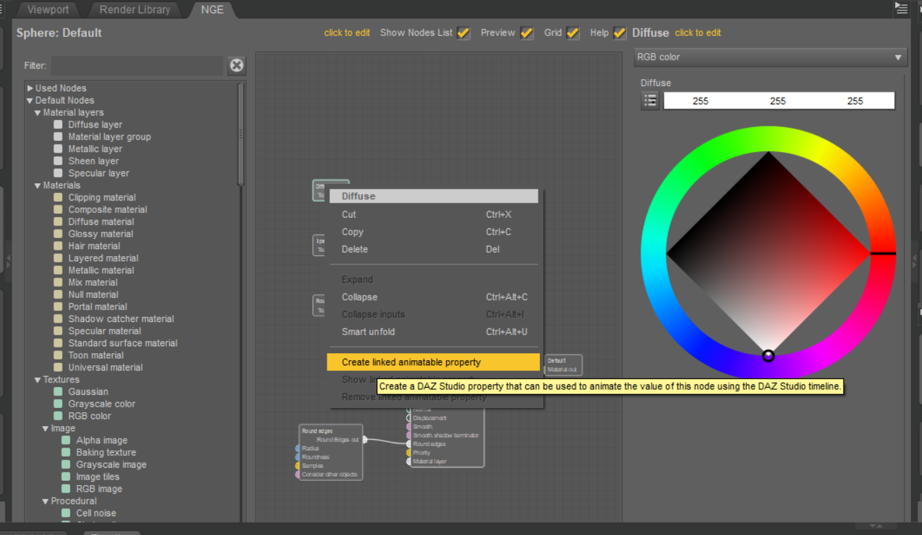

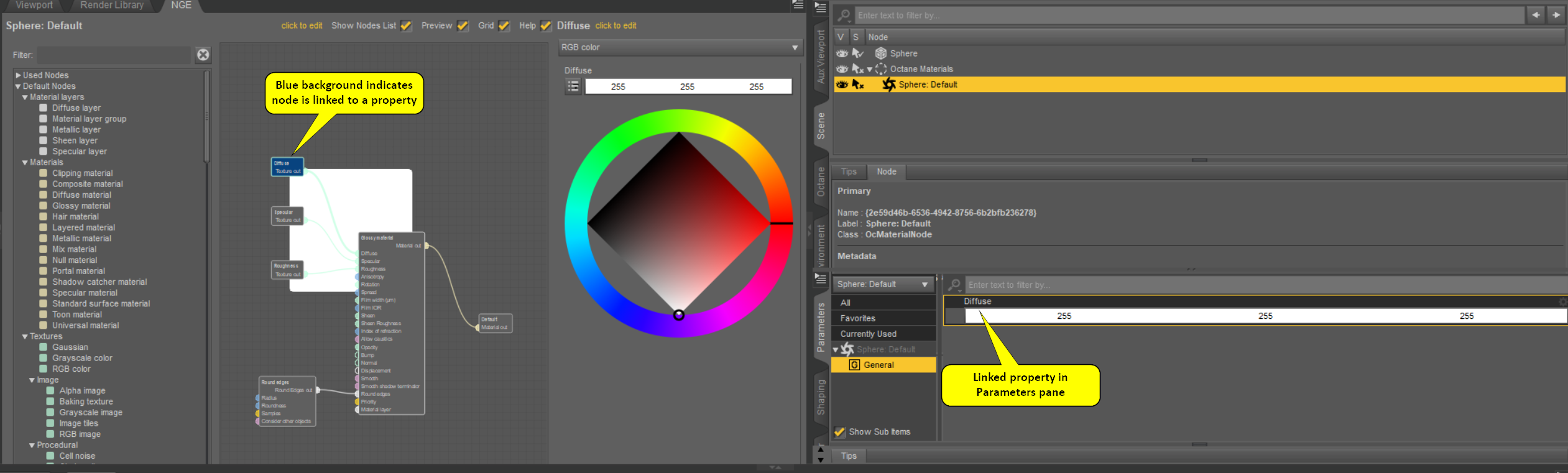

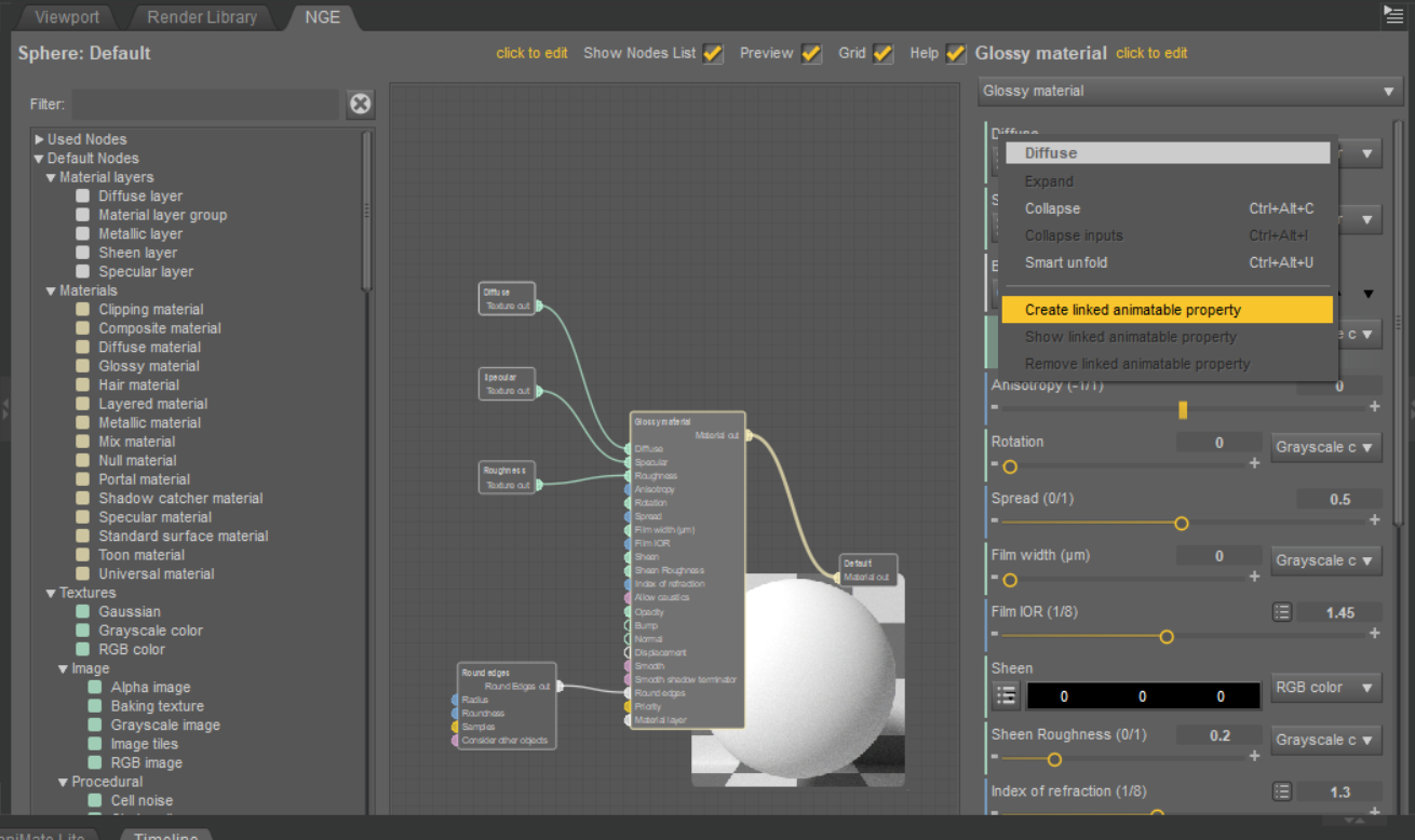

    You can create a linked property by right-clicking the node in the node graph editor or the node background in the node editor.
    Note that only expanded nodes can have linked properties. An expanded node is one that has its own box in the node graph editor. Nodes with linked properties are shown with a blue background in the node graph editor.

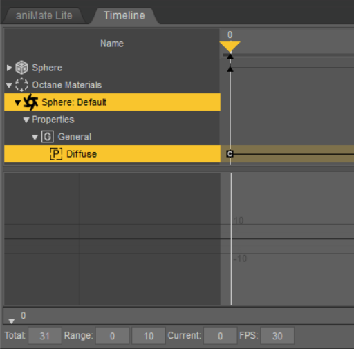

    When a linked property is created, it is shown in the Parameters pane and can be found in the Timeline tab.
    Once a linked property exists for a node, any changes made to the node's value are reflected in the property and vice versa. This means that editing the node's value using the Octane node editor will create an animation key at the current scene time. These automatically-created animation keys can be edited using the DAZ Studio Timeline pane.

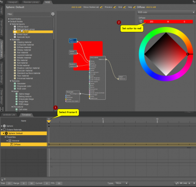

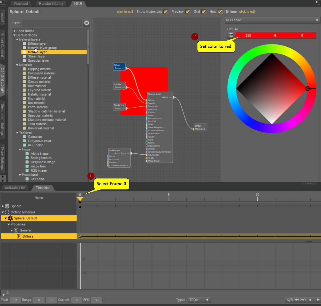

    To illustrate this, lets make our sphere change color over time. We have already created a property linked to the diffuse color node in the sphere's material, so all we have to do is to set different colors at a couple of different times and DAZ Studio will interpolate the color at intermediate times.
    First, we set the color to red in frame 0:

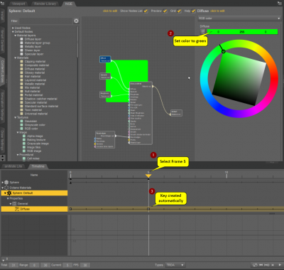

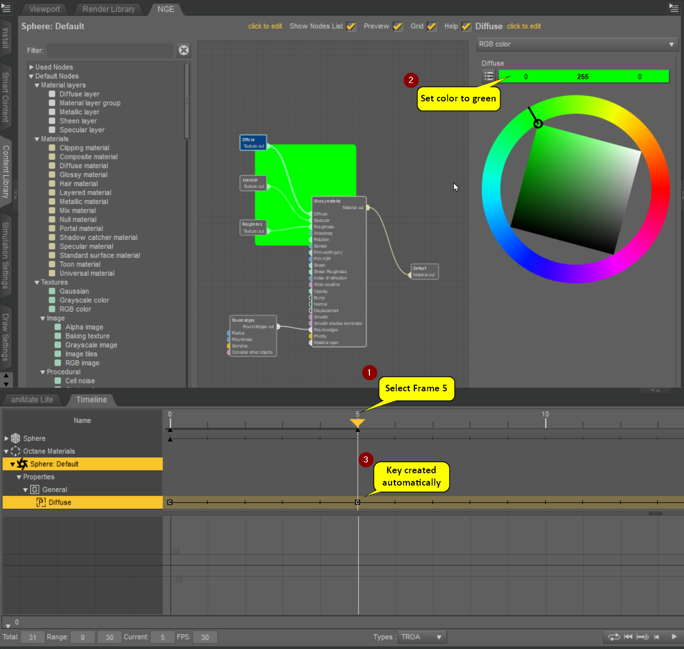

    Then, we set the color to green in frame 5:

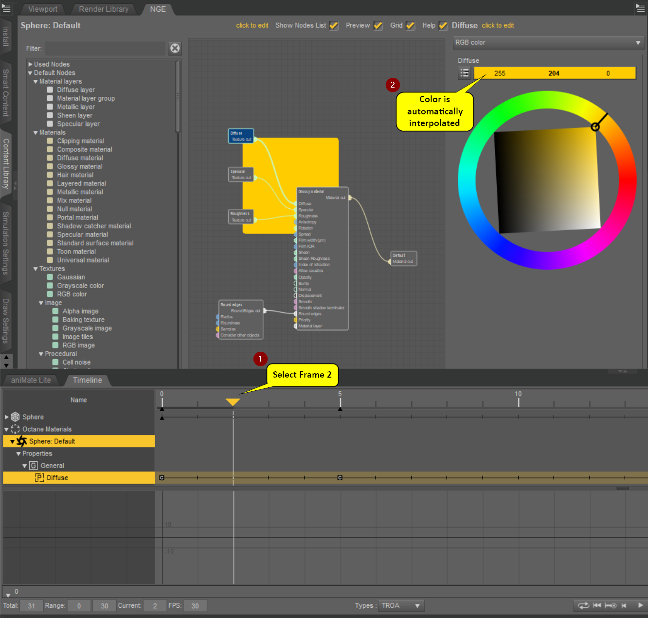

    This results in two animation keys being created for the linked property, at frames 0 and 5. Selecting a frame in between those frames will cause DAZ Studio to interpolate the color:
