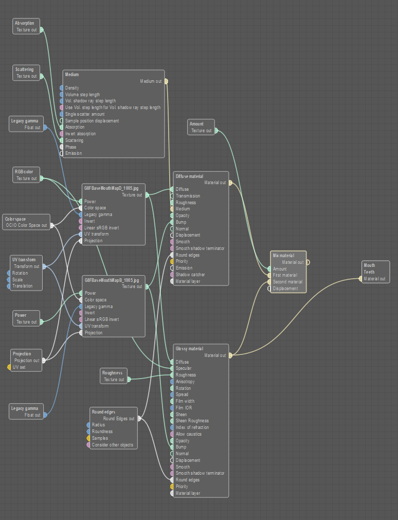

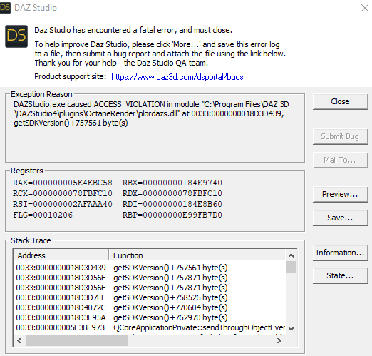

Still getting crashes on Collapse Inputs (On the Mix material node in this case). I had another one a few days ago on a auto generated emitter material, but forgot to save the crash report.
DAZStudio_error_report_230212-000121.zip
(157.15 KiB) Downloaded 188 times
toby_a
Posts: 261
Joined: Tue May 10, 2022 11:59 pm
SiliconAya wrote:Still getting crashes on Collapse Inputs (On the Mix material node in this case). I had another one a few days ago on a auto generated emitter material, but forgot to save the crash report.
Thank you for the report. I can reproduce the crash and it'll be fixed in the next release.
