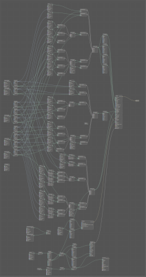

This might be an unpopular opinion, but before any other new nodes/features get added could the UI lag be looked at? With each addition (nodes, etc) the UI gets slower and slower, it's not uncommon to have a second or 2 delay for the UI to update when using the NGE or just selecting a material in the Materials tab.
An extreme example is this skin material I made back at the end of November, back then it had UI delays of 4 to 5 seconds, which was painful to use, but I could deal with it, now it's much worse, from selecting it in the Materials tab to having it responsive and usable in the NGE it can take over a minute and a half now. It's no longer usable because it's so slow.
Certain nodes seem to increase the lag more than others, for example the composite texture node, but the addition of more nodes/features to the plugin in general seems to be slowing the UI down.

SiliconAya wrote:This might be an unpopular opinion, but before any other new nodes/features get added could the UI lag be looked at? With each addition (nodes, etc) the UI gets slower and slower, it's not uncommon to have a second or 2 delay for the UI to update when using the NGE or just selecting a material in the Materials tab.
Hi, thanks for the report.
That does sound pretty annoying, to put it mildly. Would you be able to export that complex material as ORBX for me to have a play with? Feel free to DM me.

Thanks for sending me the material, @SilconAya. I can reproduce the slowness. Unfortunately, it's not going to be a quick fix. The problem appears to be primarily due to building the huge nested tree of controls that is shown in the node editor when the material or material out nodes are selected. I have an idea for how to fix this but it's going to involve a big change to how the code works. I have an idea for a change that might make it possible to use the node editor for large materials like this, but I can't promise I'll be able to do much in the near future.
