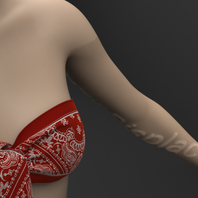

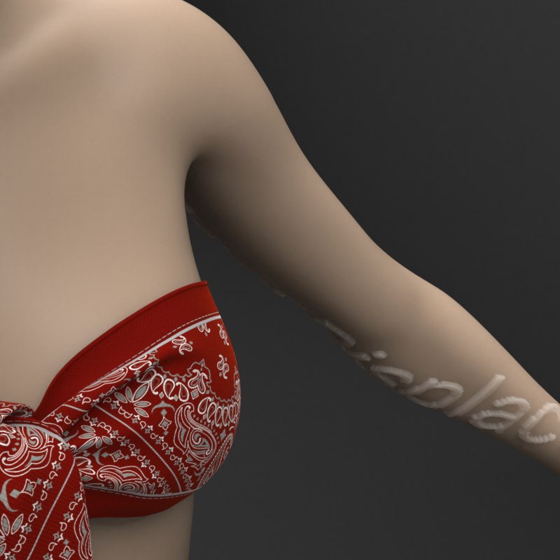

While I'm on a wish list, being able to use random walk and displacement together would be nice, as currently using displacement in a material that uses random walk results in the material tinting red. For example, if I add a displacement map to my random walk based skin material that adds wrinkles to the bottom of G8Fs feet, so they're not just flat, the entire leg surface/material tints red.
Are you able to share an example material, maybe in a simple scene, that shows this issue?
I've attached a super simple scene with a test displacement texture, you'll probably have to relink the texture in the arms material as I just chucked it in the zip.
The scene contains G8F with a basic flat colour random walk universal material applied and a copy of that material with the displacement added applied to the arms. In this case the arms are darker looking, but depending on the skin textures used it often looks both darker and red tinted.
Things I've noticed:
- I exported it as a orbx and opened it in standalone and the issue persists their, so maybe it's more of a Octane issue than a plugin issue.
- In the "texture displacement" node, the "level of detail" settings changes how strong the effect is, with smaller resolutions being stronger.
RandomwalkDisplacement.zip

SiliconAya wrote: I've attached a super simple scene with a test displacement texture, you'll probably have to relink the texture in the arms material as I just chucked it in the zip.
I've seen this as well. Unfortunately as you mention I think it's a core Octane issue with Texture Displacement + Random Walk Medium, not a Daz plugin specific problem. You may have better luck with the Vertex Displacement node instead (see images below). The caveat being that Vertex Displacement will require a high level of subdivision to look good.
