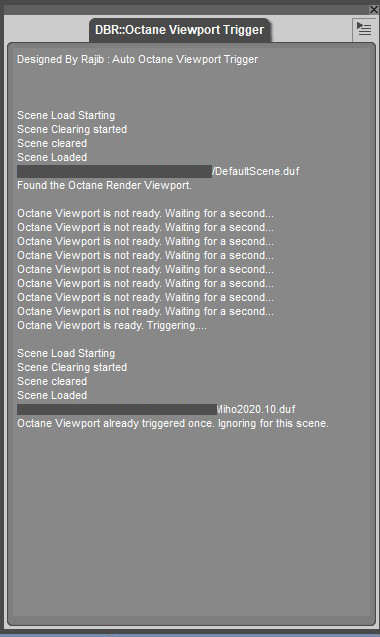

The Plugin also adds a pane DBR::Octane Viewport Trigger that you can open from Window->Panes (Tabs)->DBR::Octane Viewport Trigger. You can dock it if you want to. It will show the status of the Octane Viewport trigger:
You will see a couple of Octane Viewport is not ready. Waiting for a second... before it triggers. This is because when Daz Studio is started, Octane plugin takes a bit of time to complete the background activity before it makes the OctaneRender Viewport clickable. Hence it waits and checks and waits and check.... until it can trigger it. Once it is triggered, you will see the OctaneRender Viewport automatically open.

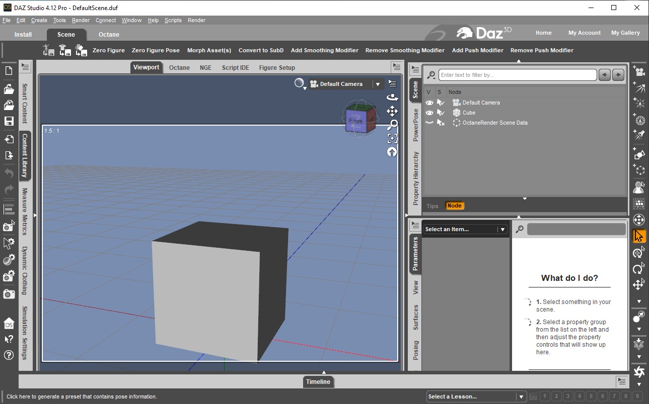

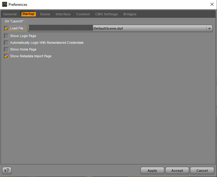

I did one additional thing. I added a cube primitive to an empty scene and saved it as the default scene that would auto load when Daz Studio was started. I added the cube as in some instances rendering the initial empty scene did not help with the crash. Even after the empty scene had rendered it had crashed on rendering the actual scene. But with the cube (or any primitive or object) in the initial scene I never faced the crash when I opened subsequent scenes. You can save the empty scene with the cube with some name (I used DefaultScene.dsf) and then via F2 or Edit->Preferences : Startup tick the Load File under On Launch and then from the dropdown select browse and select the Default Scene file you just saved. Then click Accept.
Following is my default scene that now gets loaded each time I start Daz Studio.

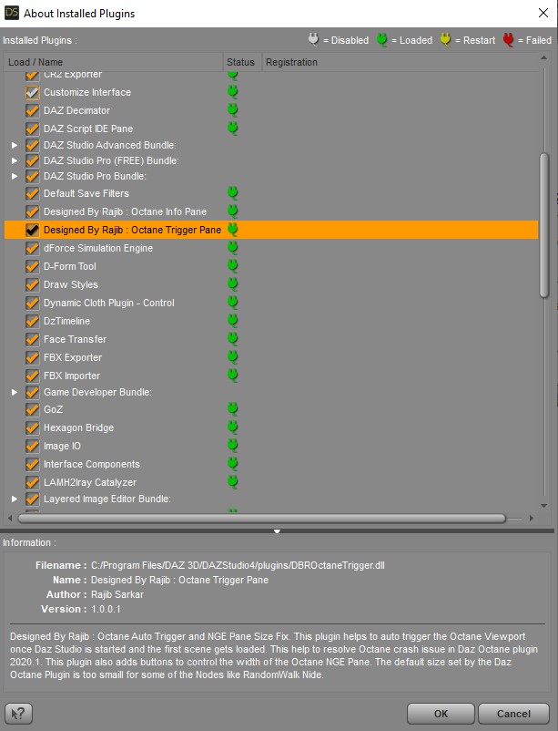

On successful installation, once you start Daz Studio, you can click Help->About Installed Plugin and check that it shows a green indicator against the Designed By Rajib : Octane Trigger Pane:

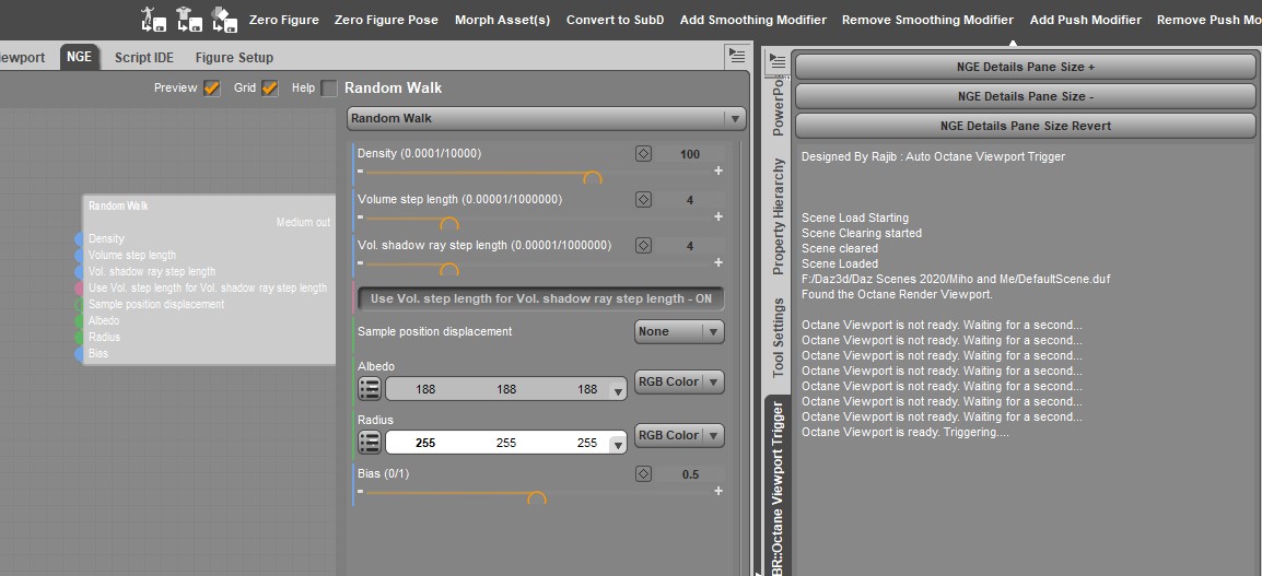

I have update my tiny Daz plugin DLL to also fix the NGE details cutoff issue for Nodes like Random Walk, Scattering, Absorption, etc.
Following is what happens when one of the above mentioned nodes is clicked : In this update under the DBR::Octane Viewport Tigger pane you will see 3 buttons :
NGE Details Pane Size +
NGE Details Pane Size -
NGE Details Pane Size Revert
If you click the NGE Details Pane Size + it will increase the size of the NGE details pane and it will resolve the cutoff issue. You can click it multiple times as needed. If you click the NGE Details Pane Size - it will decrese the size of the NGE details pane. You can use this if you by mistake expanded it too much.
If you click the NGE Details Pane Size Revert it will revert the size of the NGE details pane to the original size.
