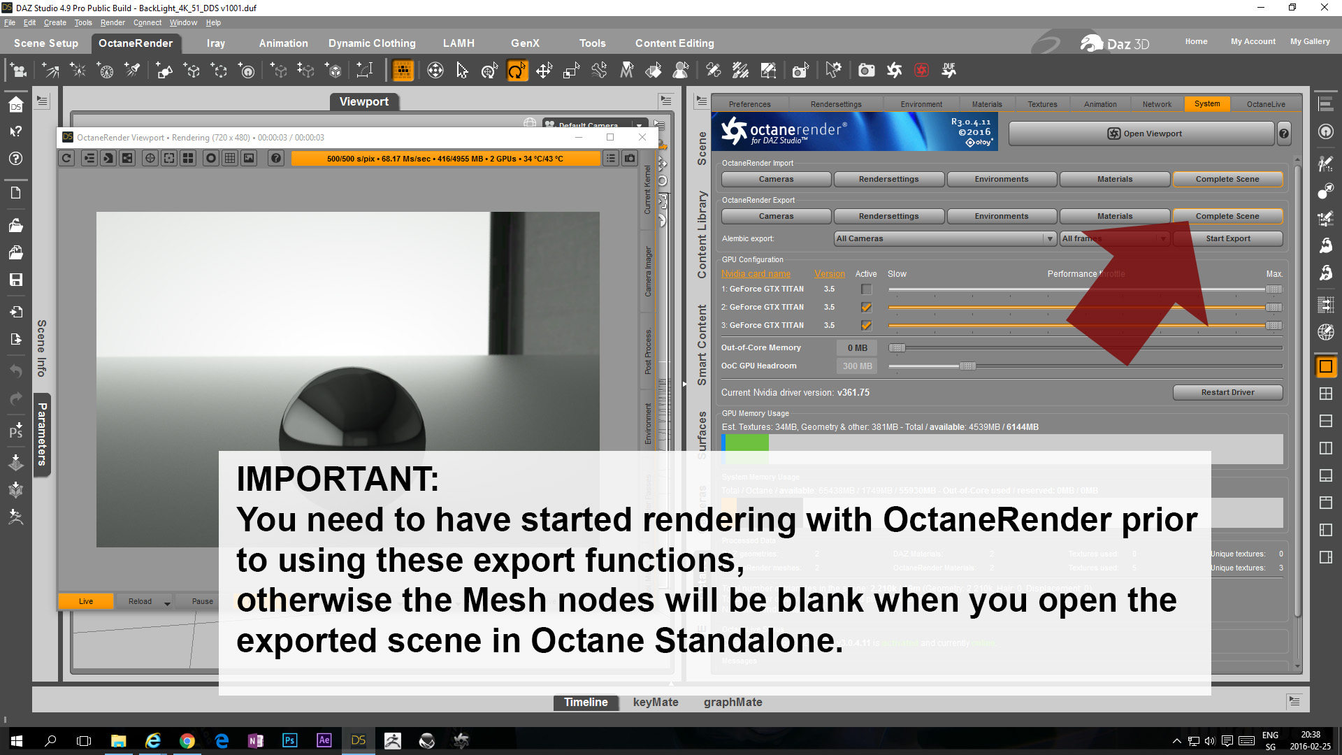

OcDS System Tab:
OctaneRender export - Complete Scene
- ORBX will create one compressed file including all geometry and materials.
- OCS will create a separate folder with the geometry in .obj form
IMPORTANT: You need to have started rendering with OctaneRender prior to using these export functions, otherwise the Mesh nodes will be blank when you open the exported scene in Octane Standalone.

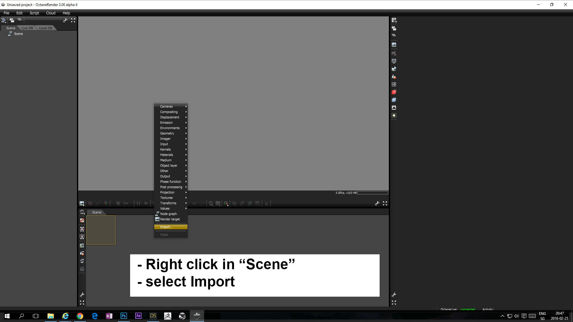

002 Right click - Import

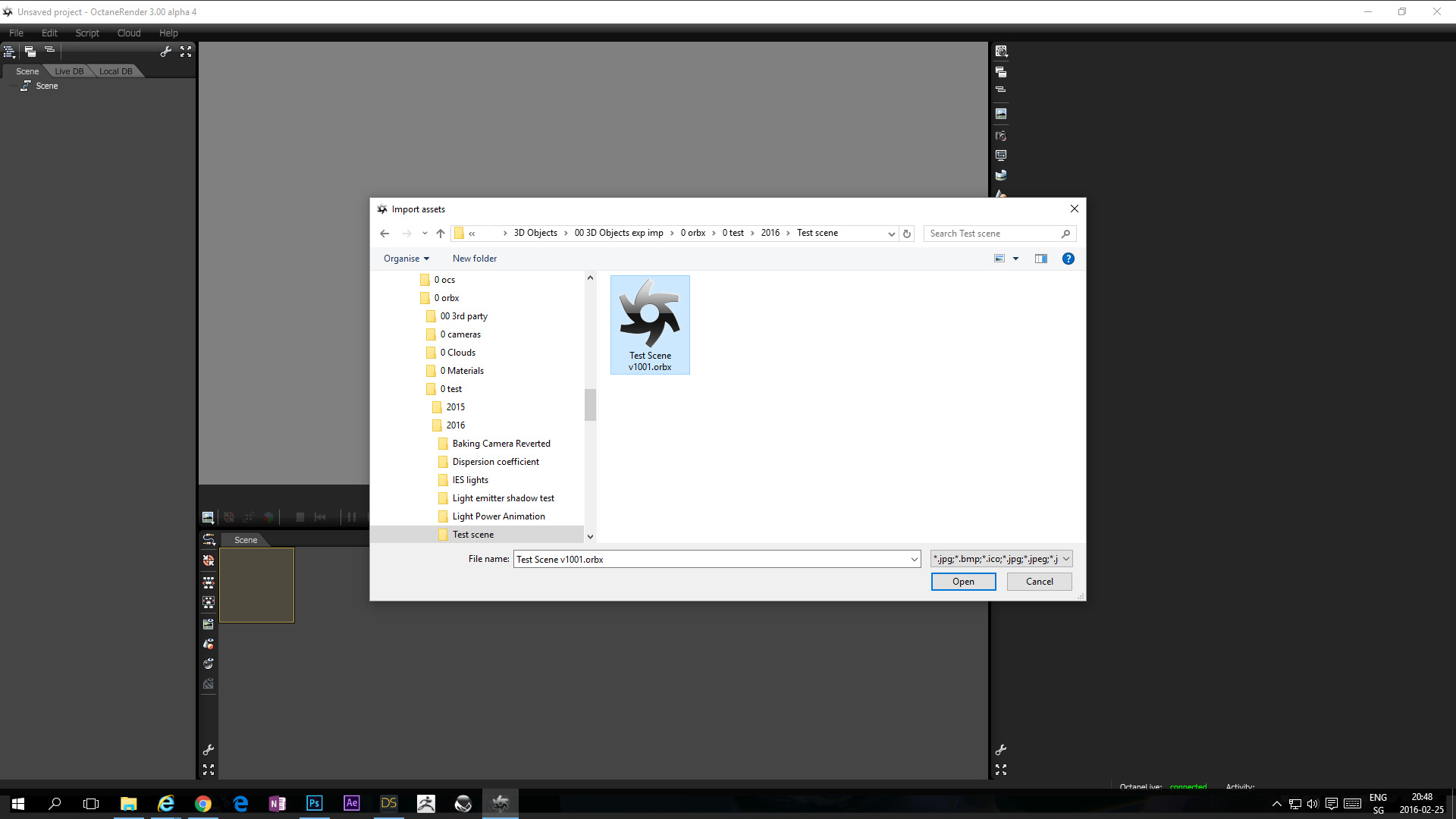

003 Browse to the saved ORBX or OCS

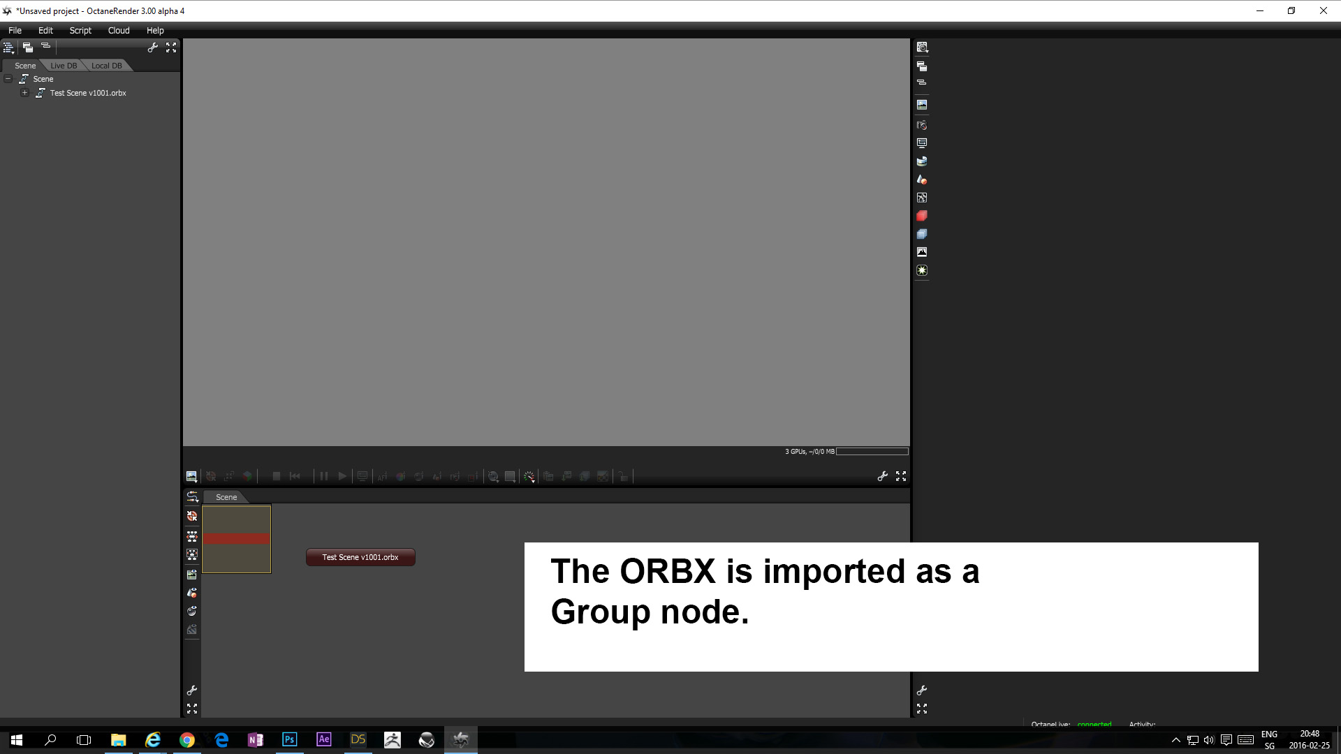

004 imported scene as group node

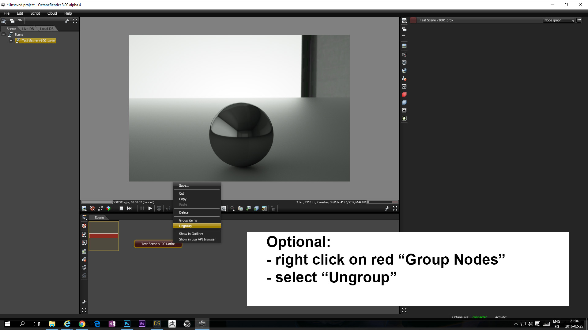

005B right click and select ungroup

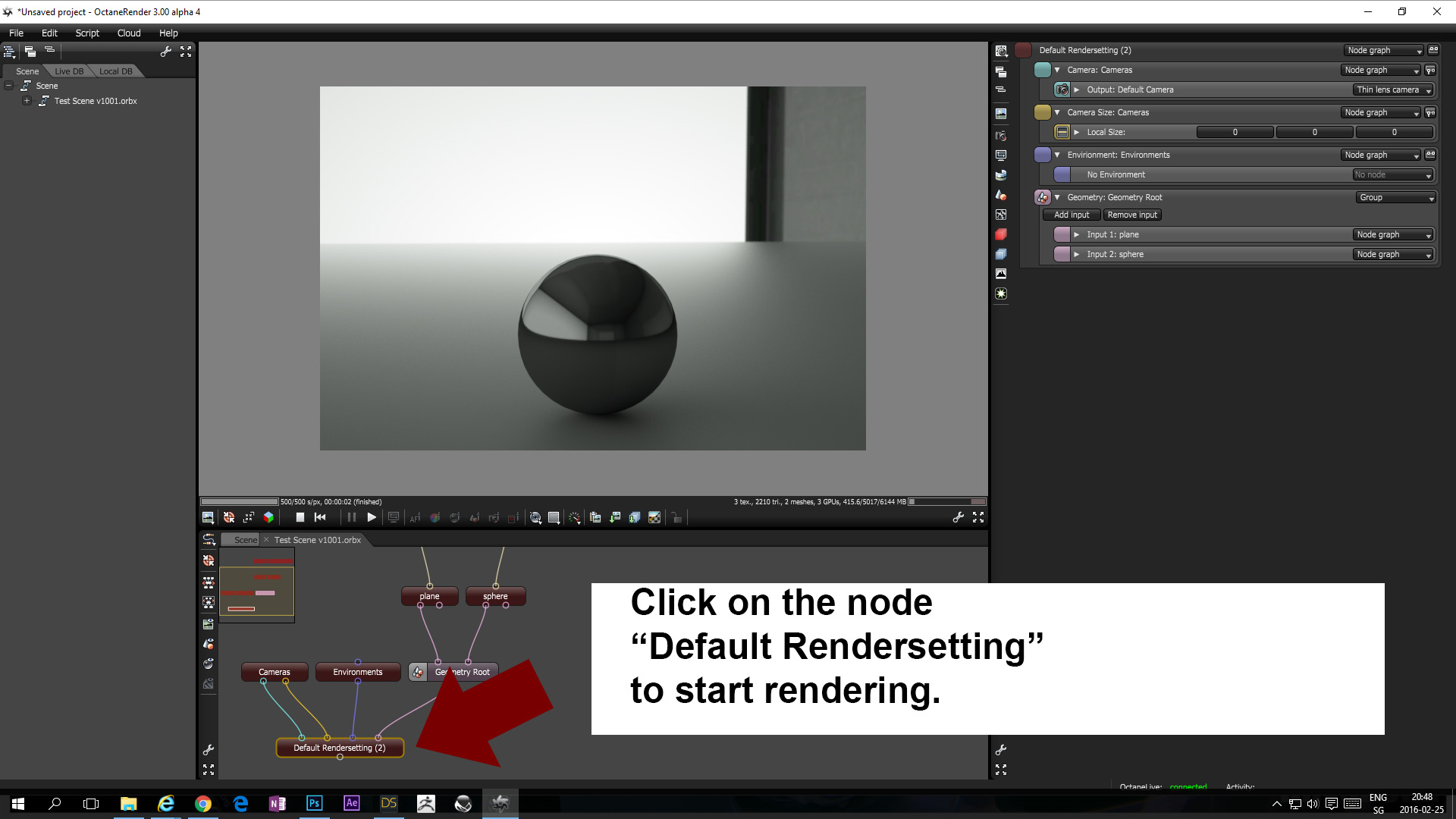

006 click on the Default Rendersetting node to start rendering
