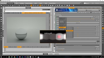

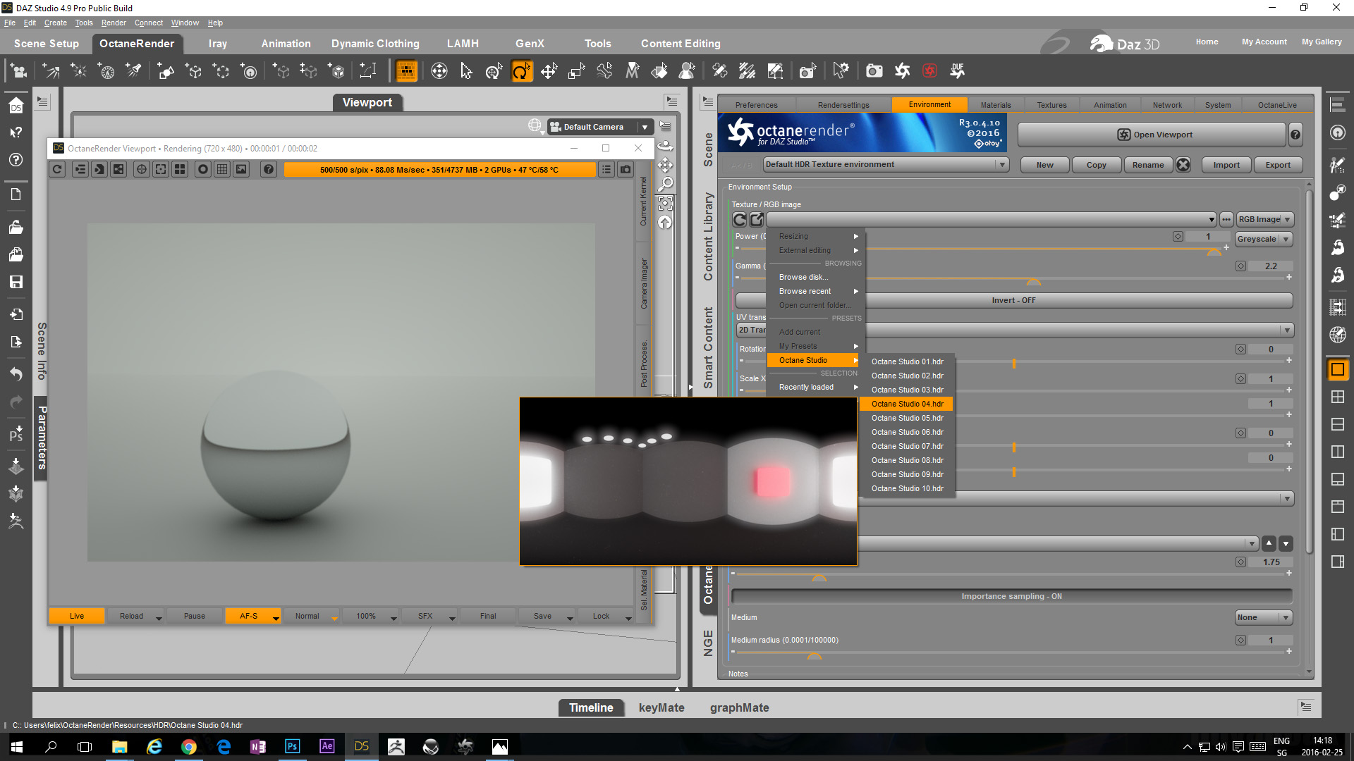

morphious2013 wrote:From the plugin, Environment Tab, clicking to ad an HDR the "Octane Studio" Presets option is greyed out. Could of swore I saw a Tutorial showing it being accessed.

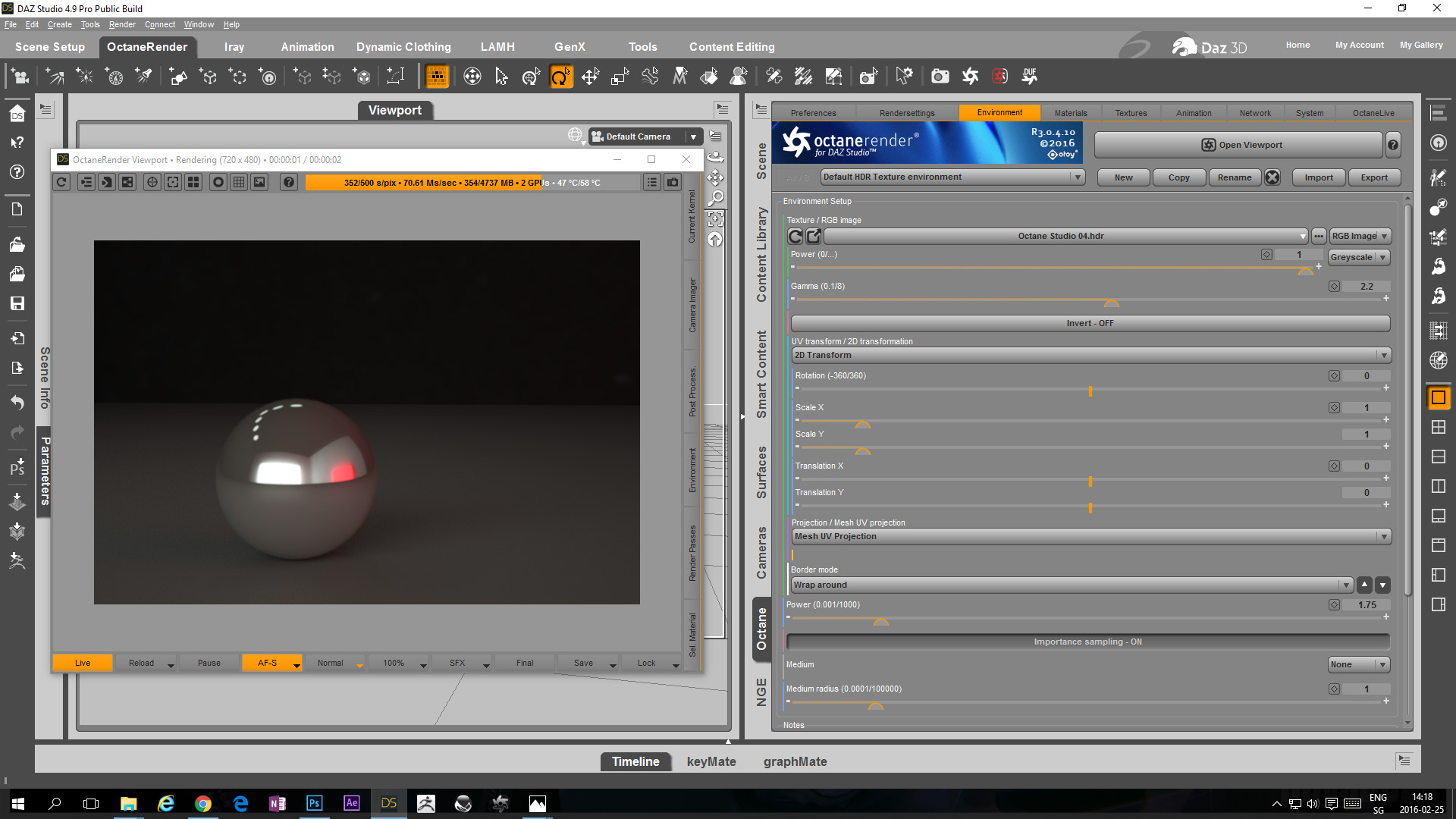

Here is a step by step created in OcDS 3.0.4.10 with Daz Studio Pro BETA 4.9.1.27:

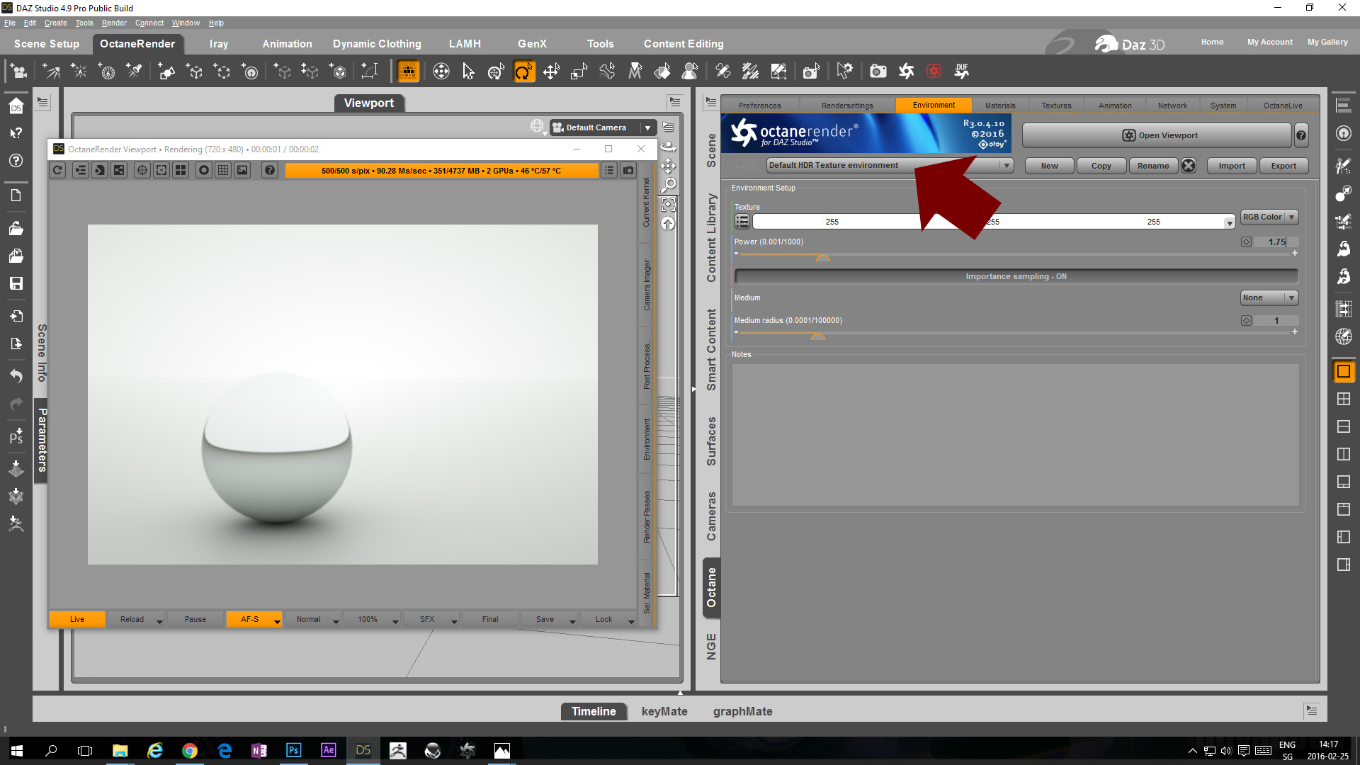

001 Switch to Default HDR Texture environment:
002 Switch from RGB color to RGB image:

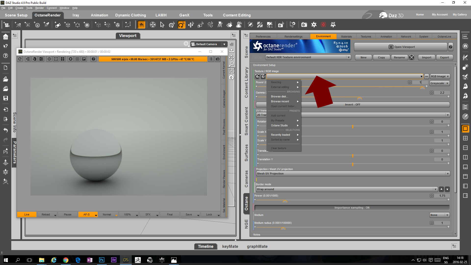

003 Click on the emtpy image selection bar:

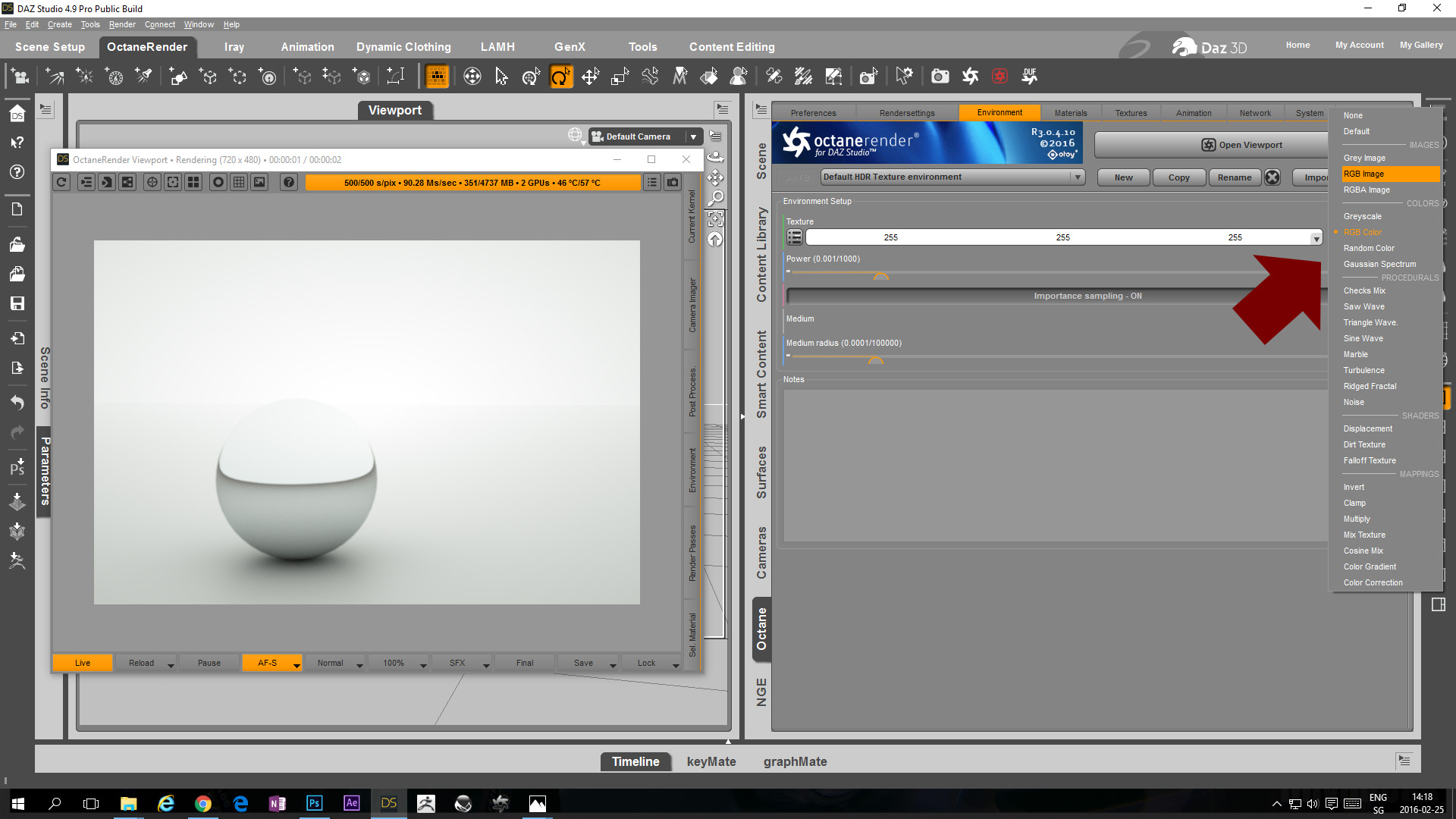

004 Select a HDRI preset from Octane Studio
005 Octane Studio 04 preset applied
edited: removed outdated path information

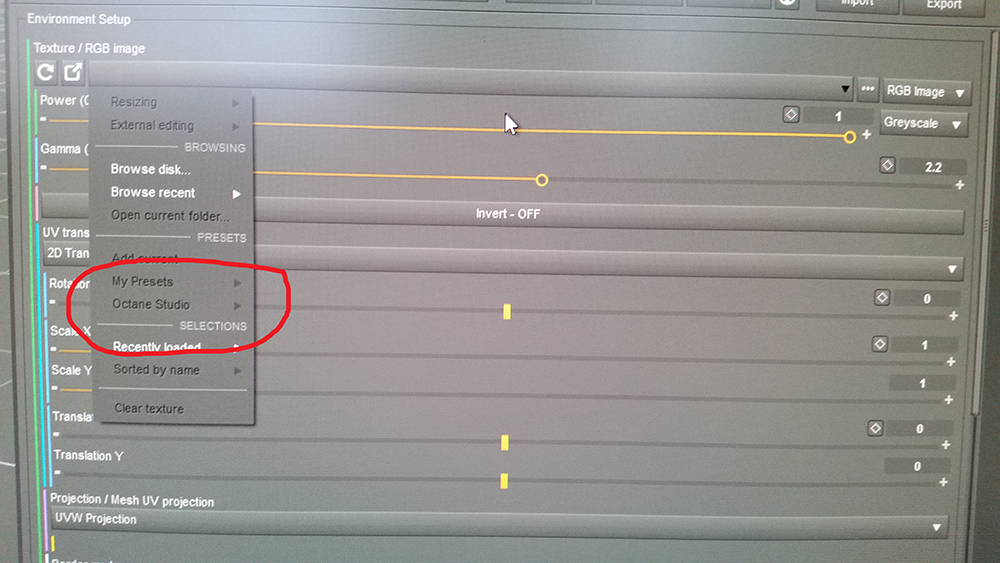

Mine is greyed out, see attached. Using latest of everything. And the files are there in the right folder.
Gateway i5 3.2ghz, 16g RAM, GTX 690 4GB VRAM, Windows 10 64bit, Poser Pro 11, DAZ Studio Pro 4.9, Daz Octane Plugin V2, Poser Octane Plugin V2
face_off
Posts: 15812
Location: Adelaide, Australia
It appears the installer is putting the HDR images in the wrong folder (they should be in C:\Users\[username]\OctaneRender\Resources\HDR). Can you pls install the version at https://render.otoy.com/customerdownloa ... _Win64.exe an tell me if it resolves your problem?

Version 3 works. So I can install Version 2 back, and just make sure the HDR files are in the resource/HDR folder I guess. Off to work, will try later. Thanks fore your help.
