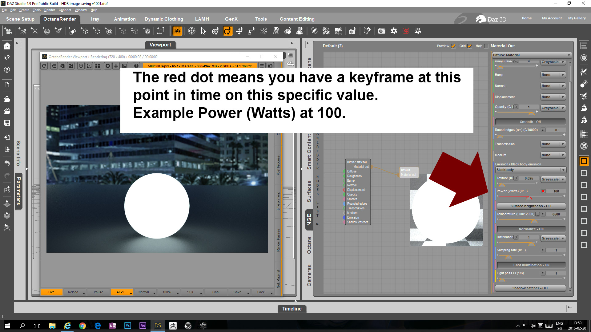

Now you can observe two things
+ the diamond shape square is now red
+ the parameter Power Watts has now a red line below

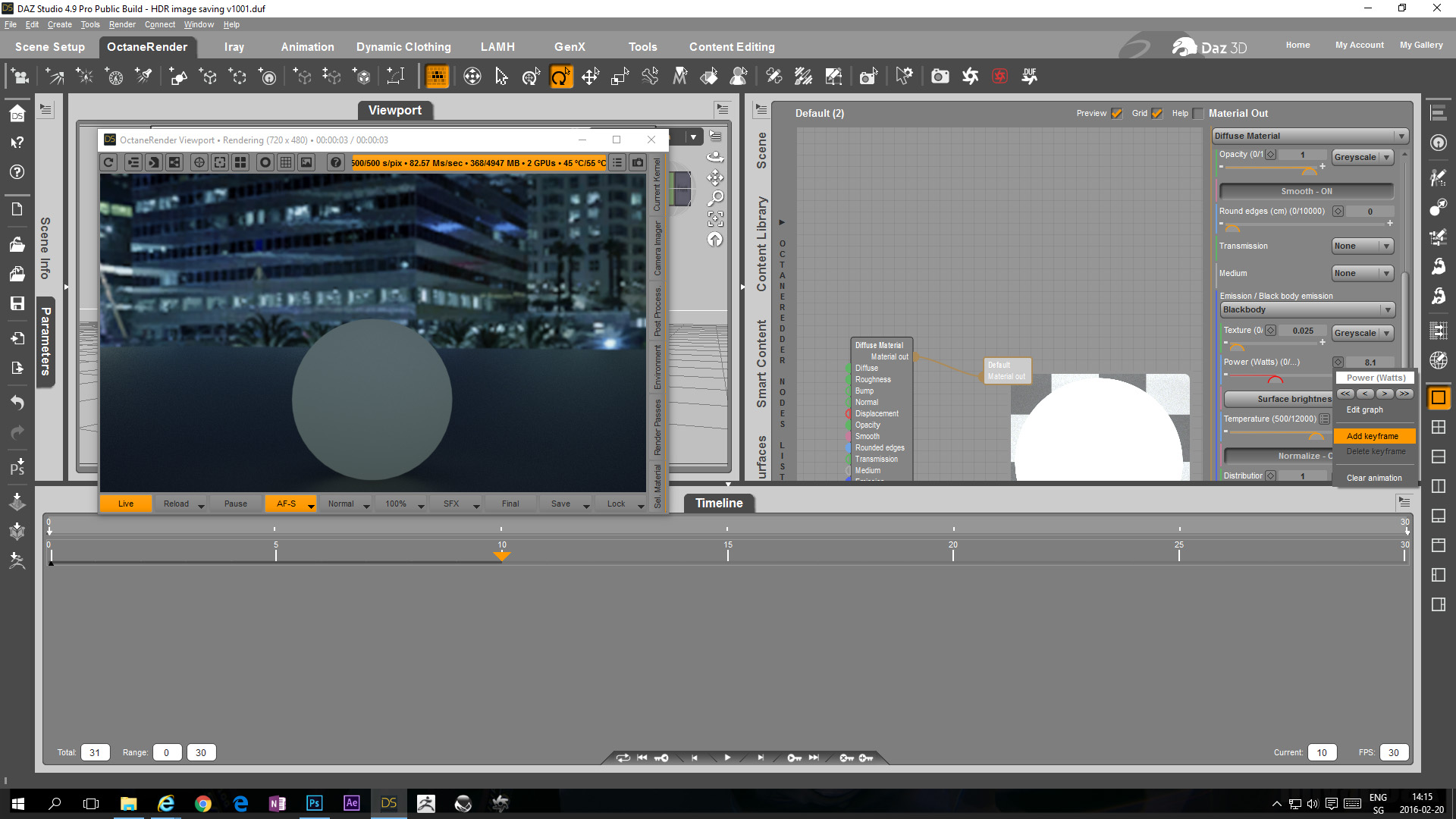

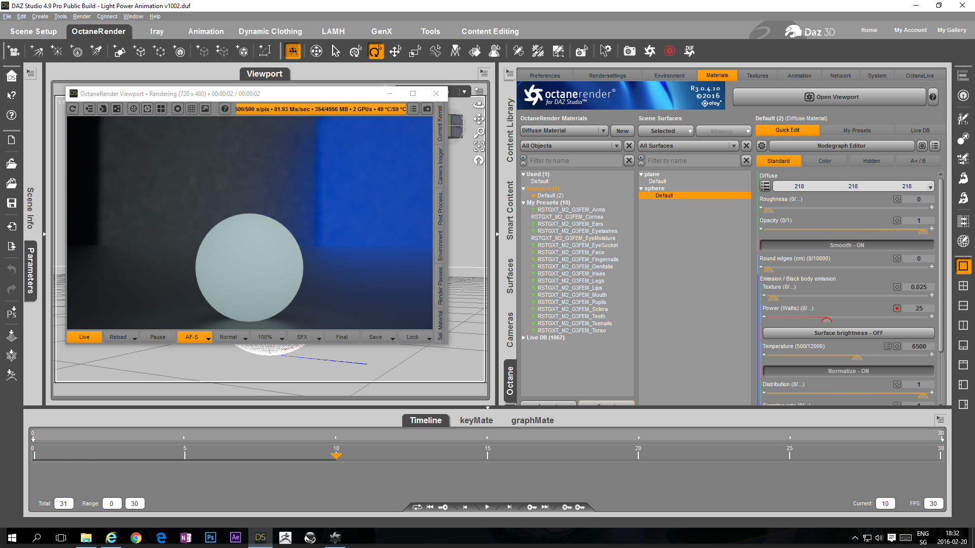

Now you want to place a 2nd keyframe with a different Power setting at 10 frames
- open the DAZ Studio timeline
- move the timeline to 10 frames
- adjust the Power to a lower value like 8.
- In the material settings search for the parameter Power (Watts) and click on the diamond shaped square
- select the option place keyframe
Now you have created two keyframes and you can move trough the DAZ Studio timeline to observe the effect.

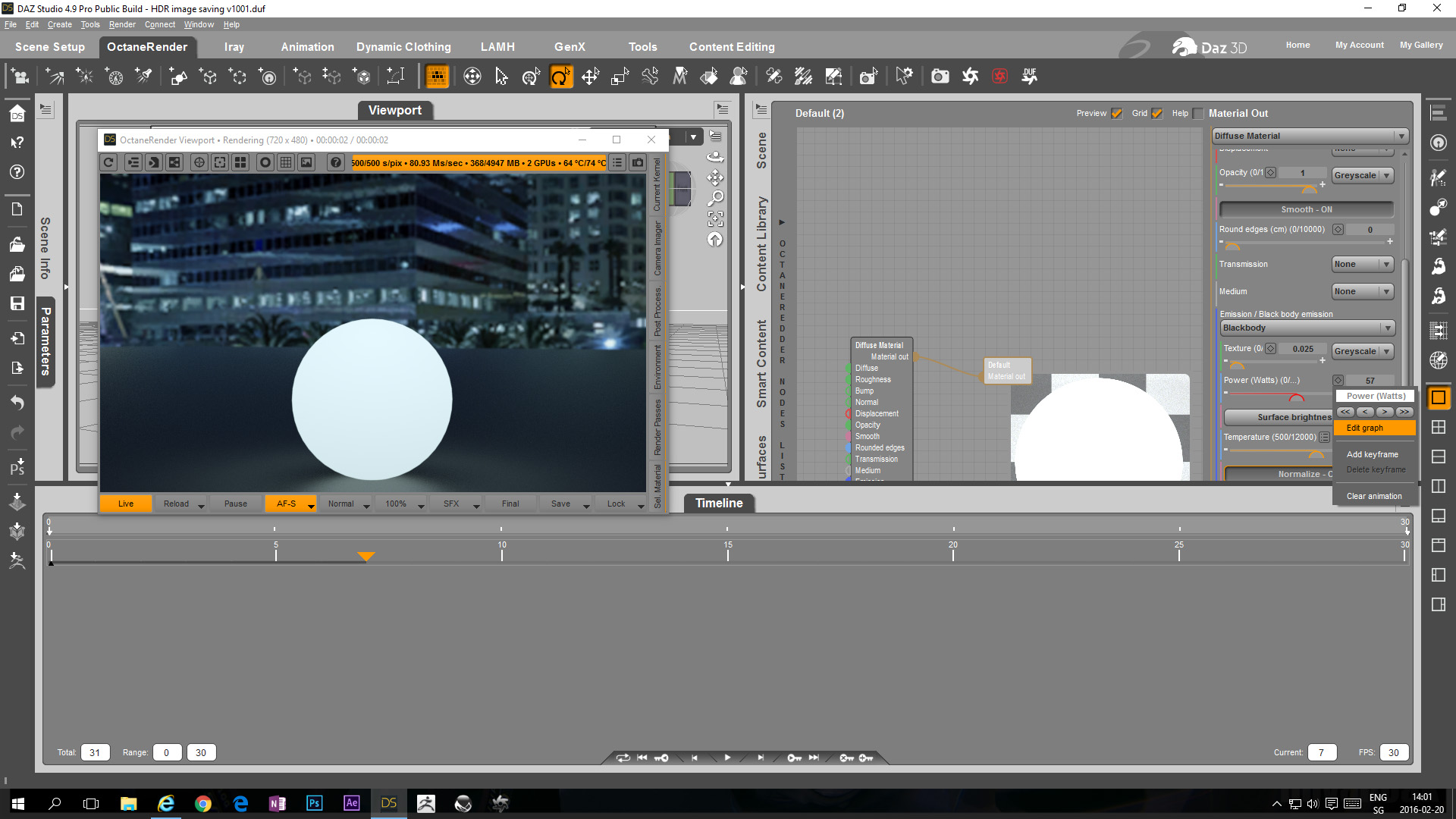

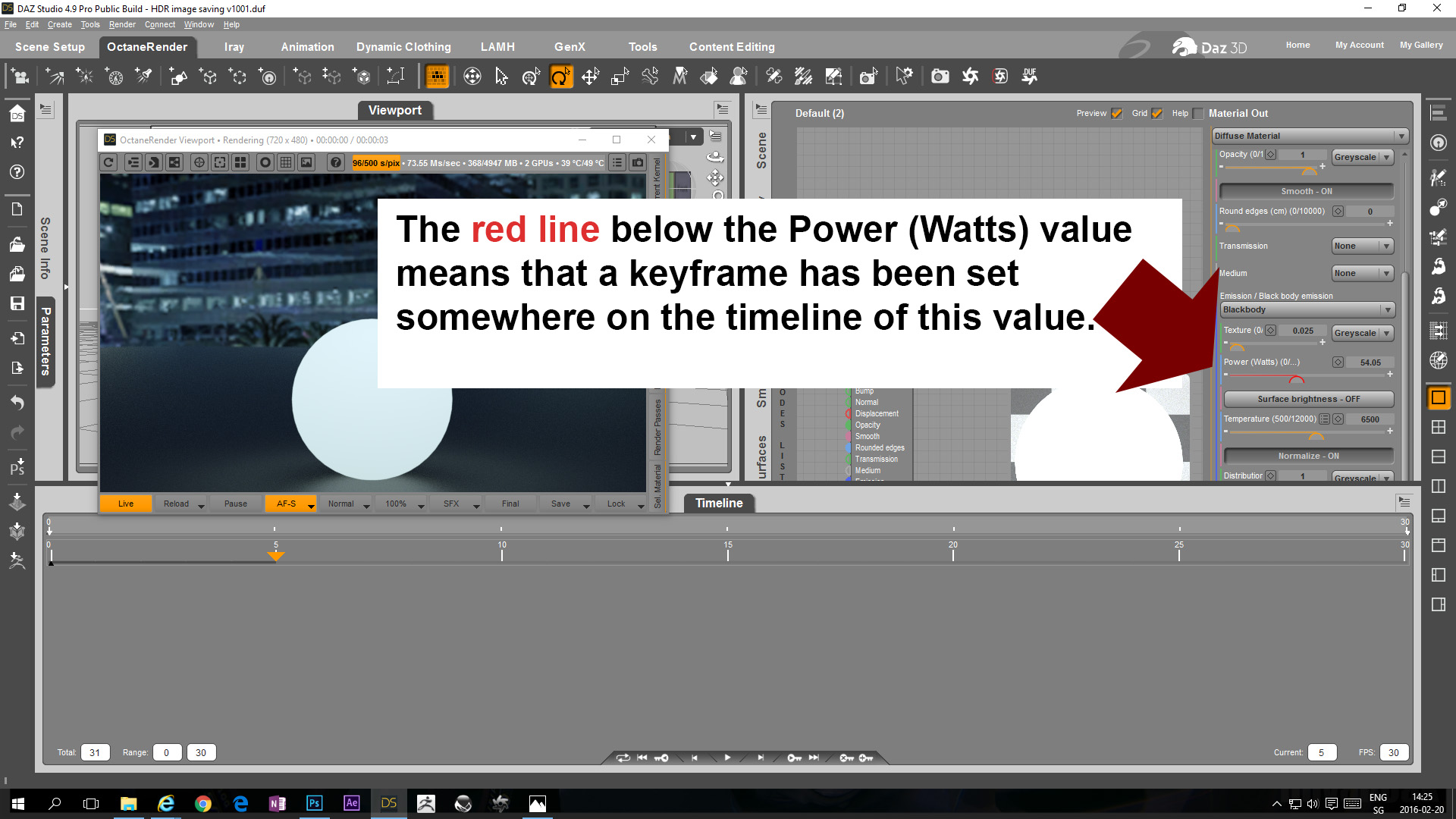

Nevertheless note that:
+ In the DAZ Studio timeline there is no indication at all that OcDS specific keyframes have been set
+ If you scroll the timeline to 5 frames the only indication that there is a keyframe set at some point in time is the red line below the power parameter.

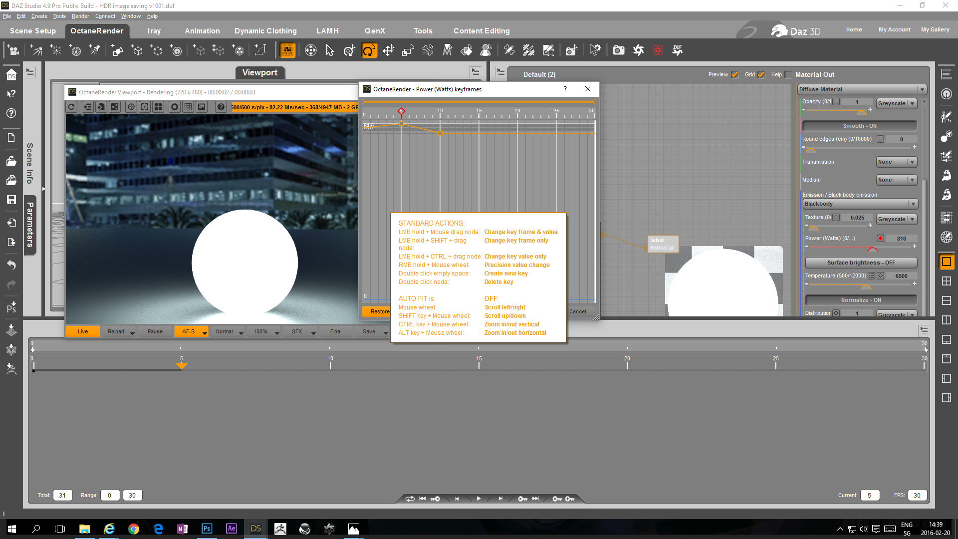

You can open a graph editor by clicking on the diamond shaped quare to see more information about the animated OcDS value.
That graph can also be used to perform some interactions.
- move existing keyframes
- adjust values of keyframes
- create new keyframes
- delete keyframes
If you are not familiar with the controls of that graph editor you can right click and use the help cursor to display a help menu:
Unfortunately it takes a while to get used to the controls and precise interactions with the graph controls do not always seem possible because of the scale of some parameters.
The range may be 0 to 100 but you may need to adjust from 0.01 to 0.05 etc.
Still the graph gives at least some kind of overview which kind of values are placed on a specific parameter.

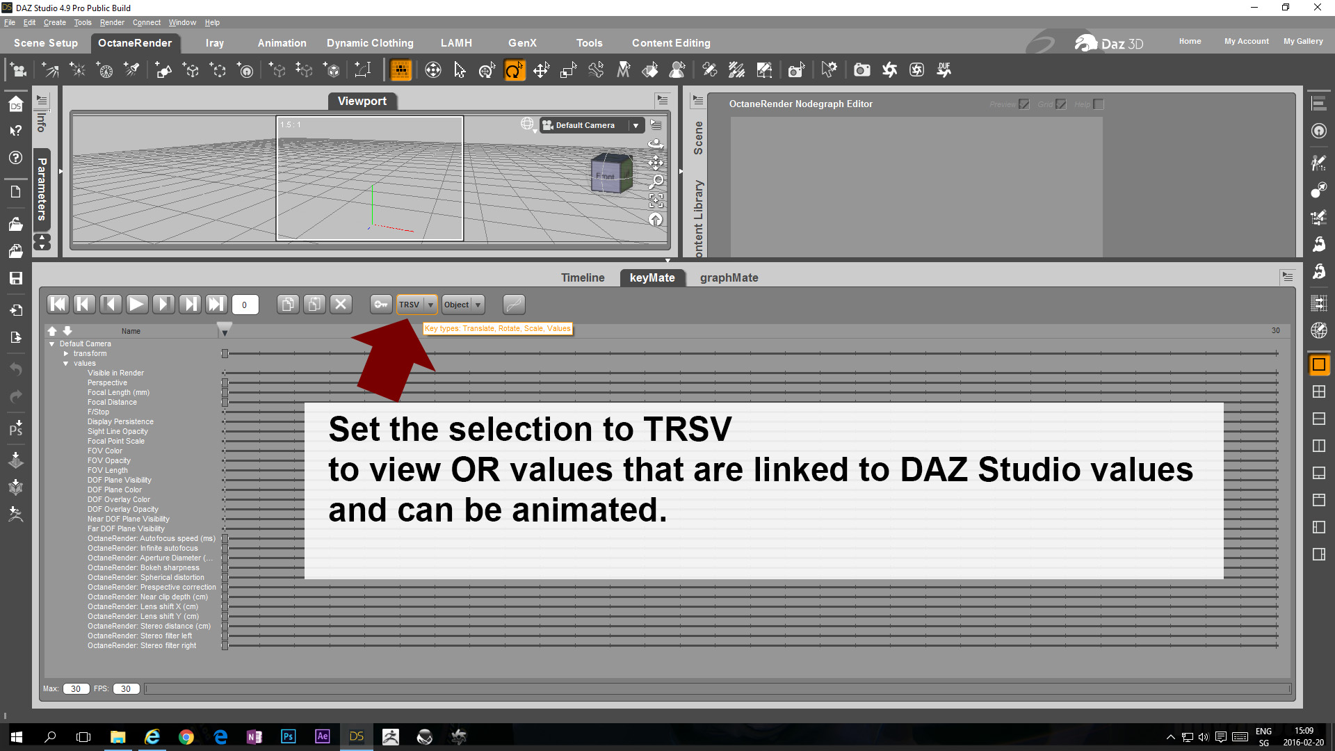

The exception to the rule:
OctaneRender camera values which are linked to DAZ Studio values CAN be animated in the DAZ Studio timeline.
If you own the keymate plugin you can make those values show up in the keymate timeline by activating
TRSV ( Translate, Rotate, Scale, Values)

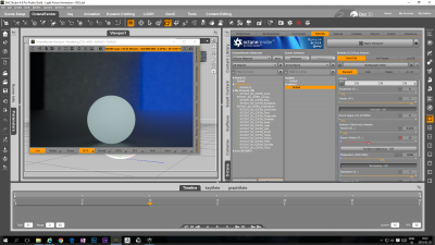

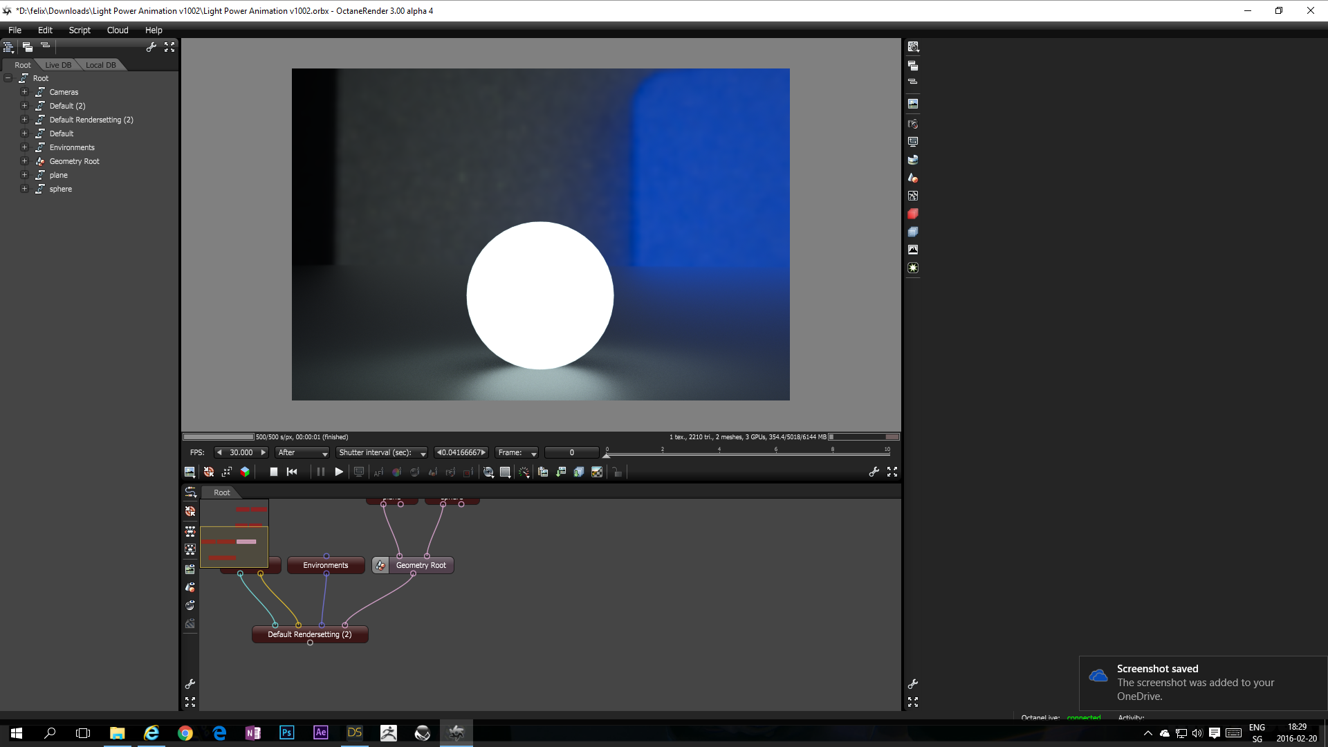

I was able to export that 10 frame light power animation as an .ORBX and open it in OctaneRender standalone.
Make sure that you set the proper FPS (frames per second) value in both OcDS and OR standalone.
Original 10 frame animation at 30 FPS in OcDS:

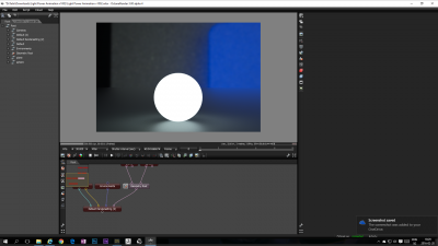

When first importing in OR standalone the settings are by default at 24 FPS and therefore the animation timeline shows only 8 frames:

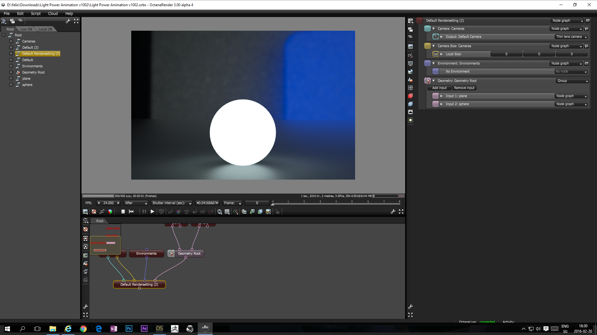

Updating to 30 FPS in the OR standalone settings shows the same 10 frame animation as in OcDS:
Test scene is attached:
