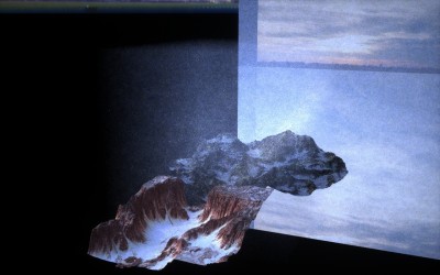

Thanks for the release Face_off. Rendering appears to be less resource intensive and everything is more responsive during rendering now. No longer need to dedicate GPUs for rendering like I use to.
Spot rendering or region rendering did not work for me though. It still renders the whole scene, however it reduces the samples like it is spot rendering.
Here are a few renders playing with volumetric fog
