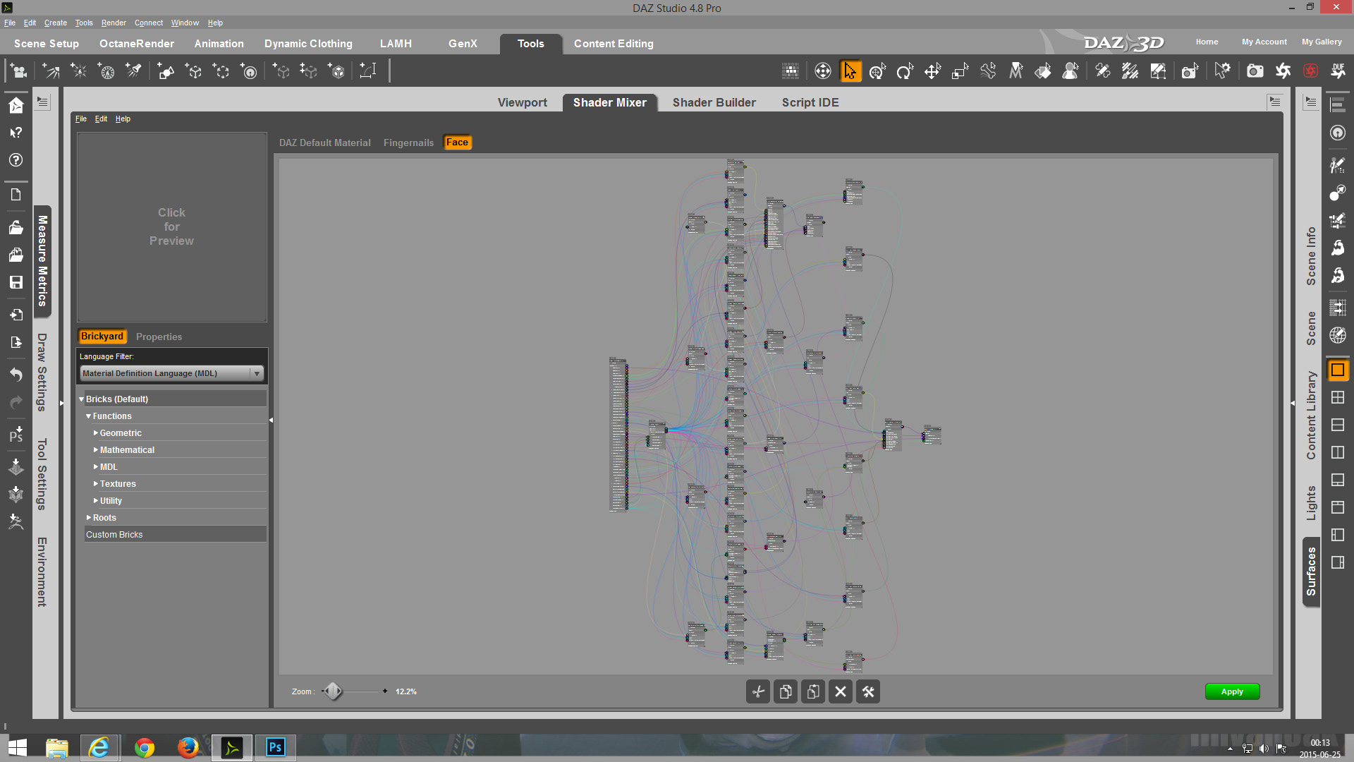

Have a look at this:
V7 Iray Head surface shader mixer layout.
While the standalone OctaneRender NGE does a great job of organizing all the countless nodes to a manageable group the DAZ Studio Shader mixer creates nodes for every little parameter without giving any advanced options to group and combine nodes in a reasonable time frame.

I agree completely with what you said about the node editor, I took one look at the IRay node tree and gave up immediately.
